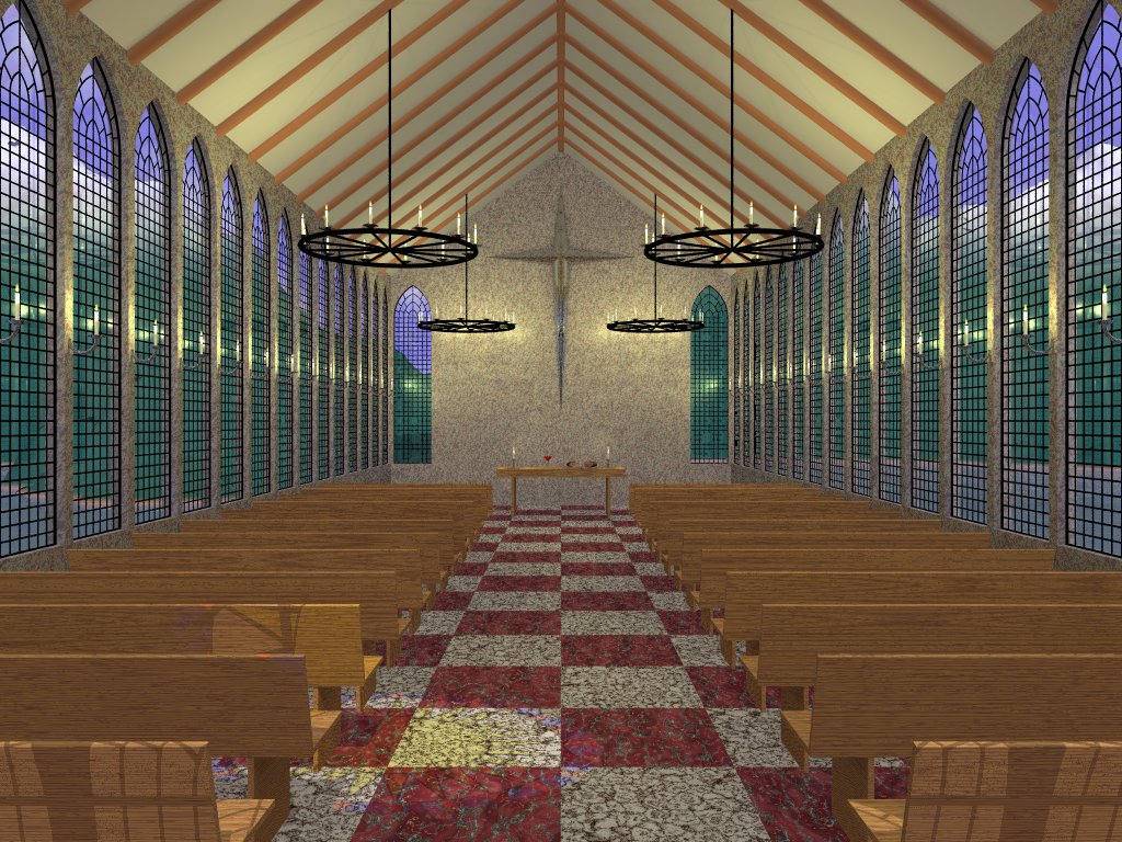

after getting a copy of 3.5 I updated the stone church I had done last
august. this one uses radiosity and a few changes in textures and
lighting. if anyone wants to see the source i will post it to
povray.binaries.scene-files
I would like to thank Peter Popov for his help with radiosity
the original render is here for comparison.
http://news.povray.org/povray.binaries.images/17512/
there are some artifact's in the windows that i don't understand. they
appear as either black spots or places where the window frame is
missing.  I have max_trace_level set to 10 but this didn't appear to
change anything.  any comments?
Richard

From: Ib Rasmussen
Subject: Re: Stone Church 2
Date: 30 Aug 2002 07:53:52
Message: <3D6F5CB5.1050609@ibras.dk>
I hate to tell you, but I like the original better. I think the lighting
is too uniform in the new one.
Could it be the anti-alias settings? Have you tried increasing the
Antialias_Depth? I use +R6 to get fine details rendered.
/Ib
From: rmorehouse
Date: 30 Aug 2002 08:30:05
Message: <web.3d6f611ac50a56e7186aded30@news.povray.org>
>/Ib
I still have a lot to learn about lighting so i will probably change it
several times.
would I need to recompute the radiosity data to rerender the scene if I
change the Antialias_Depth? how would changing this affect render time?
Richard
From: Ib Rasmussen
Date: 30 Aug 2002 09:08:17
Message: <3D6F6E26.503@ibras.dk>
I'm not the right one to answer that, but I wouldn't think so.
I think it is a safe bet to say that it would increase :-) By how much
is harder to say. It would also depend on how much of the image, that is
actually antialiased, which depends on the threshold.
If it gets really bad, perhaps you can get away with rendering only the
problem area at increased aa-depth, and graft it into the full image
rendered at your usual settings.
/Ib
From: Jaime Vives Piqueres
Date: 30 Aug 2002 09:12:52
Message: <3d6f6f54@news.povray.org>
  No, if you saved the rad file. As long as you mantain the geometry and
camera position, you can change almost anything...
  Let me guess... increasing it? ...a lot? :)
http://www.ignorancia.org
From: Tom Melly
Date: 30 Aug 2002 09:13:40
Message: <3d6f6f84$1@news.povray.org>
"Richard Morehouse" <rmo### [at] coxnet> wrote in message
news:54iumusjjrl7c270bdaa9lb5flqa4jfqun@4ax.com...
I can't see the black spots (although, given you seem to have ruled out a
max_trace problem, they sound like they might be a co-incident surface problem).
The gaps look as though the line is too thin - try rendering a small area where
the problem shows up at a higher resolution and see if the lines re-appear.
From: rmorehouse
Date: 30 Aug 2002 09:35:07
Message: <web.3d6f73a8c50a56e7186aded30@news.povray.org>
>news:54iumusjjrl7c270bdaa9lb5flqa4jfqun[at]4ax.com...
thanks Tom
i'll try that
Richard

From: Aaron Gillies
Date: 30 Aug 2002 10:44:48
Message: <3d6f84e0$1@news.povray.org>
Nice ...
It strikes me that you might want to reserve some of
the busier textures for objects in the scene that you want
to attract the viewer's eye.  Maybe the floor should
just be gently-mottled squares of gray and red?  That
way, we would be able to see the light from the
stained glass where it hits the floor. :)
Aaron

From:
Date: 30 Aug 2002 11:57:07
Message: <3d6f95d3$1@news.povray.org>
something just seems off to me... and I think it's the fact that the walls
don't seem to be able to support the roof... there just seems to be too
little space in between the windows
beware though, IANAA(rchitect) so maybe I'm all wrong...
