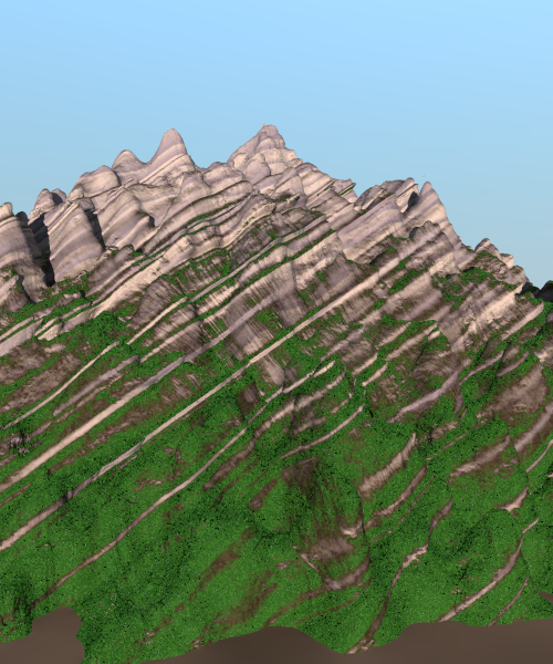

I am experimenting with isosurfaces to make rock landscapes, using as a
basis my arcane Geomorph macro of several years ago.
I am fairly satisfied with the rocks, but I have difficulties with the
texture. I use a slope/altitude texture where I would like the grass to
show on the /upper/ sides of rock ridges and not on the /underside/ as
it does now. I tried different settings but to no avail. This is the
code I use for the shown image:
texture {
   slope {
     <0.0, 0.3, 0.0> , 0.0 , 0.5
     altitude <0, 1-0.3, 0.0> , LowerBound , UpperBound
   texture_map {
     [0.60 Grass]
     [0.65 Soil]
     [0.80 Rocks]
Any idea how I could achieve what I want? The difficulty imo resides
with the use of isosurfaces which have overhangs. A height_field would
be easier in this case.
Download 'elements of geology5_03c.png' (432 KB)
Preview of image 'elements of geology5_03c.png'

Reading:
http://www.povray.org/documentation/view/3.6.1/393/
<0,0.3,0> is the direction of reference, so rather something like +y
Beware, going to -y evaluates to Low (here 0), and
going +y evaluates to High (here 0.5) (and horizontal x or z evaluates
to middle value (here 0.25) (but it's not linear, arcsinus is used, or
rather it's linear for the angle but not the projection)
Altitude add a gradient. here parallel to +y too.
At LowerBound, the value is 0, and 1 at UpperBound.
The value of slope and the value of altitude get merged using the
relative length of each vector (otherwise irrelevant). And it is *not* a
linear interpolation (but the final value is wrapped to be modulo 1.0),
it's just a basic weighted addition. (the slope value is [0,1), but the
altitude value can be out of range if LowerBound & UpperBound are too small)
So, let's assume +y is the normal where you want some grass to show.
slope { abs(L1)*y, 1, 0 // keep full range, inverted
// (y->0, vertical->0.5, overhang (surplomb)->1.0)
       altitude abs(L2)*y, LowerBound, UpperBound (
 texture_map{
  [0.25 Grass] // flat & small slope are full of grass
  [0.45 Soil] // a slope without any grass
  [0.5 Rocks] // a vertical surface is rock, and so is overhanging
you can then adjust the weight of L1 & L2. (nevertheless, L2 will
generate grass everywhere at LowerBound despite the normal, so better
have LowerBound far out of scope (or you might want to compress the
texture_map to 0.125/0.225/0.25 or further, to reduce the influence of
altitude LowerBound.
Assuming a ground at 0 and Upperbound at 100m, LowerBound might be
interesting at -100 or -200... (in function of the texture_map's
compression), with L2 about 0.01 or less; L1 can probably be 0.99 or a
bit less
(if Lowerbound & Upperbound are from the iso, maybe the Lowerbound value
in altitude should be replaced with Lowerbound - (Upperbound -
Lowerbound)*Factor )

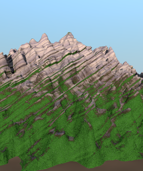

Subject: Re: Isosurface rocks and slope texture
Date: 4 Jul 2013 03:04:18
Message: <51d51e72@news.povray.org>
OK. This goes a bit too far for my simple understanding ;-)
As far as I can tell, the pattern seems not to be bugged, but that is
for specialists to confirm. I have always used it to full satisfaction
and complete agreement with the the documentation. However, isosurfaces
being a bit more complex than height_fields, the tuning of the
parameters is a bit more complex too.
I finally arrived at a correct render by using a negative direction of
slope. I don't know why in earlier tests I did not get it right,

On 4-7-2013 0:35, Le_Forgeron wrote:
> Le 03/07/2013 16:19, Thomas de Groot nous fit lire :
>> Yes. Note that the documentation says the use 0.0, 0.5 for Lo_slope and
>> Hi_slope permits the texture_map to be used from 0 to 1.
> the default 'slope { <vector> }' is already in [0;1)
> when used with 'slope { <vector>, Low, High }', I'm afraid it's bugged,
> or I did not understood the text correctly.
> 1. parser transforms Low & High in Low, Range
> 2. pattern transforms value to (value-Low)/Range
> (original value is the angle in 0--1 : 0 is the opposite of the vector's
> direction, 1 is the same direction as the vector)
> 0 become -Low/Range
> 1 become (1-Low)/Range
> and then the usual modulo 1.0 is applied (unless altitude is present).
> So, ... 0.0 , 0.5 would transform 0 in 0, and 1 in 2. The 0, 0.5 give
> full range for *heighfield* (only) because there is no overhangs on
> heightfield. (but there is for isosurface, so better stay away from Low,
> High)
> I was hoping to have grass at the low part of map, but maybe you should
> reconsider and it might be easier to have grass near 1, and rock at 0.
> (and with altitude weighted as 1/4 (and slope at 3/4), the grass/soil
> might start at 0.6... but once again, I feel that Lower & Upper might be
> bugged, or not ? :
> 1. parser transforms Lower & Upper in Lower, Range
> 2. pattern transforms value to (value - Lower)/Range
> (original value is the oriented length of the projection of the point
> coordinate on the *normalised* vector of altitude (from origin)(yep,
> length of altitude is irrelevant, excepted for weight with slope)
Date: 4 Jul 2013 03:56:07
Message: <51d52a97@news.povray.org>
I promised an image, here it is.
Used the following pattern code:
texture {
   slope {
     <0.0, -0.3, 0.0> , 0.0 , 0.5
     altitude <0, 0.7, 0.0> , LowerBound-5 , UpperBound
   texture_map {
     [0.60 Grass]
     [0.65 Soil or weathering if you want]
     [0.80 Rock]
Note that - as suggested by Le_Forgeron - I lowered Lo_alt a bit more
than the lower boundary of the bounding_box of the isosurface. Playing
with that setting gives indeed more interesting possibilities.
Download 'elements of geology5_04.png' (454 KB)
Preview of image 'elements of geology5_04.png'
