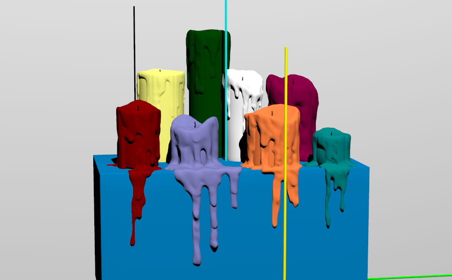

On 05/28/2013 05:11 AM, James Holsenback wrote:
> it /seems/ to be with how the object was built.
well now i'm not so sure about that anymore ... curious i did some
slightly more than casual tests. i'm starting to think it's how poseray
is exporting or how povray is parsing. the images are appropriately
output from poseray.

From: Stephen
Subject: Re: Continuing Blender-PovRay discussion
Date: 28 May 2013 09:03:00
Message: <51a4ab04$1@news.povray.org>
It's not something silly like PoseRay's default export handiness is
Right handiness?
I generally only export the geometry and change the handiness to Left
handiness (PovRay default).
Regards
     Stephen
From: James Holsenback
Date: 28 May 2013 09:39:59
Message: <51a4b3af$1@news.povray.org>
> Right handiness?
nope ... on the input tab reorient 3ds and dfx models is checked if
that's what you're talking about. i do however see flip options in
groups tab
From: Stephen
Date: 28 May 2013 10:01:22
Message: <51a4b8b2@news.povray.org>
On 28/05/2013 2:39 PM, James Holsenback wrote:
> i do however see flip options in groups tab
No, it is in the PovRay Output tab.
World axis orientation, again PoseRay scene (Right handiness)
I use PoseRay 3.12.2 as that is the highest version that Bishop3D will
import.
Regards
     Stephen
Date: 28 May 2013 10:11:45
Message: <51a4bb21$1@news.povray.org>
> groups tab
Yep. Typically a world orientation choice in Poseray's POV-Ray Output,
like Stephen said, right-handed vs left-handed. Same in latest versions
of Poseray.
Date: 28 May 2013 10:28:54
Message: <51a4bf26@news.povray.org>
> import.
well hell .. give the man a cheroot
