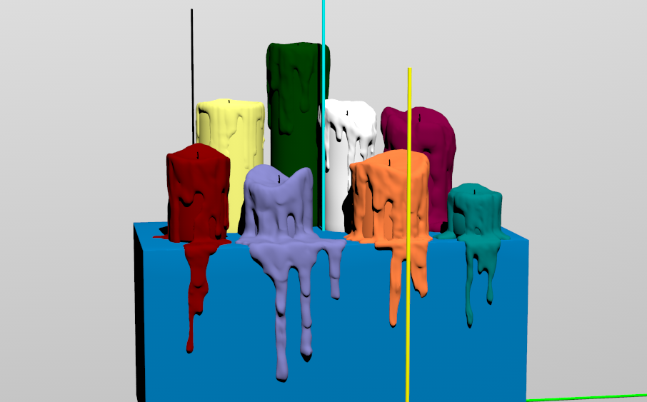

> If I export a mesh as 3ds then import it, some objects are displaced.
it /seems/ to be with how the object was built. now i'm speaking in pov.
-z behind, -x left +x right.
example: my current project 8 melted candles on a box, wax dripping down
over the edge.  the candles are roughly in two rows and the x position
is flipped: instead of 1-2-3-4 i get 2-1-4-3. i took each of the candles
(and wicks) cleared rotation, location, scale and origin, then properly
built the object centered at 0,0,0 the placed them in the scene. setting
of the origin seems key. now i'm able to select the wick of each candle
then snap 3d cursor to the wick for /proper/ location information,
because in povray i'm going to place a media/light source flame on each
candle.
well now i'm not so sure about that anymore ... curious i did some
slightly more than casual tests. i'm starting to think it's how poseray
is exporting or how povray is parsing. the images are appropriately
output from poseray.
