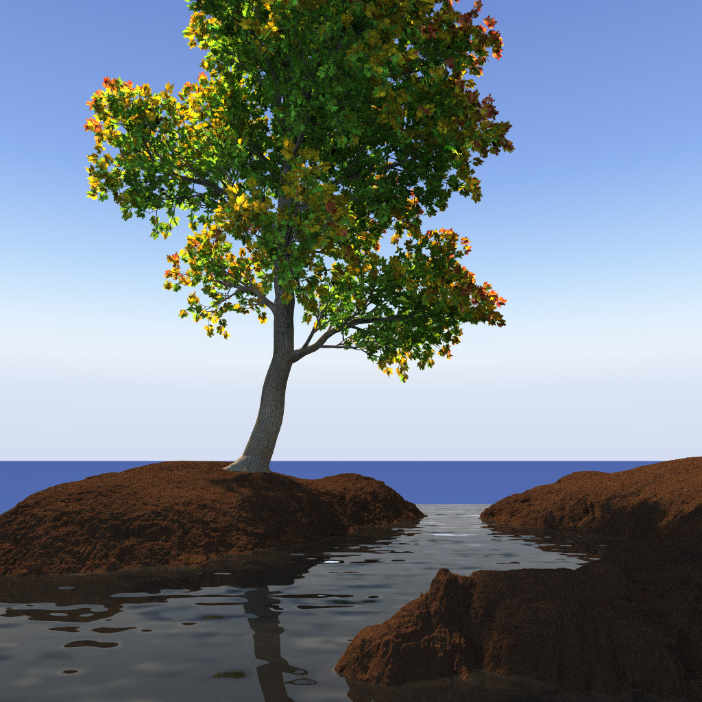

In between projects, time to experiment with a couple of things.
In March 2012, Norbert Kern explained how to make believable fall trees:
http://news.povray.org/povray.binaries.images/thread/%3Cweb.4f624250b5209546dc4ffc880@news.povray.org%3E/
Not using megapov, I took some of his suggestions and worked instead on
POVtree meshes, using a spherical texture to simulate the fall colours.
The present image (in my tree testing environment) is a credible result
I guess.
The use of this texture needs some careful tweaking in terms of scale
and translation, and also a strong warp turbulence to make a more random
distribution.
The following code is used, with the POVtree terminology:

Download 'povtree_test.png' (206 KB)
Preview of image 'povtree_test.png'

Thanks Michael! Yellow leaves should not be too difficult in the present
configuration: just an intermediate pigment between green and red, and
some more tweaking on the texture_map. I have only explored a little of
the uv-mapping part of POVtree and that is where I want to try this
technique out too, one way or another. For instanc,e I was thinking
about layering the colours over the leaf image_maps, although that might
give unexpected results.
I am not too familiar with arbaro although it is gathering dust
somewhere on my HD ;-) For each application the approach might be different.

Something like this.

Sorry for answering a little bit late, but I'm heavily occupied by RL issues at
the moment (and will be till the end of the year - as every year). Yes,
something like this (to cite Kevin Kline in "A Fish called Wanda"). It's fine. I
hope to find time next year to have some experiments with this
scaling-turbulence trick.

That's all right. I have continued my investigations a bit:
Problem: POVtree does not export to mesh{} with uv-mapped leaves. There
is a bug in the program. A pity Gena disappeared from the web. :-( so my
idea to experiment with that comes to naught.
I am looking into Arbaro right now.

Yes, this is looking quite perfect to me.
I have not yet found a good way (for me) to tackle the uv-mapped
image_map leaves.I am investigating.
