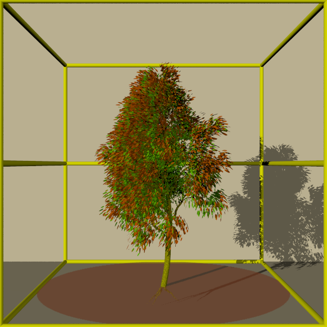

In between projects, time to experiment with a couple of things.
In March 2012, Norbert Kern explained how to make believable fall trees:
http://news.povray.org/povray.binaries.images/thread/%3Cweb.4f624250b5209546dc4ffc880@news.povray.org%3E/
Not using megapov, I took some of his suggestions and worked instead on
POVtree meshes, using a spherical texture to simulate the fall colours.
The present image (in my tree testing environment) is a credible result
I guess.
The use of this texture needs some careful tweaking in terms of scale
and translation, and also a strong warp turbulence to make a more random
distribution.
The following code is used, with the POVtree terminology:
//start code
#declare LAUB =
texture {
   spherical
   texture_map {
     [0.45 BOZO1]
     [0.55 BOZO2]
   scale 1015.11115	//scale according to POVtree output
   scale 1/50
   warp {turbulence 10}	//change according to need
   scale 50
   scale <0.5, 1, 0.5>*1	//change according to need
   translate 250.0*y	//change according to need and/or POVtree scale above
//end code

Wonderful work. My first idea of a slight improvement is to have some yellowish
leafs between the green and the brown ones, since most green leafs are turning
yellow before turning red or brown. But this remark should not belittle your
approach, it's wonderful. During my daily travels by train to work and back I
had to pass some woods and pondered this issue again and again and ever thought
to break down the arbaro meshes in leaf groups to achieve this. Your approach is
much more simple and seems to work fine.

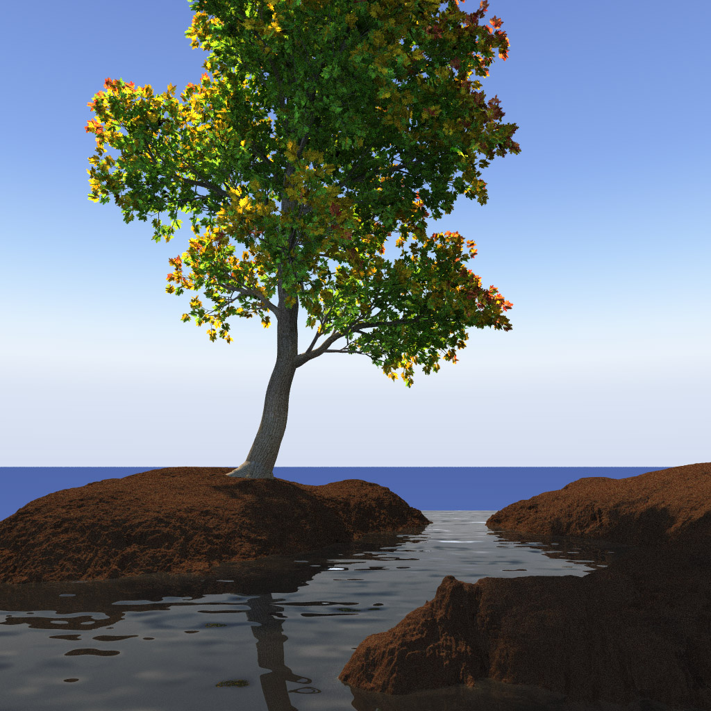

Thanks Michael! Yellow leaves should not be too difficult in the present
configuration: just an intermediate pigment between green and red, and
some more tweaking on the texture_map. I have only explored a little of
the uv-mapping part of POVtree and that is where I want to try this
technique out too, one way or another. For instanc,e I was thinking
about layering the colours over the leaf image_maps, although that might
give unexpected results.

Something like this.
Download 'povtree_test.png' (206 KB)
Preview of image 'povtree_test.png'
