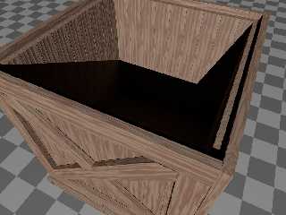

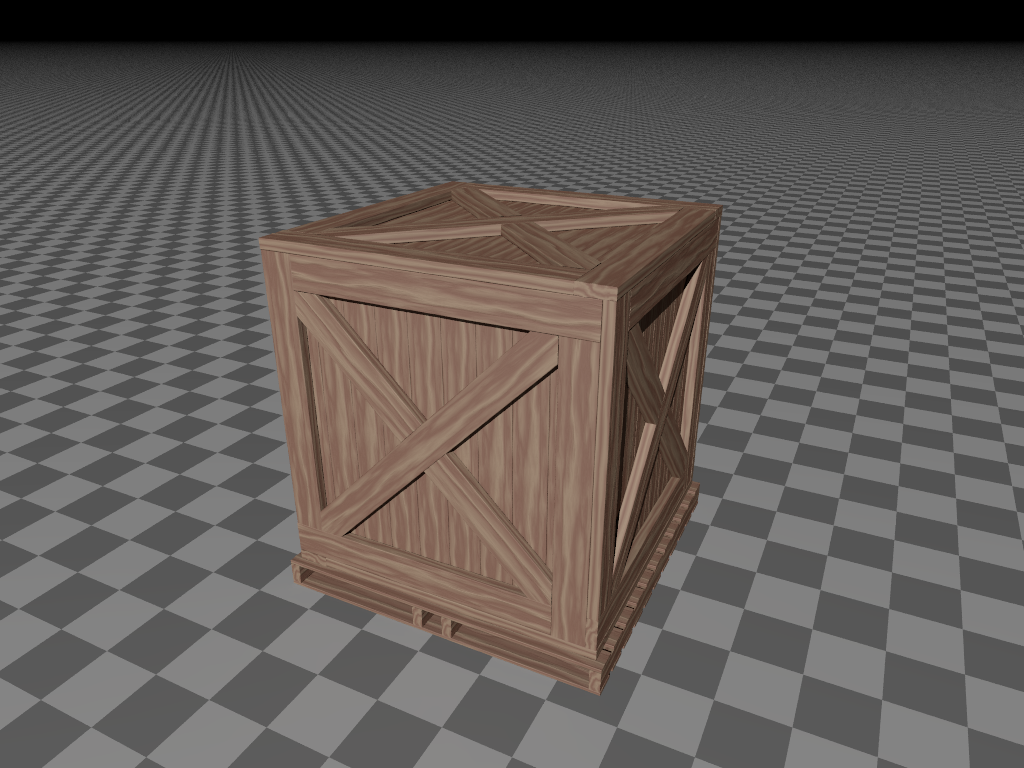

I was hoping to do some more texture work with this before showing it
off, but it appears that I will not be able to texture it further
without de-constructing it and applying the same texture over and over
again to selected pieces... -.-
Which somewhat defeats the purpose.
I have some ideas - though little hope, at the moment - for developing a
"spray-paint" macro to do lettering and stenciling, but considering that
it would likely require millions of microscopic particles to make it
look good, I'm not very optimistic.
Further discussion of the difficulties is in p.general
Comments and suggestions are, as usual, quite welcome.
A.D.B.
Download 'crate5.png' (488 KB) Download 'crate4.png' (794 KB)
Preview of image 'crate5.png'
Preview of image 'crate4.png'
Except for the overlay problem discussed in p.general, you might
consider adding some randomness (random translation would be enough I
guess) to the wood texture of the individual planks of the box, in order
to avoid repetition of the pattern.

been attempting to do that, not having a lot of success.
The boards are made from an isosurface that uses the function:
f_rounded_box(x,y,z,0.125, W/2-0.03125*OldWood(x-_X,y-_Y,z-_Z).x,
T/2-0.078125*OldWood(x-_X,y-_Y,z-_Z), L/2+0.25)
Where W, T and L are Width, Thickness and Length and _X, _Y, and _Z are supposed
to be random translations, but I don't think that they're getting re-calculated
every time the macro is called, or if they are, they're always the same.
A.D.B.
> are supposed to be random translations, but I don't think that
> they're getting re-calculated every time the macro is called, or if
   But there you are translating the isosurface function, not the texture
later applied to it: you need to translate it independently.
   BTW, after seeing at last the "problem object", I think it has an easy
solution, as long the base the texture is the same for all: just lay the
"global" texture at each sub-object:
union{
   object{board1
     texture{t_wood
       // local transforms here
     texture{t_dirt}
   object{board2
     texture{t_wood
     texture{t_dirt}
Jaime
Exactly.
> union{
>    object{board1
>      texture{t_wood
>      texture{t_dirt}
>    object{board2
>      texture{t_wood
>      texture{t_dirt}
And of course, the randomness of the pattern is easy to include in this
union{
    object{board1
      texture{t_wood
        // local random translate here
      texture{t_dirt}
    object{board2
      texture{t_wood
      texture{t_dirt}
Note that if you use this for the horizontal and diagonal boards, you
may have to counter-rotate the dirt texture by the same amount, in order
to get a correct (?) image.

I have been translating the texture.  It's still not having an effect because _X
_Y and _Z are always the same...  I'll post the source next time I'm at my
computer.
As for your texture solution:  It might work if dirt was all I was working
with.  But I also want to add serial numbers, company logos and handling
instructions like "this end up" or "fragile" etc...
Added to individual elements, the texture would need to be translated precisely
for each element such that adjacent elements matched up.  It's tedious to even
automate something like that.  Assuming it can be done in the first place.
And it makes the object extremely wasteful in terms of memory, if I need a lot
if them.
Of course,  my spray-paint method might not be any better, and could be much
worse.
A.D.B.
>> Exactly.
>>> union{
>>>     object{board1
>>>       texture{t_wood
>>>       texture{t_dirt}
>>>     object{board2
>>>       texture{t_wood
>>>       texture{t_dirt}
>> union{
>>      object{board1
>>        texture{t_wood
>>        texture{t_dirt}
>>      object{board2
>>        texture{t_wood
>>        texture{t_dirt}
> computer.
Hmmm... You need to make a randomness macro, which is called each time a
texture is applied (not tested):
#local R = seed(123);
#macro RandTrans(R)
   translate rand(R)
#end
which would be used as follows:
         texture{t_wood
           RandTrans
Yes, that makes it difficult indeed... I have to ponder this a bit more...
> >> Exactly.
> >>> union{
> >>>     object{board1
> >>>       texture{t_wood
> >>>       texture{t_dirt}
> >>>     object{board2
> >>>       texture{t_wood
> >>>       texture{t_dirt}
> >> union{
> >>      object{board1
> >>        texture{t_wood
> >>        texture{t_dirt}
> >>      object{board2
> >>        texture{t_wood
> >>        texture{t_dirt}
> > computer.
> #macro RandTrans(R)
>    translate rand(R)
> #end
>          texture{t_wood
>            RandTrans
> Thomas
personally, I think it would be best if the textures on a given object were
sampled in reverse-order, with the last being sampled first.  you could stop
when you encounter a texture with no transparency and warn if there are textures
that aren't sampled.
A.D.B.

For the parallel planks forming each faces, did you look at using warp
with repeat? Add some flip and offset to effectively break the
repetition. Also, you can layer a few textures each having different
flip patterns and offsets. I've done it and it works great. That way, it
would be easy to apply some staining or marking as an additional top layer.
It only leave the diagonals, horizontals and some corner vertical pieces
to be textured individualy.
