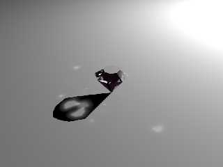

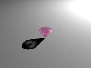

After /still/ having problems my amethyst ring I decided to isolate just
the stone and I think I've uncovered another bug. It appears that
filtered transparency isn't working with photons.
In the first image you can see the photons when I have srgbt <0.4980,
0.2902, 0.4235,1> in the material definition, and the second image the
photons aren't showing up when I have srgbf <0.4980, 0.2902, 0.4235,1>
in the material definition: that is the ONLY difference is srgbt then srgbf
The scene file is posted in p.b.scene-files

That's a negative. Here's an enhanced version of your image, showing
that photons /are/ at work.
Try using solely fade interior for the color; it's more realistic anyway.
Download 'p_test2_enhanced.png' (36 KB)
Preview of image 'p_test2_enhanced.png'

>        finish {
>          ambient 0  emission 0  diffuse 0
>          reflection {0 1 fresnel on} conserve_energy
>      interior {
>        ior IOR
>        fade_power 1001
>        fade_distance FadeDist
>        fade_power rgb < pow(Color.red,3),
>                         pow(Color.green,3)
>                         pow(Color.blue,3) >
> #end
> Note that I do usually use 1cm = 1 POV-Unit and in this case
> fade_distance 1 works pretty well. You have scaled your gem much
> bigger so you have to adjust fade_distance to fit your scale.
> Attached is a quick lo-quality (90 seconds) preview render - not a
> spectral one - featuring your stone: from left to right emerald,
> sapphire and amethyst.
> -Ive
Wow ... thanks for the macro and all the advise. I really appreciate it!
From: Ive
Subject: Re: Another Photon Bug?
Date: 24 Sep 2012 00:21:28
Message: <505fdfc8@news.povray.org>
Am 24.09.2012 02:24, schrieb James Holsenback:
> Yes it left a visible line shadow on the ground plane ... thought merge
> would have gotten rid of coincident surface ( where the two cones met
> before difference ) but obviously not ... hmmm
Well, merge gets rid of *internal* surfaces but in this case, depending
on viewing angle and floating point inaccuracy, it is not clear if a ray
has left one surface and then enters the other or if the objects
actually get merged.
>> #macro M_Gem (Color, IOR, FadeDist)
>>    material {
>>      texture {
>>        pigment {rgb Color filter 1}
>>        finish {
>>      interior {
>>        ior IOR
>>        fade_power 1001
>>                         pow(Color.green,3)
>>                         pow(Color.blue,3) >
>> #end
Err, sorry, this was out of my head and has the usual bugs. It should be
like this:
    material {
      texture {
        pigment {Color filter 1}
        finish {
      interior {
        ior IOR
        fade_power 1001
        fade_color rgb < pow(Color.red,3),
                         pow(Color.green,3)
                         pow(Color.blue,3) >
#end
Hopefully this time I've got it right ;)
And BTW the rgb (not srgb !!! because the power of 3 would give wrong
results) values I did use for the picture are
Emerald:  rgb < 0.7276, 0.9320, 0.8543>
Sapphire: rgb <-0.0044, 0.3702, 0.7609>
Amethyst: rgb < 0.8981, 0.8441, 0.8972>
and are calculated from the absorption spectral data. And yes, the red
components for the Sapphire is negative, it is an out-of-gamut value.
Glad to be of help and again, sorry for the errors in the macro.
-Ive
