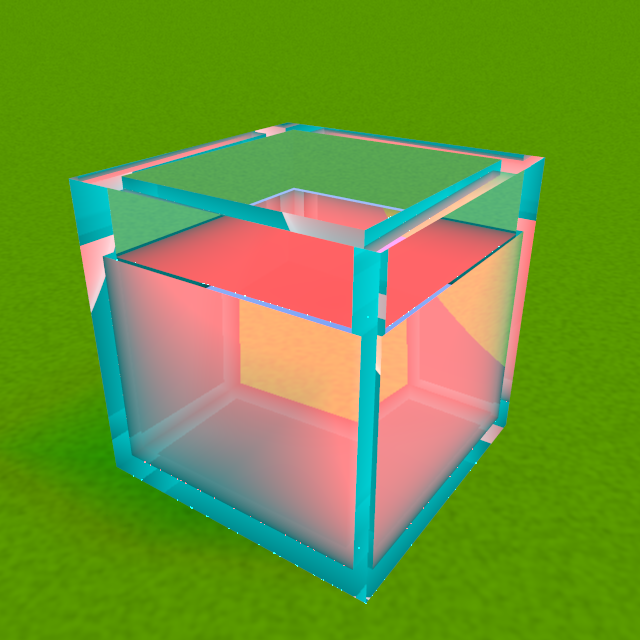

This is what happens when you push the fluid through the bottle wall.
Download 'fluid_test.png' (274 KB)
Preview of image 'fluid_test.png'

Le 22/08/2012 10:14, Thomas de Groot a écrit :
> To Joe (p.general)
> Thomas
I'm sure I can correct it, with a different approach.
can you provide the scene file, please ?

The only important code used is this. I experimented by switching on or
off the different hollow terms. Only with the fluid scale commented out
is the scene /realistic/.
//start code
union {
//bottle:
difference {
   box {-1, 1 hollow}
   box {-0.8, <0.8, 1.1, 0.8> hollow}
   material {
     texture {pigment {rgbt 1}}
     interior {
       ior 1.5
       media {samples 100 scattering {1, srgb <0, 1, 1>*0.5}}
//fluid:
box {
   -0.799, <0.799, 0.5, 0.799> scale 1.1
   hollow
   material {
     interior {
       ior 1.3
       media {samples 100 scattering {1, srgb <1,0,0>}}
rotate 35*y
//end code

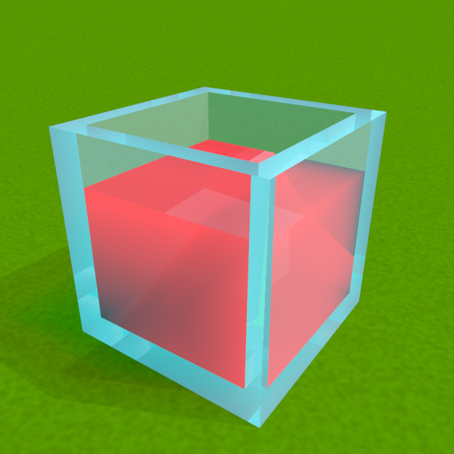

With the same code, this would be the object with the fluid just inside
the glass. Additionally I made the glass a bit more opaque (transmit 0.9).
Download 'fluid_test.png' (250 KB)

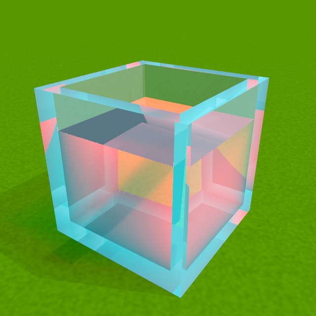

No need to have more than one surface per boundary, illustrated.
The fine eyes will spot the excess of liquid in the corners (here on
purpose, scene in p.b.scene-files, to exaggerate the overlap of air &
liquid)
Download 'fluid_test2.png' (286 KB)
Preview of image 'fluid_test2.png'
