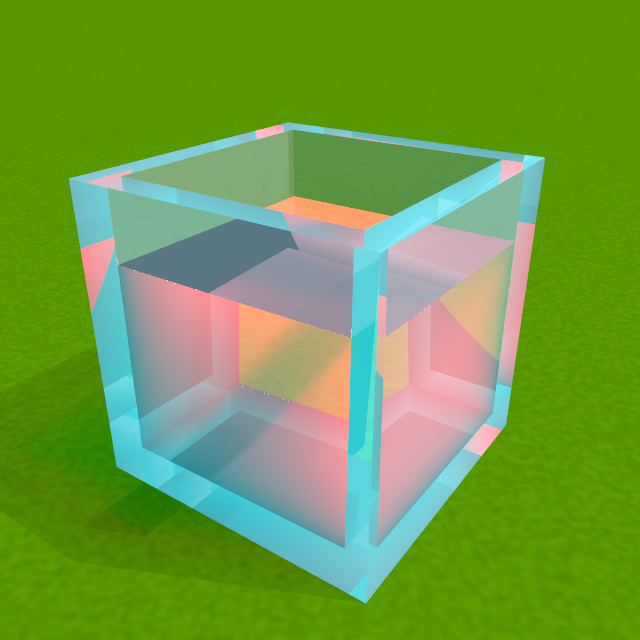

This is what happens when you push the fluid through the bottle wall.
Download 'fluid_test.png' (274 KB)
Preview of image 'fluid_test.png'

I'm sure I can correct it, with a different approach.
can you provide the scene file, please ?
Subject: Re: Filling a bottle with fluid
Date: 22 Aug 2012 07:29:17
Message: <5034c28d$1@news.povray.org>
I'll be delighted :-)
Note that I only tried to see what happened in case the fluid
intersected the bottle thickness. I have not tried your previous
suggestions.
The only important code used is this. I experimented by switching on or
off the different hollow terms. Only with the fluid scale commented out
is the scene /realistic/.
//start code
union {
//bottle:
difference {
   box {-1, 1 hollow}
   box {-0.8, <0.8, 1.1, 0.8> hollow}
   material {
     texture {pigment {rgbt 1}}
     interior {
       ior 1.5
       media {samples 100 scattering {1, srgb <0, 1, 1>*0.5}}
//fluid:
box {
   -0.799, <0.799, 0.5, 0.799> scale 1.1
   hollow
   material {
     interior {
       ior 1.3
       media {samples 100 scattering {1, srgb <1,0,0>}}
rotate 35*y
//end code

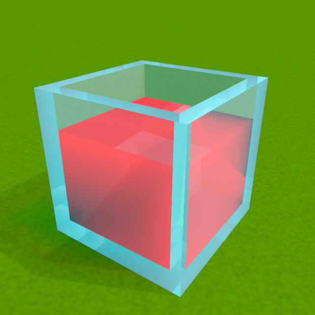

Download 'fluid_test.png' (250 KB)

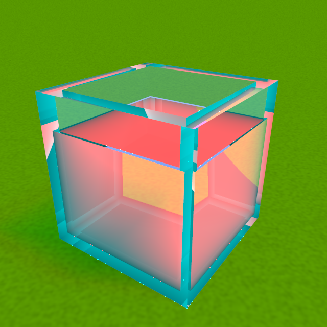

No need to have more than one surface per boundary, illustrated.
The fine eyes will spot the excess of liquid in the corners (here on
purpose, scene in p.b.scene-files, to exaggerate the overlap of air &
liquid)
Download 'fluid_test2.png' (286 KB)
Preview of image 'fluid_test2.png'
