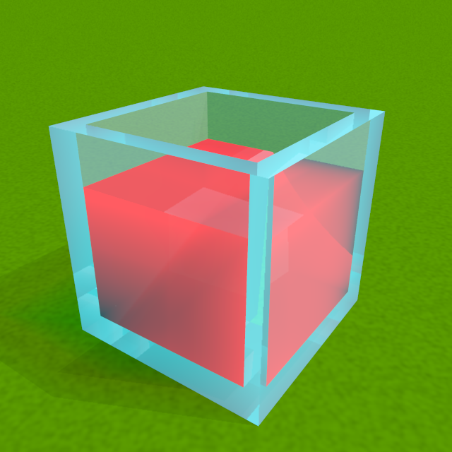

This is what happens when you push the fluid through the bottle wall.
Download 'fluid_test.png' (274 KB)
Preview of image 'fluid_test.png'

Le 22/08/2012 10:14, Thomas de Groot a écrit :
> To Joe (p.general)
> Thomas
I'm sure I can correct it, with a different approach.
can you provide the scene file, please ?

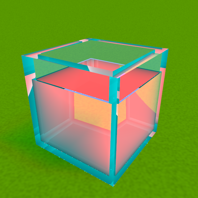

I'll be delighted :-)
Note that I only tried to see what happened in case the fluid
intersected the bottle thickness. I have not tried your previous
suggestions.
The only important code used is this. I experimented by switching on or
off the different hollow terms. Only with the fluid scale commented out
is the scene /realistic/.
//start code
union {
//bottle:
difference {
   box {-1, 1 hollow}
   box {-0.8, <0.8, 1.1, 0.8> hollow}
   material {
     texture {pigment {rgbt 1}}
     interior {
       ior 1.5
       media {samples 100 scattering {1, srgb <0, 1, 1>*0.5}}
//fluid:
box {
   -0.799, <0.799, 0.5, 0.799> scale 1.1
   hollow
   material {
     interior {
       ior 1.3
       media {samples 100 scattering {1, srgb <1,0,0>}}
rotate 35*y
//end code

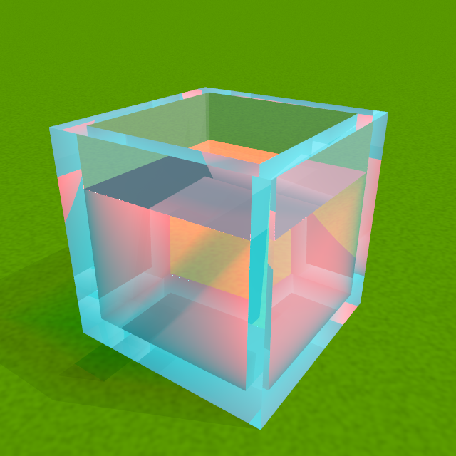

On 22-8-2012 10:14, Thomas de Groot wrote:
> To Joe (p.general)
> Thomas
With the same code, this would be the object with the fluid just inside
the glass. Additionally I made the glass a bit more opaque (transmit 0.9).
Download 'fluid_test.png' (250 KB)

Le 22/08/2012 10:14, Thomas de Groot nous fit lire :
> To Joe (p.general)
> Thomas
No need to have more than one surface per boundary, illustrated.
The fine eyes will spot the excess of liquid in the corners (here on
purpose, scene in p.b.scene-files, to exaggerate the overlap of air &
liquid)
Download 'fluid_test2.png' (286 KB)
Preview of image 'fluid_test2.png'
