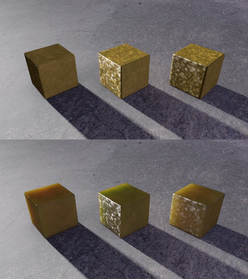

From: Robert McGregor
Subject: Re: Dominoes with subsurface{}
Date: 30 Aug 2012 15:55:01
Message: <web.503fc426c6d6fe4f86ff1d480@news.povray.org>
> Robert, as Alain and clipka said, you should try the last incarnation...
> works fine here: in fact, I was not able to reproduce the artifacts I
> got with the pool balls: surely I was doing something really weird with
> the texture maps.
> And it's easier to setup than media, more consistent and better looking,
> but unfortunately it's very slow, at least for scenes which consist
> mostly on translucent objects (as much as a x10 increase in rendering
> time for this shot). Oh, well...
> Jaime
(and the radiosity fixes were implemented). Thanks for the tips and for setting
me straight guys, much appreciated.
After reading through all the docs and playing around a bit today I came up with
this simple scene to test things out with radiosity. The top version uses three
identical superellipsoids lit by an area light and two shadowless fill lights.
In the bottom version the only change is the addition of subsurface in the
finish block of each cube, using a different translucency color for each. Each
cube is one POV-unit, with mm_per_unit 5.
The only drawback is that the SSLT version took 60 times longer to render than
the non-SSLT version. 20% of this extra time is for the SSLT calculations, but
the SSLT.
A very useful optimization for subsurface rendering would be a parameter to
ignore area light calculations within the subsurface material (if desired). This
would speed up render times considerably, while still keeping the realistic soft
shadows. For instance, when I rendered a version of this scene /without/ the
area light the SSLT version only took 5 times longer than the non-SSLT version
/with/ area light.
www.McGregorFineArt.com
Download 'sslt_blocks.jpg' (162 KB)
Preview of image 'sslt_blocks.jpg'
From: clipka
Date: 30 Aug 2012 18:11:19
Message: <503fe507$1@news.povray.org>
Am 30.08.2012 21:51, schrieb Robert McGregor:
I really love to hear that.
> the SSLT.

light, and some object casting a shadow on the floor: If we'd ignore the
area light and treat it as a point light, we'd get quite a sharp shadow,
softened only by the marble's SSLT effect; this is because SSLT doesn't
/complement/ the classic diffuse surface mechanism, but /replaces/ it.
But there's indeed still room for optimization: For SSLT, we could get
away with much lower area light quality.
What area light settings did you use? I guess for your scene it'll make
a huge difference whether you're using "adaptive 1" or "adaptive 0".
