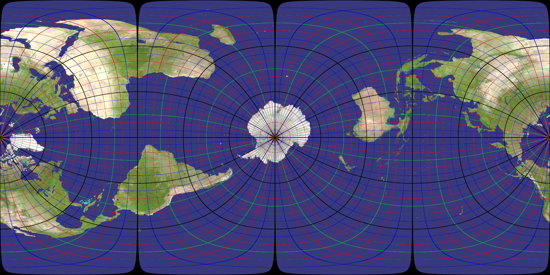

Using a mercator projection (100% spherical projection), but not as
usual (instead of a point on equator for center, using the south pole,
and forget about Greenwich meridian, off by 60°)
For once, groenland and australia seems approximatively right in
relative area.
Can you locate your home ?
Download 'mercat2.jpg' (722 KB) Download 'perspec.jpg' (319 KB)
Preview of image 'mercat2.jpg'
Preview of image 'perspec.jpg'
From: Christian Froeschlin
Subject: Re: kind of Mercator
Date: 19 Dec 2011 18:07:48
Message: <4eefc3c4$1@news.povray.org>
I think this is a transverse Mercator projection (Lambert 1772)
for a specific choice of central meridian (the usual representation
seems to be shifted 25% with respect to yours, though, i.e. poles
at 25% and 75% and equator at center and border).
http://en.wikipedia.org/wiki/Transverse_Mercator_projection
From: clipka
Date: 19 Dec 2011 19:43:03
Message: <4eefda17$1@news.povray.org>
Am 19.12.2011 21:53, schrieb Le_Forgeron:
FYI, the projection you used is not a transverse Mercator, but Cassini
(aka transverse equirectangular projection). Mercator would project your
"outer equator" into infinity, so it would not be visible on the map;
likewise, eastern Africa would not be that "squished", but rather just
out of proportion in size.
BTW, you seem to have some strange phenomenon in the waters of the Bahamas.

From: Le Forgeron
Date: 20 Dec 2011 03:35:52
Message: <4ef048e8@news.povray.org>
HS! You're probably right. Mercator would use a cylinder and so far I'm
on a sphere. Bad me, very bad me.
Back to the drawing table and the equations... put the right labels on
the right bottles...

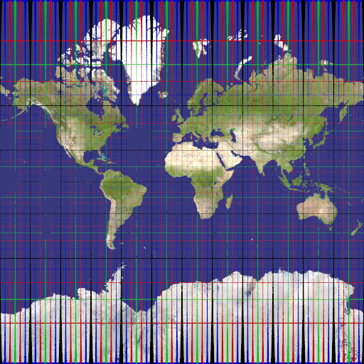

From: Le Forgeron
Date: 21 Dec 2011 15:06:50
Message: <4ef23c5a@news.povray.org>
Le 20/12/2011 09:35, Le_Forgeron nous fit lire :
Yep, now that's Mercator, using a square map (and aspect ratio 1:1).
Download 'mercat.jpg' (148 KB)
Preview of image 'mercat.jpg'
From: clipka
Date: 22 Dec 2011 01:06:10
Message: <4ef2c8d2$1@news.povray.org>
Am 21.12.2011 21:06, schrieb Le_Forgeron:
Ah, yes, Mercator: The only map projection that's absolutely uselsess
except for the single purpose of Navigating from A to B using nothing
but a compass. (And from what I know it's also the only projection that
does fit this purpose.)
You seem to have placed blue caps at the poles; is it a mere coincidence
that they're just the right size to show up on the northern and southern
edges of the map?
From: Le Forgeron
Date: 22 Dec 2011 03:12:17
Message: <4ef2e661$1@news.povray.org>
> edges of the map?
I put torus all over the spherical earth (not yet ready to scale it for
the delta of 23 km over 6000+ km), same scene as for the original post
of this threads, just different camera. They are spaced 5° apart, with a
colour coding (black is 0, 30, ..; multiple of 15 are green; multiple of
10 are red, and other are blue). So, yes, it's a mere coincidence that
the blue ones get in front at the edge.
In fact, the black torus are a bit bigger, so extending further the map
(with a 3:4 ratio for instance) would get a blacker edge. But there is
no real interest of such picture (at least with the torus), isn't there ?
