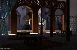

|  |  | Some more progress again. Three different views.
Inside: the tabletops still need an adequate texture. And waiting for
customers :-)
Outside: the "pubsign" is an object found a long time ago on the web,
and textured using Sam's NestProx macro. Thanks Sam!
Viewed real close, the arched passage strongly needs a displacement map.
The image map is too artificial in this case.
 Download 'at the jackal_10a.jpg' (426 KB)
Download 'at the jackal_10b.jpg' (503 KB)
A displacement map has been applied here, using the displacement feature
in Poseray.
 Download 'at the jackal_10c.jpg' (375 KB)
 Preview of image 'at the jackal_10c.jpg'
although it looks to me like the main problem here is lack of
image map resolution for the closeup view.
Also, have you tried using a bump_map? Or more caring inhabitants
that actually repair their walls now and then? ;)

|  |  | Am 11.12.2011 10:42, schrieb Thomas de Groot:
Beautiful scenes and delicious choice of colors. I really love it and
especially your attempt to create a whole little world and not just one
shot.
Thats it for the compliments and now the usual nitpicking:
Others have already mentioned it and I too find the moire pattern that
is produced by the floor tiles within the 'Jackal' most distracting.
Slightly blurring the image map or in case this are Jaime's tiles
modifying the color map to have a small transition between different
colors might help. In my experience even insane AA or FB setting do
sometimes not produce the desired smoothness so if anything else fails
rendering the image with higher resolution and moderate AA/FB and
finally down-sampling it should always do it without much of a speed
penalty.
Also polished stones or ceramic tiles are actually quite reflective when
viewed at shallow angles and therefor need fresnel falloff for the
reflection with a quite high IOR (1.5 and above). It is hard to predict
in this case but as the moire gets also stronger with shallow angels it
might also help with this unwanted patterns.
The next thing that bothers me is the texture of the stone arch in the
background. And I'm *not* talking about the 3rd picture where we are
standing below that arch and this issue is even more dominant.
The texture seems to be an image map that already has highlights and
shadows. And these do not match the real lighting condition. Actually
very close but it does not *really* fit.
To me this cries out loud CGI and I always find it distracting when
someone starts yelling at me.
Editing the used image with some clever filtering usually does the trick.
-Ive
> shot.
Thanks Ive.
OK, I was expecting that, and glad to get a few punches ;-)
[jumps into karate mode]
> penalty.
Yes, this has been a concern to me too, to the point where I am thinking
about a different decoration. I have first to investigate your
suggestions though.
These tiles already have fresnel and ior 1.5, so...
Yeah... I know, I know. Has been mostly laziness up till now, but that
image map sucks because of those shadows. I have not been really happy
with that from the start but kept it for later worries. A lame excuse, I
know, but there you have it. I definitely need to overhaul the whole
concept there. Thanks for the kick in the arse ;-)
| From: Thomas de Groot Subject: Re: Daily life in Gancaloon: At the Jackal (wip 5)
 Date: 12 Dec 2011 03:03:45
 Message: <4ee5b561$1@news.povray.org>
No use to ask the inhabitants. They just don't care I am told.
The problem needs a bit of serious work and Ive's comments complete
yours. No possibility any more to evade my responsibilities... ;-)

|  |  | I believe I have improved a number of things.
2) I processed the stone image map in the Gimp, and added a second layer
in POV.
ToDo: a better street surface.
 Download 'at the jackal_10a.jpg' (410 KB)
 Preview of image 'at the jackal_10a.jpg'

|  |  | Am 12.12.2011 14:11, schrieb Thomas de Groot:
Especially given that this render uses poor AA.
And for the reflection, hmm, I might be mistaken, but I would expect it
to look different, especially where I think the sky or one of the
opposite white walls from the houses are reflected. My starting point
for ceramic floor tiles would be something like reflection {0 0.8
fresnel on metallic 0.1} (ideally it would be {0 1 fresnel on ... the
0.8 is only to assume a layer of dust/dirt).
> in POV.
The stone texture itself does now fit nicely, but I liked it better
without the plaster as this broken plaster element is already widely
used within the scene.
-Ive
Why? Not that poor, though.
0.8?! I use 0.05 as otherwise the tiles are much too reflective for my
taste. 0.8 gives the tiles a mirror aspect which I certainly do not
want. See image with 0.8 instead of 0.05.
I might increase that value a bit though.... ;-)
I agree. See image.
 Download 'at the jackal.jpg' (418 KB)
 Preview of image 'at the jackal.jpg'

|  |  | Am 13.12.2011 09:12, schrieb Thomas de Groot:
The staircases? See attachment. Even more prominent at the sunlight
shadows from the facade beams.
Well, I said "starting point" and not that I would leave it this way ;)
I just checked it out in our kitchen and the tiles *are* becoming a
perfect mirror (slightly blurred though) and their own colors and
ornamentation gets completely lost.
So the high reflection does not look *that* wrong to me. Major problem
is that it makes it obvious that the floor is a perfect plane missing
the expected irregularity in tile alignment and the missing joints/gaps.
Anyway it is just about finding the right balance between real-world
physics and faking it as usual within ray-tracing. Even with so called
unbiased render engines this keeps true (or maybe even more, because
flaws become also more obvious) as I'm currently playing around with the
trial version of the Maxwell renderer.
-Ive
