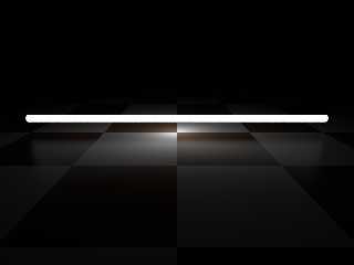

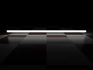

I just checked in a change to the area_illumination feature to properly
respect distance-based light attenuation. See attached images for the
difference.
Download 'test_rc3.png' (36 KB) Download 'test_new.png' (29 KB)
Preview of image 'test_rc3.png'
Preview of image 'test_new.png'
> difference.
wonderful!
> difference.
It's a spectacular improvement.
Can we have at least a RC3.5, if we can't have the RC4 at the moment?
If it was my call, you would already have an RC4 by now, and wouldn't
have access to this updated feature either at the moment :-P
> difference.
Yes, it looks perfect! Indoor lighting just became a lot more feasible. Can't
wait to try it out :)
