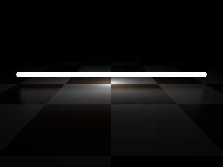

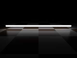

I just checked in a change to the area_illumination feature to properly
respect distance-based light attenuation. See attached images for the
difference.
Download 'test_rc3.png' (36 KB) Download 'test_new.png' (29 KB)
Preview of image 'test_rc3.png'
Preview of image 'test_new.png'
> difference.
wonderful!
> difference.
It's a spectacular improvement.
> difference.
Yes, it looks perfect! Indoor lighting just became a lot more feasible. Can't
wait to try it out :)
