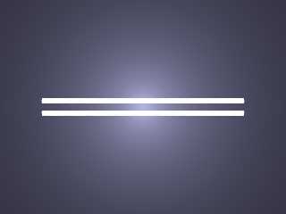

Hi(gh)!
Onward with the standard include files and, thus, with the PoV-Ray
museum of Port Whatmough's Academy of Raytraced Art (ARA)!
When I started to test the neon tubes for the exhibition rooms'
illumination, I noticed a strange behaviour of the area_light: although
I defined center and size of the area light correctly, the light
concentrates in one point! Moreover, the looks_like object (a union of
two narrow cylinders) is cut in half!
Here is the code:
#declare F_Standard_Indoor =
finish
   diffuse 1.15
   brilliance 0.6
#declare F_Incandescent =
finish
   diffuse 1
   ambient 1
#declare T_Simple_White_Incandescent =
texture
   pigment { color rgb 1 }
   finish { F_Incandescent }
#declare Neon_Tube =
cylinder
   0, <2, 0, 0>, 0.025
   texture { T_Simple_White_Incandescent }
   plane
     y, 0
     texture
       pigment { MidnightBlue }
       finish { F_Standard_Indoor }
   light_source
     <1, 0.1, 0.06>
     color White
     area_light
     <2, 0, 0>, <0, 0, 0.12>, 5, 2
     adaptive 1
     jitter
     fade_distance 1
     fade_power 2
     looks_like
       union
	object { Neon_Tube translate <0, 0.1, 0> }
	object { Neon_Tube translate <0, 0.1, 0.12> }
   camera
     location <1, 4, 0.06>
     look_at <1, 0, 0.06>
     angle 40
// end of code
Bizarre!
See you in Khyberspace!
Yadgar
Now playing: Illusions On A Double Dimple (Triumvirat)
Download '2011-12-02 includes showroom 1, take 19 - neon tubes, assembly view.jpg' (13 KB)
Preview of image '2011-12-02 includes showroom 1, take 19 - neon tubes, assembly view.jpg'
From: clipka
Subject: Re: Strange behaviour of area_light
Date: 2 Dec 2011 10:16:11
Message: <4ed8ebbb$1@news.povray.org>
You have two different issues here:
- The historic area_light code is only designed to generate soft
shadows; other effects (highlights and - as in your case -
distance-based light fading) remain as per a standard point light. (The
area_illumination switch introduced with 3.7 does fix this for
highlights, but not for distance fading yet.)
- As for the looks_like object, note that you need to specify that
object as if the light source was located at <0,0,0>; it will
automatically be translated to the true position of the light source. (I
just noticed that this doesn't seem to be mentioned in the docs. I'll
take care of that.)

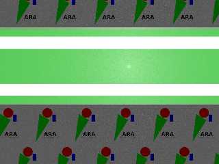

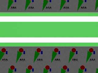

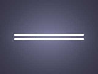

I tried area_illumination (second image attached here) - and, yes, a
little bit grainy, but I think it's tolerable at least for the time
being! The area illumination not being taken into account for fading
might yield weird results, but for my scene it would not very notable,
as I'll use not less than 5 x 6 of these dual neon light panels for a
room of 15 by 12 metres!
> being!
> Yadgar
Regarding the graineeness isue:
Looking at your light_source, I see this:
light_source
     <1, 0.1, 0.06>
     color White
     area_light
     adaptive 1
     jitter
     fade_distance 1
     fade_power 2
     looks_like
       union
As you have 2 strips, the 2 is OK.
The problem is that you have only 5 samples on the long side.
I propose something like this:
     area_light
     <2, 0, 0>, <0, 0, 0.12>, 17, 2
     adaptive 1
     jitter
Other densities that can be good: 33, 2 or 65, 2
(at 65, 2, or more, you probably no longer need to use jiter)
It's also possible that you may have correct results using only adaptive 0.
When you have a long and narrow light, the effective fade_power gets
lower than 2. In a typical room where your distance from the tubes are
relatively small, a fade_power 1.5 would probably be more realist.
The fade_power becomes 1 when the lenght of the light becomes very large
relative to the distance.
A very large/infinite emiting plane effectively don't fade with
distance: fade_power 0.
Do the test with a radiosity scene illuminated by an emiting plane.You
will have a constant illumination regardless of the distance from the plane.
From: clipka
Date: 2 Dec 2011 17:43:58
Message: <4ed954ae$1@news.povray.org>
Am 02.12.2011 23:01, schrieb Alain:
A fade_power setting of 2 is perfectly ok in /every/ situation with
light sources of finite size. Note that the effective fade_power already
decreases automatically as objects get closer to the light source. This
effect is governed by fade_distance, which should be set to the light
source's size, or at least a value somewhere close.
From: Jörg 'Yadgar' Bleimann
Date: 5 Dec 2011 20:52:32
Message: <4edd7560@news.povray.org>
Hi(gh)!
On 02.12.2011 19:31, Warp wrote:
> And the reason why area_illumination is not always on (at least
> currently) is that it makes rendering of area lights a bit slower.
Yes it does... 129.029 CPU seconds (I assume that this is the time
actually devoted to POV-Ray regardless of any multitasking background
processes) (first image) vs. 148.053 for the the last image attached here...
