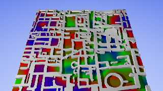

The attached image is the render of a prism object (linear_sweep
bezier_spline) generated by Inkscape from an image.
My question is if it would be possible, and if yes how, to drape this
prism over a (gently) undulating height_field? The vertical component
should remain vertical of course as they represent (foundation) walls.
Download 'inkscape_mohenjodaro_test.png' (219 KB)

From: Bill Pragnell
Subject: Re: Prism over a height_field?
Date: 28 Jul 2011 04:25:00
Message: <web.4e311ca618d248626dd25f0b0@news.povray.org>
Extend the prism in y, and intersect with a copy of the heighfield offset in y?

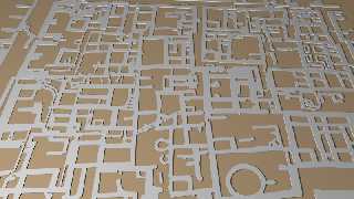

Date: 28 Jul 2011 05:03:16
Message: <4e3125d4@news.povray.org>
Yes indeed! That seems to do the trick. Here a small test image.
Thanks again!
Download 'inkscape_mohenjodaro_test.png' (237 KB)
Preview of image 'inkscape_mohenjodaro_test.png'
From: Bill Pragnell
Date: 28 Jul 2011 05:25:00
Message: <web.4e312a2f18d248626dd25f0b0@news.povray.org>
Are you sure you used the heightfield correctly? In some areas, the walls seem
deeper than in others. Or is that deliberate? :)
Date: 28 Jul 2011 07:16:41
Message: <4e314519@news.povray.org>
Not deliberate, but indeed a need for better coordination of the
parameters :-) On the other hand, it can be used for some height variations.
This image shows a better construction.
Download 'inkscape_mohenjodaro_test.png' (316 KB)
