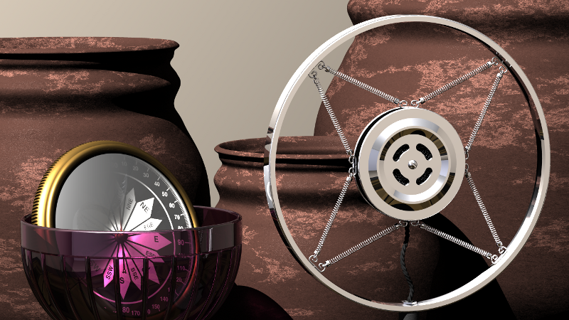

I've been working on a scene using a couple of objects that I was never
really happy with the way I'd initially displayed them ... The compass
was difficult because it has such a low profile. I like how it's
beginning to look now that I've placed it in the goblet (btw: amethyst
glass). The microphone shows a lot more detail, but I'm not too happy
with the reflection of the room. The floor, ceilings and walls have
individual textures ... I was trying to mitigate the appearance of the
corners by applying gradients and different finish attributes, but only
got so far. Is that what an HDR light map could help with? I've
certainly admired some for the recent posts using that technique, but
haven't a clue where to start! Any good ref material on how to get
started with HDR and povray out there ... (if that's what I should be
going after)
Download 'wip.png' (559 KB)
Preview of image 'wip.png'

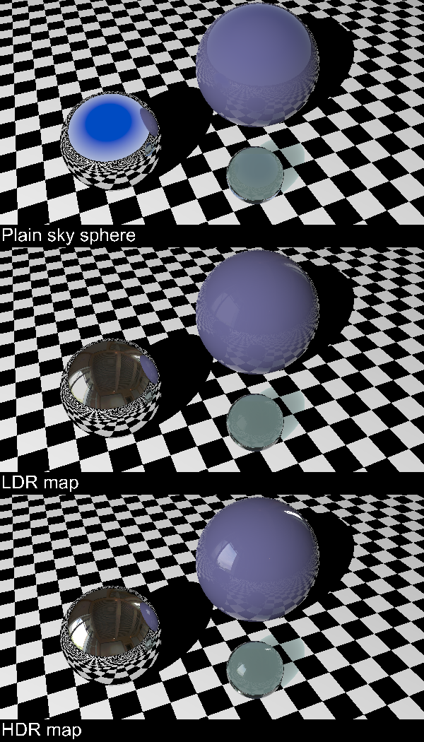

For example I have attached a scene that I have rendered with 3 different
environments: a) plain sky sphere, b) LDR (jpg version of the HDR used) c) HDR.
For this scene, I have only used a single point light, which doesn't
necessarilty match the lighting expected from the environment mpa.
You should be able to see how the environment makes the textures more
interesting, and how the HDR shows the highlights better.
Standard implementation would be mapping it to a sky_sphere or to a large
physical sphere (hollow for media to work).   I prefer the physical sphere, as I
can use 'ambient' to increase/decrease the brightness of the map used.
sphere{0, 12000 hollow
  pigment{image_map {hdr "HDR.hdr" map_type 1}}
  finish{diffuse 0 ambient 1}
Note:
- map_type 1 maps the image spherically
- you can change ambient to change the brightness of the map
- hdr is only supported in 3.7 (or megaPOV), not 3.6
Download 'envmapex.png' (237 KB)
Preview of image 'envmapex.png'

Nice scene, Jim. Perhaps you could "weight" each item's contribution to the
scene. That is, the image rectangle bounding the scene should either: display an
entire object plus 1/3 of its width/height, or only display 1/3-2/3 of each
object. But that's a personal preference, of course :)
For some reason, the amethyst bowl looks more "red" in its preview than it does
for the full-sized image. Maybe there's a newsgroup gamma discrepancy present?
Sam
ha-ha ... thanks for the little lesson in composition. generally I like
the lines in the scene (l to r) but maybe this might explain why i was
feeling like it wasn't completely "there" yet

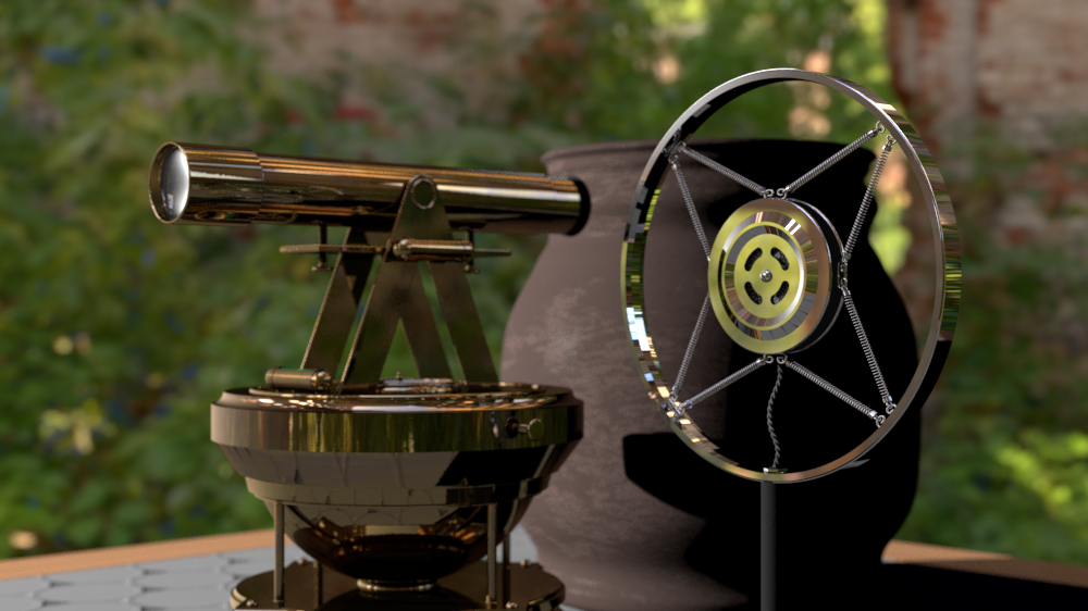

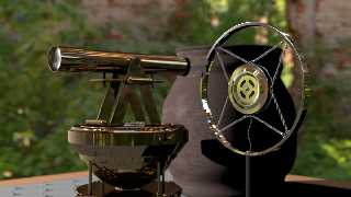

From: Jim Holsenback
Subject: Re: A better view?
Date: 12 Feb 2011 15:06:53
Message: <4d56e85d@news.povray.org>
Thanks for the pointers to the hdr resources ... I used the abandoned
paper mill as a light map and yikes ... what a difference
Download 'hdrtest.png' (603 KB)
Preview of image 'hdrtest.png'
From: Stephen
Date: 12 Feb 2011 15:13:57
Message: <4d56ea05$1@news.povray.org>
Too true, it looks Brill.
Regards
     Stephen
From: Robert McGregor
Date: 12 Feb 2011 16:30:01
Message: <web.4d56fba368e3dc0b94d713cc0@news.povray.org>
Yes, it's amazing what IBL can do for a shot; this looks really nice Jim.
www.McGregorFineArt.com
