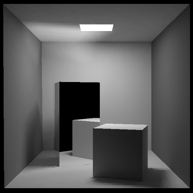

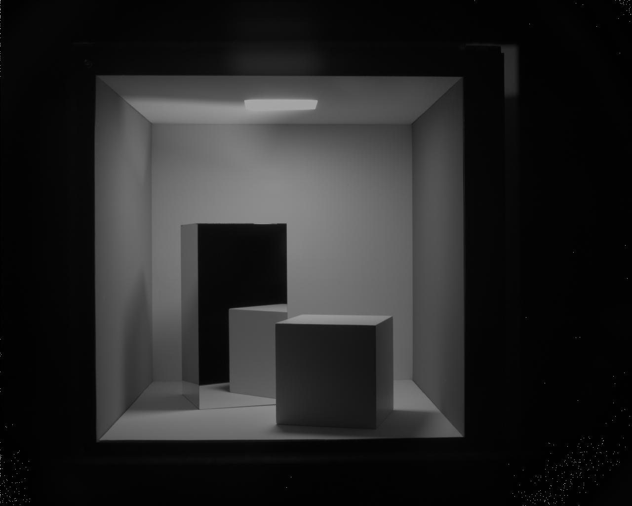

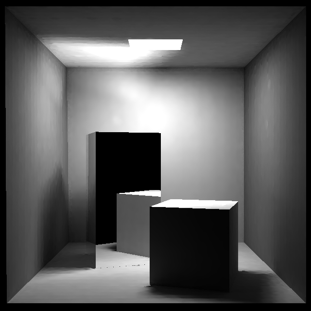

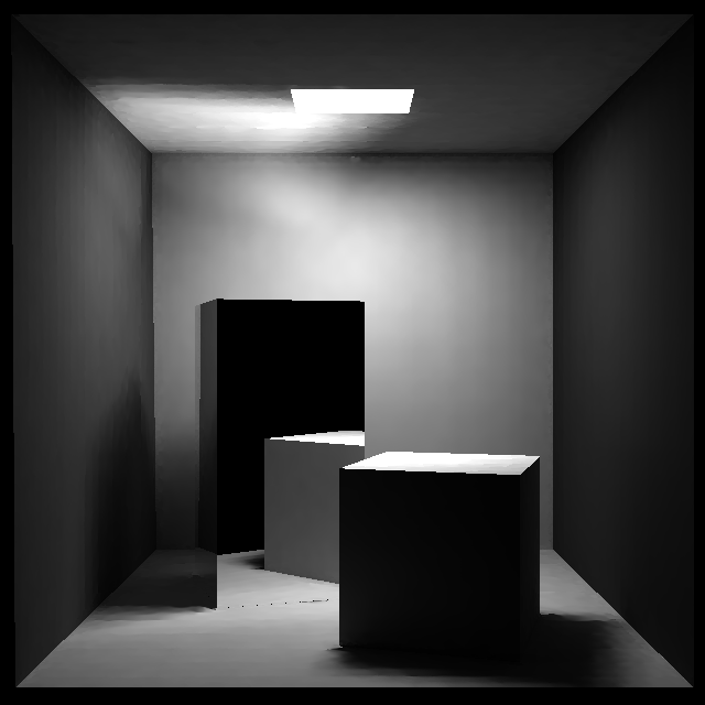

The following images show the Cornell University's famous "Cornell Box"
reference scene for 3D rendering...
(1) as a photograph taken from the "real thing" at Cornell University,
using sophisticated calibrated equipment, at a wavelength of 600nm; the
original is an OpenEXR image; I applied linear brightness adjustment for
more contrast and converted to PNG for convenience, which shouldn't hurt
its fitness for serving as a reference image, but if in doubt you can
compare with the original
(http://www.graphics.cornell.edu/online/box/box_exr.zip).
(2) as a POV-Ray 3.7 render using geometry, surface reflectance and
light source data as published by the Cornell University
(http://www.graphics.cornell.edu/online/box/data.html) for a wavelength
of 600nm, using "assumed_gamma 2.2"; light intensity was adjusted in an
attempt to obtain a similar overall brightness as the photograph; notice
how the side walls still appear much too dark while some other areas are
already too bright.
(3) ditto but with gamma-correction applied to the color values; notice
how this fixes the relative brightness of the surfaces, but otherwise
still leaves the image with a much stronger contrast than with the "real
thing".
(4) using the original color values again, but without "assumed_gamma".
The brightness of the light source was adjusted by exactly the same
factor that the photograph had been brightened; no other parameters were
tweaked. Notice how the "real thing" is simulated pretty faithfully.
Download '600nm.png' (1639 KB) Download 'cornell_gamma22_raw.png' (95 KB) Download 'cornell_gamma22_adjusted.png' (112 KB) Download 'cornell_gamma10.png' (89 KB)
Preview of image '600nm.png'
Preview of image 'cornell_gamma22_raw.png'
Preview of image 'cornell_gamma22_adjusted.png'
Preview of image 'cornell_gamma10.png'

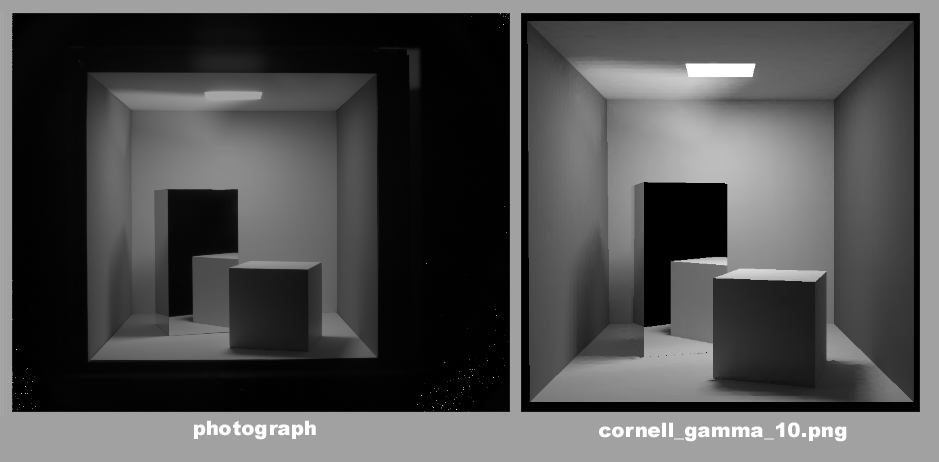

I hope I'm not muddying the issue (or doing something stupid at my end), but
your posted Cornell .png photograph is definitely the worst of the lot, when
viewed on-line in the latest Firefox browser (v3.6.13): low contrast and darker
than any of the POV-Ray images. Perhaps it needs tweaking in some further way,
to make it a good comparison image? (I'm *guessing* that it was meant to compare
more favorably with the gamma 1.0 image, or vice versa.) Here are some simple
screen shots, assembled in Photoshop (which didn't materially affect how they
appear in Firefox); just a simple JPEG.
Ken

Its dark appearance in FF may be due to the fact that the images are
presented on a white background, and the "real thing" has much more
black border around it; especially with the preview this messes a lot
with the image's appearance.
As for having low contrast, that's the point I'm making: The photograph
/is/ a physically accurate image, so if there's any tweaking to do to
make it look like the POV-Ray renders, then the tweaking needs to be
done on the POV-Ray side - this comparatively low contrast is physically
/correct/.
Subject: Re: Gamma Reference Image
Date: 22 Dec 2010 02:58:17
Message: <4d11af99$1@news.povray.org>
"clipka" <ano### [at] anonymousorg> schreef in bericht
news:4d110528$1@news.povray.org...
> presented on a white background, and the "real thing" has much more black
> border around it; especially with the preview this messes a lot with the
> image's appearance.
Idem for me as for Kenneth, also in Firefox. It is not the white background.
Even the ceiling light in POV-Ray is pure white, compared to muddy grey in
the photograph.

The original was taken with a CCD, so the captured response is linear. Taking
the 600nm OpenEXR version and converting it to a 2.2 gamma gives a realistic
image to my eyes. If the original was a photograph, then you'd have a non-linear
tone curve to deal with (exponential, but with rolloff on the top and bottom)
Cheers,
Edouard.

The original image was much dimmer (half the physical brightness as the
PNG I posted). I guess the dim overhead light is due to reaching the
CCD's dynamic range limit, and the image was linearly adjusted in
brightness to represent absolute light intensity in some nice SI unit.
