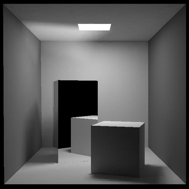

(2) as a POV-Ray 3.7 render using geometry, surface reflectance and
light source data as published by the Cornell University
(http://www.graphics.cornell.edu/online/box/data.html) for a wavelength
of 600nm, using "assumed_gamma 2.2"; light intensity was adjusted in an
attempt to obtain a similar overall brightness as the photograph; notice
how the side walls still appear much too dark while some other areas are
already too bright.

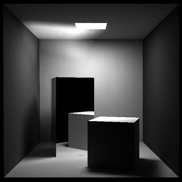

(3) ditto but with gamma-correction applied to the color values; notice
how this fixes the relative brightness of the surfaces, but otherwise
still leaves the image with a much stronger contrast than with the "real
thing".

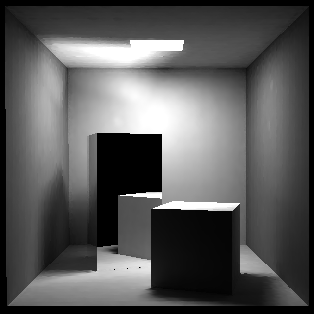

(4) using the original color values again, but without "assumed_gamma".
The brightness of the light source was adjusted by exactly the same
factor that the photograph had been brightened; no other parameters were
tweaked. Notice how the "real thing" is simulated pretty faithfully.

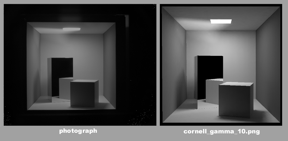

I hope I'm not muddying the issue (or doing something stupid at my end), but
your posted Cornell .png photograph is definitely the worst of the lot, when
viewed on-line in the latest Firefox browser (v3.6.13): low contrast and darker
than any of the POV-Ray images. Perhaps it needs tweaking in some further way,
to make it a good comparison image? (I'm *guessing* that it was meant to compare
more favorably with the gamma 1.0 image, or vice versa.) Here are some simple
screen shots, assembled in Photoshop (which didn't materially affect how they
appear in Firefox); just a simple JPEG.
Ken
Download 'images_compared.jpg' (124 KB)
Preview of image 'images_compared.jpg'
