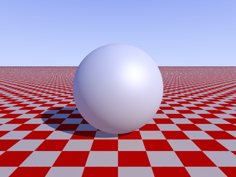

Okay, so I could no longer keep my restless fingers under control...
here it is, dithered output directly from POV-Ray.
To showcase the effect, I chose a bit depth of 5 bit (the lowest you can
get with PNG), but the algorithm works perfectly fine with other bit
depths as well.
First image shows the original in 8 bit (no dithering applied; if you
look /very/ closely, you may still see some banding in the sky). All
other images use 5 bits per colour channel:
(off) 5 bit image without dithering (I guess I don't need to mention the
banding).
(b2) Bayes dithering using a 2x2 pattern
(b4) Bayes dithering using a 4x4 pattern
(d1) 1-dimensional error diffusion dithering (propagating all the error
to the next pixel to the right)
(d2) 2-dimensional error diffusion dithering (propagating half of the
error to the next pixel to the right, and a quarter, respectively, to
the pixels below and below right)
(fs) the famous Floyd-Steinberg dithering (another error diffusion
dithering)
I didn't bother to implement random dithering, as I don't think it gives
real added value at the bit depths typically used. (b2), (b4) and (d1)
have the advantage of using (almost) no additional memory (I implemented
(d2) and (fs) using an additional 2-pixel-row buffer to avoid messing
with the original data), while (fs) probably gives the best results.
I'll probably drop (d2) as it doesn't seem to add much value either.
A point I'd like to emphasize is that I implemented the diffusion
dithering methods to propagate the error /before/ gamma
encoding/pre-correction. (One reason why dithered black-and-white images
typically lose quite some "depth" is that they are implemented without
attention to gamma.) Not that it will probably matter much with the
typical bit depths, but you know - I just had to do this right ;-)

From: Jim Holsenback
Subject: Re: Dithered Output
Date: 4 Dec 2010 12:09:35
Message: <4cfa75cf$1@news.povray.org>
ha-ha ... what coding machines you guys are! between you and Le Forgeron
i'm having a time of it keeping up ;-) btw: nice!
	I assume you meant "Bayer"?
	You probably already know it, but for others who may not here are a
couple of points to keep in mind:
 - Dithering may cause very visible moire artifacts when the images
are printed;
 - There is probably no point in using this if you intend to convert
your images to JPEG since the conversion will cause fine details
like the dither pattern to disappear anyway...
		Jerome

Am 04.12.2010 19:43, schrieb "Jérôme M. Berger":
Oops, yes - I've been struggling with that name the whole day ;-)
> are printed;
Hm, I didn't think of that. Actually I'd expect it to improve print quality.
I also guess it depends on the dithering algorithm; maybe that's where a
benefit of random dithering can be found? Printers should be quite
immune to random noise in images to be printed I guess.
JPEG and OpenEXR output will not support dithering (nor will Radiance
HDR for the time being - though it could be of use there - as it is not
as straightforward as with classic low dynamic range images).

I remember I asked for this two years ago as an idea for POV4 (at the time I
had a sky scene that gave horrible banding and had to do it "by hand").
Great work getting it in 3.7 :-)
a
>> are printed;
> quality.
a
	The problem is that the printer will also use a dither algorithm
when printing and you can have unwanted interactions between the
two. However, since you implemented both Bayer dithering and error
diffusion it should be possible to avoid the issues by choosing the
other method than the printer. However, this is something to keep in
mind when rendering because you don't want to realize you made the
wrong choice after a one week high resolution render ;)

Good evening,
You may want to test another dithering algorithm: its is entitled "A Simple and
Efficient Error-Diffusion Algorithm" and it is available on this web page:
http://www.iro.umontreal.ca/~ostrom/publications/abstracts.html
A source code is also provided. (There are also more recent publications about
error diffusion on the same page).
Another recent work that I am aware of, with some pictures to have an idea of
the result:
http://people.scs.carleton.ca/~hli1/publication/Contrast-Aware-Halftoning/CAHalftoning.htm
As mentioned by other people, I would suggest to avoid the "it took 3 days to
render and I have used the wrong dither method" effect. My proposals are:
1. If the user wants a dithered output, then POV-Ray outputs the original image
AND ALL the dithered images (using ALL the available algorithms). It would be up
to the user to select the one the user likes. A "more than 8 bits per component"
image would always be saved "just in case".
2. Add the dither as a postprocessing step, for instance calling POV-Ray with a
"--dither" argument. It would process an existing picture, and it would not
render anything new.
I hope this helps,
Lionel
