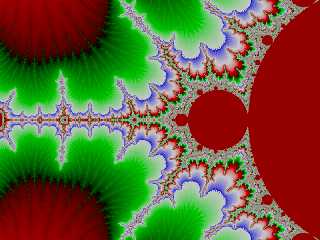

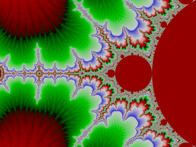

...in the mandel pool.
Small picture is a classical Mandelbrot set, at usual scale.
The other is about <-1.5099872678075,0>/2
with an iteration limit of 999 999 and a zoom factor of 99 999 999.
(just testing an exterior_type)
Download 'pigment.png' (576 KB) Download 'pigment7.png' (17 KB)
Preview of image 'pigment.png'
Preview of image 'pigment7.png'

Le 16/11/2010 23:26, Samuel Benge nous fit lire :
(#declare n=399; value of fact & iter already provided)
pigment {mandel iter
	exterior 7,n
	interior 0,0.5
	pigment_map{
		[0.0 Blue]
		[((n-1)/n)*1/5 White]
		[((n-1)/n)*2/5 Red]
		[((n-1)/n)*3/5 Black]
		[((n-1)/n)*4/5 Green]
		[((n-1)/n)*5/5 White]
		[1.0 Red]
} translate <1.5099872678075,0,Radius>
scale fact
> Did you use log smoothing for the exterior in the larger image?
No, I used my own patched version to get a value based on the iteration
number at exit(e):  (e % n) / n
With e the number of iteration at exit
and n the factor of the exterior
(instead of the classical type which return n / max iteration)
It does not fully cover [0..1], so I also made a type 8: (e % (n+1))/n
Still wondering which one is best.
(7 is easy to reserve the 1.0 for the interior, 8 has more coverage...)
