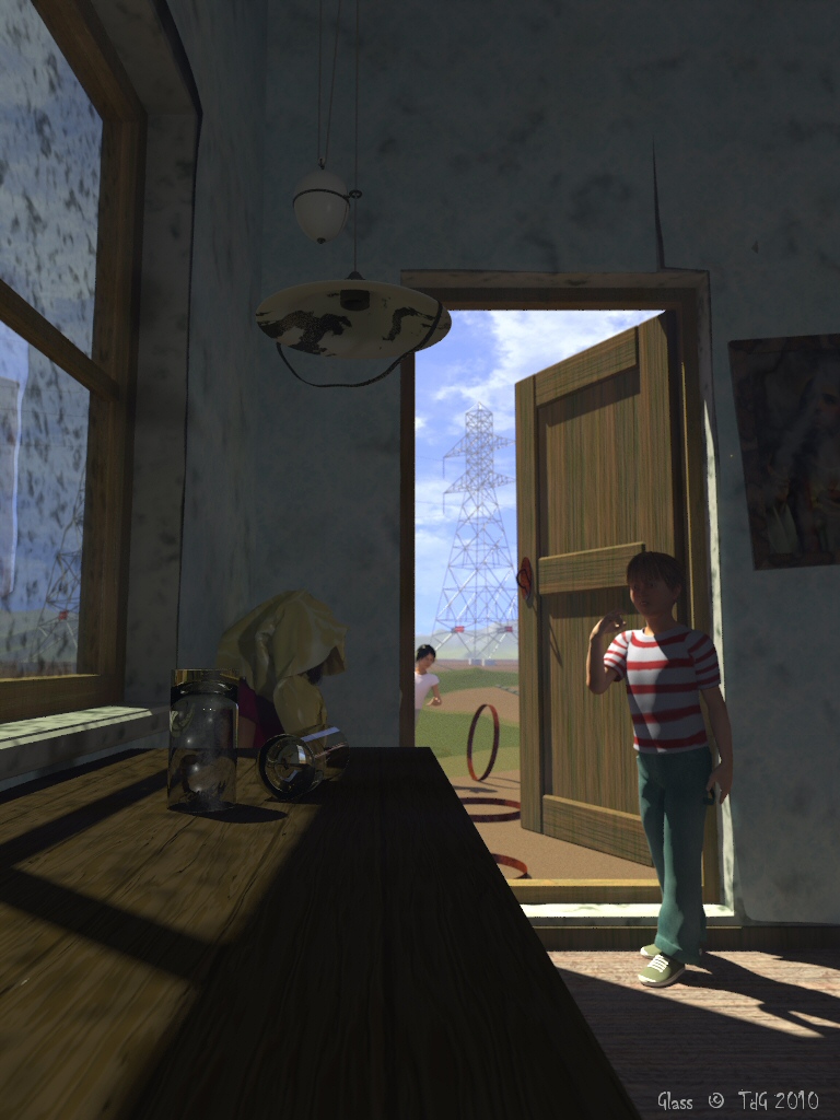

This image was made for the TC-RTC competition. It uses photons. However,
for esthetic reasons,  I much prefer the version without photons I uploaded
to the site: http://www.tc-rtc.co.uk/imagenewdisplay/stills/301/Glass.html
It is probably me, but photons made the glass, its shadow, and its content
darker.
Download 'Glass_final_photons.jpg' (242 KB)

When light goes through a glass, it get spread out exept for the light
that goes through the thick base. And even then, given the shape of the
inside of your glasses, it get's a fair amount of spreading.
In the non-photons version, light goes straight through the glass
without any deviation.
Do you also use radiosity for that scene?

Yes, I use also radiosity.
This is possibly a difficult glass object to use photons with (from Ingo
Jansen's grenadine.pov). One thing I noticed when I decreased the spacing
parameter beyond a rather low value, was that the entire image became black.
Is there a way to get *better* results? For the glasses I used collect on,
with same results as with collect off for instance, and I switched
reflection off keeping only refraction on (also in the light block).

collect on enable photons to show on the object's surface. On a glass
object, most of the time, it's a waste.
You have a glass window pane. Is it set to passthrough? You may have to
many photons if the window is set as a target. It may also prevent
photons from reatching the glass if not set as a target.
Also, set the curtains as passthrough.
The photons block for the light_source is optional defaulting to
photons{refection on refraction on area_light off}
You usualy don't need to change it.

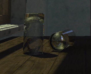

I did a number of corrections and changes to my settings. The result of
photon mapping seems good to me (note: no aa here).
Download 'Glass.jpg' (34 KB)
Preview of image 'Glass.jpg'
