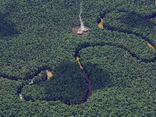

Hi All:
    Google image search is becoming my first source for unexpected
inspiration... as usual, I was searching for something else, when found a
nice aerial pic of the Amazon river.
    Here are some details about this "quick hack":
    + The base terrain is a heighfield, hand-painted over a googlemaps
screen-shot.
    + The river is just a plane, with a bump map also hand-painted in The
Gimp, and a simple orange scattering media for the "muddy water" effect.
    + There are 50,000 POVTrees, using only 4 different meshes. The tree
sizes and distribution are half-guided by a pigment function.
    + The huts were made with Wings3D in about a minute (well, maybe two...)
and the smoke column was borrowed from my office scene (the cigarette smoke).
    + Of course, skylight.inc was used for the lighting.
    + render time was 40 min for the first pass, and just 20 for the final one.
Jaime Vives Piqueres
http://www.ignorancia.org
Download 'amazonas-05.jpg' (545 KB)

From: Thorsten Froehlich
Subject: Re: Amazonas
Date: 15 May 2010 06:57:57
Message: <4bee7e35$1@news.povray.org>
On 15.05.10 09:48, Jaime Vives Piqueres wrote:
> Hi All:
Wow!
Hmm, out of curiosity, do you have the full stats output?
	Thorsten

From: jute
Date: 15 May 2010 08:05:01
Message: <web.4bee8d809c4c180cf43b014e0@news.povray.org>
That's marvelous.  Please give us some views from within the forest!
jussi
From: Jim Charter
Date: 15 May 2010 13:16:39
Message: <4beed6f7$1@news.povray.org>
> Hi All:
> screen-shot.
> smoke).
> final one.
>    Regards,
What fun!  Keep it simple.
I take it the shadows are from clouds?  Nice touch.

From: Samuel Benge
Date: 15 May 2010 15:15:00
Message: <web.4beef2329c4c180cff20d680@news.povray.org>
For being a "quick hack", this render is very nicely done! A little more color
variation could help the trees, and the smoke looks a little off, possibly
because it was designed for a smaller-scale scene. For the most part, though, it
looks good!
It must be nice to have inspiration :(
Date: 16 May 2010 03:04:35
Message: <4bef9903@news.povray.org>
"Jaime Vives Piqueres" <jai### [at] ignoranciaorg> schreef in bericht
news:4bee520e@news.povray.org...
"Quick hack"... you are joking Jaime! Such a scene would take me a couple of
days at least.
Excellent, as always. Very photographic.
Please, keep us in wonder.

From: Jaime Vives Piqueres
Date: 16 May 2010 05:44:14
Message: <4befbe6e$1@news.povray.org>
   Thanks!
   Yes, I forgot to mention the clouds: it is just a plane with a turbulent
leopard pattern, to cast some shadows.
