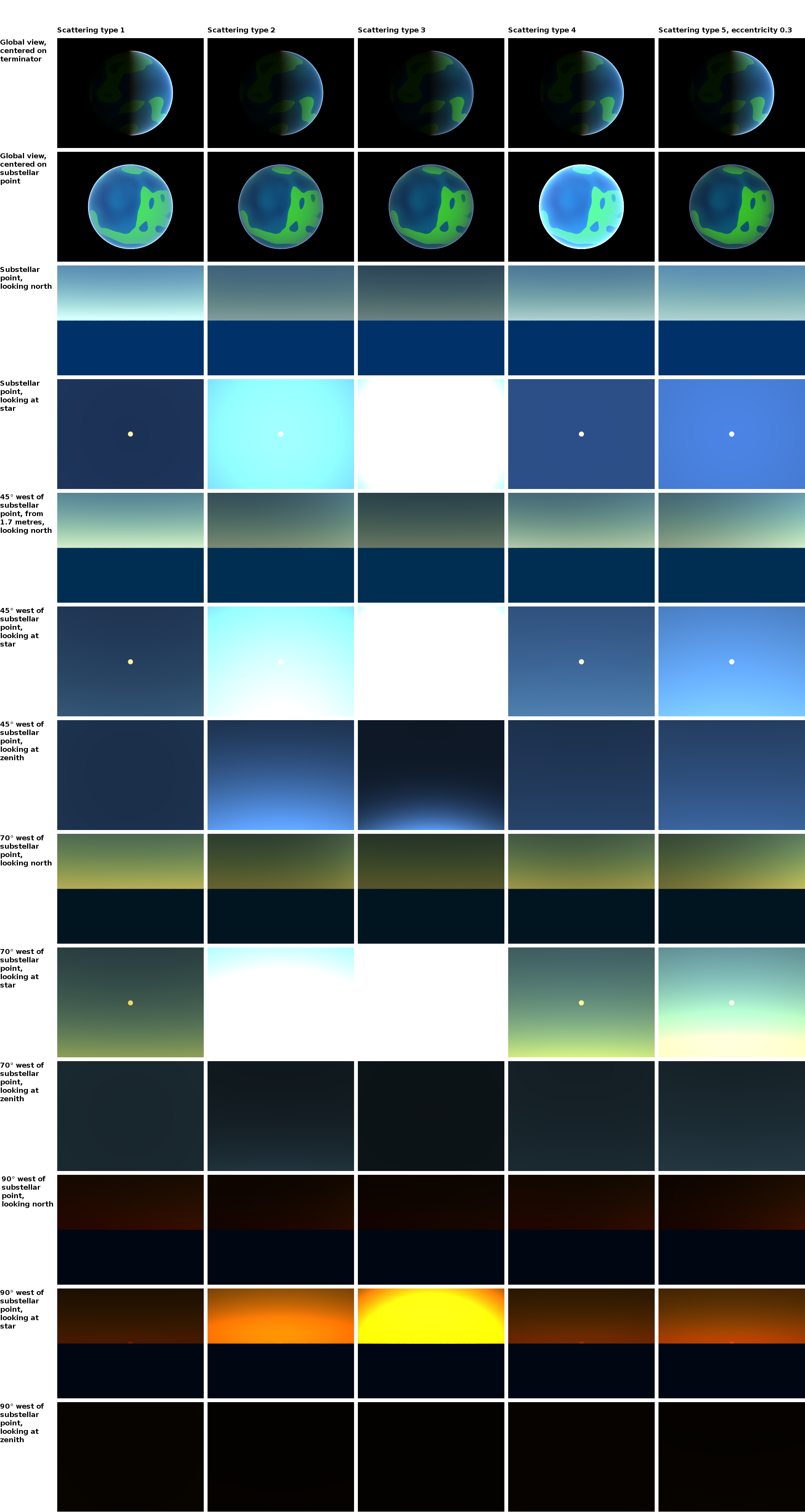

High!
To make testing easier, I resorted to a simple spherical "test planet"
and tried various camera positions and illumination angles with all five
scattering types (and yes, it wasn't media but the isosurface which
slowed down my renderings - now each scene took about 70 seconds!).
The simplified test planet is a sphere with a radius of 5,100 POV units
(1 unit equals 1 kilometre); the media is contained by a sphere with a
radius of 5,150 units. In all scenes, the illumnating star is a simple
point light; in all ground scenes (all scenes from row 3 on), the camera
is placed 0.0017 units above the planet's surface.
Method, samples and intervals settings are default (see code attached here).
The most striking flaw with all scattering types is the extremely dark
sky at low illumination angles - the sunrise looks like on Mars but not
like on a planet with Earth-like atmospheric pressure. Could using an
area light instead of a point light be helpful here? Or do I have to
fake the indirectly illuminated sky before dawn by using an additional
(shadowless) fill light source?
Reactor's suggestion of adding an absorbing component did not work at
all - regardless which ratios between scattering and absorbing, the sky
turned even darker!
Then, at medium illumination angels (~45 degrees), the otherwise pretty
realistic sky with scattering type 1 and 4 still turns too greenish
close to the horizon...
See you in Khyberspace!
Yadgar

Download '2010-04-11 atmospheric media tests 1 to 65.png' (745 KB)
Preview of image '2010-04-11 atmospheric media tests 1 to 65.png'

Your spherical pattern have a value of rgb<0.25, 0.5, 1> EVERYWHERE
outside a radius of 1. That means that the part that you can see only
have that value, as the surface is at a radius of 5140.
You may try scaling the media to the radius of it's container.
Add:
scale 5190
just after the density_map.

Have you looked at p.b.tutorials "TerraPOV - Sky system - Atmosphere" by
Bruno Cabasson?
I did use (a just slightly modified version) of his atmosphere and it
did work fairly well and realistic.
-Ive

There are various effects in the atmosphere which contribute
to scattering. Therefore, a single media statement may not be
enough to simulate all kinds of views.
Here is a sample with two media blocks (not a great atmosphere
but it shows how combine uniform and directional scattering so
you can get more control how it looks in various directions.
I also fixed the scale for spherical as Alain suggested, and
used a macro so you can see for which height above ground you
are actually specifying densities:

Perhaps one reason that pre-dawn and early dawn scenes look much darker
than what you're used to seeing in the real world is the fact that our
eyes adjust to darkness and brightness to bring all scenes to the
middle.  If things are too dark, our eyes adjust to make everything
brighter.
John
From: Ray Gardener
Subject: Re: Planetary atmosphere using media
Date: 15 Apr 2010 04:06:48
Message: <4bc6c918$1@news.povray.org>
> brighter.
fwiw I concur. In my own raytracer I got close, but getting consistent
coloration between different ground camera angles (pointing along the
ground, then pointing up at the sky's zenith, etc.) was wonky. Can be
tweaked for stills without reflections, but the moment you add a lake or
ocean, the colors would be wrong because the zenith sky would be partly
reflected while the camera is aiming at the horizon sky.
The problem turned out to be the color model. In RGB, it's hard or
perhaps intractable; in CIE it's easy because the color units are more
directly mapped to actual radiation wavelengths which the
scattering/absorption equations prefer, and tonemapping to handle eye
dark/light adaptation is easy too.
Ray

From: "Jérôme M. Berger"
Date: 15 Apr 2010 14:18:00
Message: <4bc75858@news.povray.org>
clipka wrote:
> Am 15.04.2010 11:07, schrieb Ray Gardener:
> Is that "CIE" as in "CIE RGB", "CIE XYZ", or "CIE L*a*b*"?
	You forgot "CIE L*u*v*". OTOH, what is "CIE RGB"?
		Jerome

From: clipka
Date: 15 Apr 2010 15:14:31
Message: <4bc76597@news.povray.org>
I also forgot "CIE xyY" and "CIE UVW" ;-)
CIE RGB is a wide-gamut RGB color space defined in 1931 based on
spectral colors, with R=700nm, G=546.1nm, B=435.8nm (the latter two are
mercury vapor spectral lines) and whitepoint E. At least that's what
Wikipedia claims.
From: Ray Gardener
Date: 23 Apr 2010 22:56:55
Message: <4bd25df7$1@news.povray.org>
CIE XYZ.
Ray
