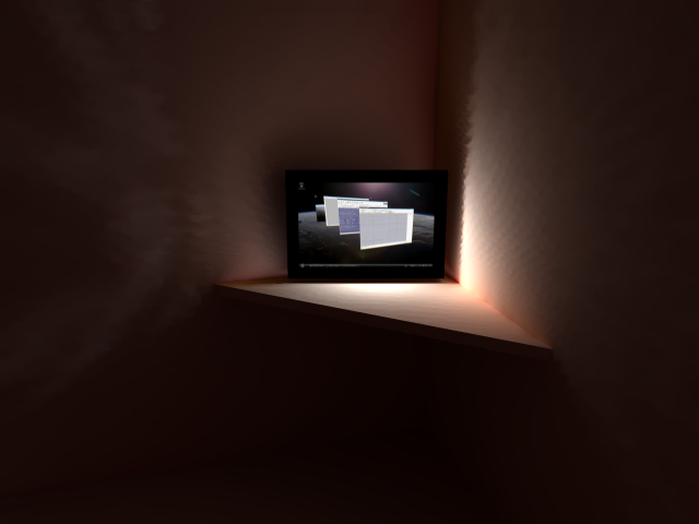

render time 1:18:08.  three noncoincident boxes containing df3s (red,
green, blue) for screen with emitting 10*each colour, 10 brightness
factor for radiosity, 1600 samples, 0.1 error bound, 4 recursion limit,
6 nearest count, 0.01 minimum reuse, 0 grey threshold.
Tim Cook
http://empyrean.freesitespace.net
Download 'df3 test.png' (116 KB)
Preview of image 'df3 test.png'

Huh.  I should try that.  Due to egging on from someone on 4chan's /3/
board, I bit the bullet and finally downloaded the latest beta and am
rendering a version with an image that has a better range of colours.
Holy crap 3.7 is faster than 3.5.  So much so that I decided to really
push the settings...
I dropped the brightness from 10 to 2, kept 1600 samples, dropped error
bound to 0.01, 0.005 minimum reuse, 20 nearest count (to keep the sharp
edge of the shadow from being all grainy), but lowered recursion limit to 2.
I wanted to show as much of the colour-bleed effect as possible, so had
to hunt around for a better image...I actually tried setting gray
threshold to less than 0 (shouldn't that in theory increase saturation?
  haha) but it only allows 0--1.  :(
It's coming along quite nicely.  The walls are a bit sluggish, but it
flies through the media itself like it's not even there.
I long for the day when I can use Moray in conjunction with this.
Tim Cook

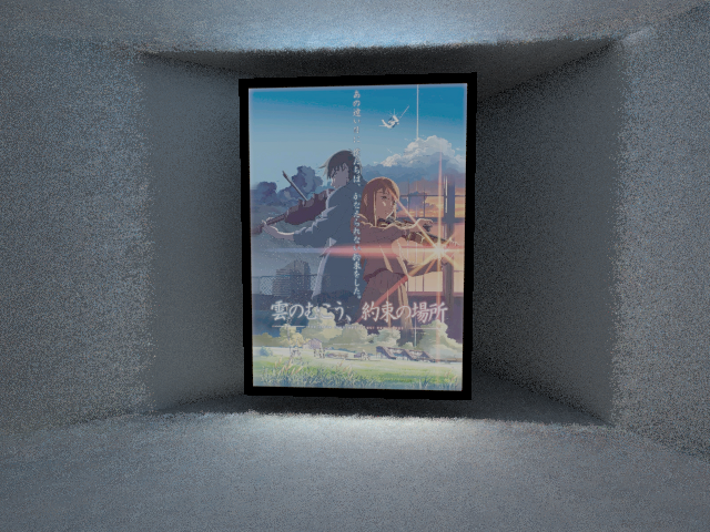

having a reasonable render time.  Here's the image...6:13:43 with the
adjusted settings, POV 3.7b36.
Tim Cook
Download '2010-03-16 df3 test 37b36.png' (273 KB)
Preview of image '2010-03-16 df3 test 37b36.png'

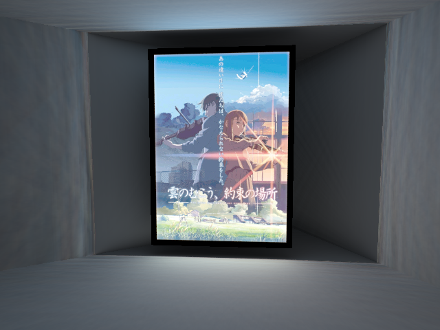

brightness 4
count 100
error_bound 0.2
minimum_reuse 0.15
nearest_count 10
recursion_limit 2
normal on
normal for walls {granite 0.5 scale 0.01}
render time 0:13:50
Tim Cook
Download '2010-03-16 df3 test2 37b36.png' (585 KB)
Preview of image '2010-03-16 df3 test2 37b36.png'

Tim Cook <z99### [at] gmailcom> wrote:
> brightness 4
> count 100
> error_bound 0.2
> minimum_reuse 0.15
> nearest_count 10
> recursion_limit 2
> normal on
> render time 0:13:50
That's terrible! Not the render time, of course, but the quality. Good AA
settings can eliminate most of that static.
I was running some tests yesterday, with OK results, but the render time was way
too high. I'll post the results after this message.
Sam

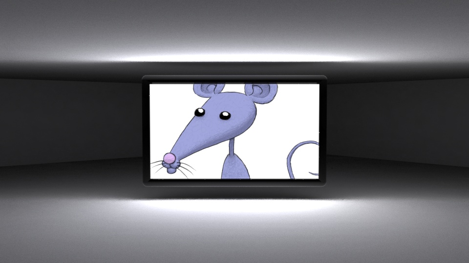

render options:
+a0.003 +am2 +r3
radiosity{
  count 1600 error_bound .2
  pretrace_start .08
  pretrace_end .02
  nearest_count 1
  recursion_limit 2
  normal on
  media on
  brightness 3
  gray_threshold 0
  adc_bailout 1/256
walls:
normal{bumps .5 scale .001}
This 960x540 image rendered in 2h:37m:49s.
Too long, IMO.
Download 'mouse2_37_49.jpg' (98 KB)
Preview of image 'mouse2_37_49.jpg'
