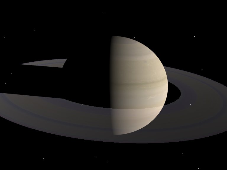

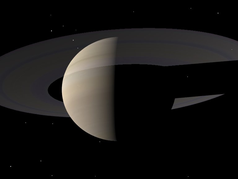

High!
After removing the absorption media, setting the extinction of the
scattering media to 0 and increasing the density_map's values by a
factor of 3000 (!), I at least got visible rings with a stark planet's
shadow on the lit side as well as on the unlit side, but they are both
too faint and too blue - and they cast no shadow on the planet!
The only way make them cast a shadow is to increase extinction and/or
adding an absorption medium - but whenever I try this, I got a shadow
cast by invisible rings!
HELP!!!
See you in Khyberspace!
Yadgar

They cannot cast a shadow, if they do not absorb light (since the extinction is
zero and there is no absorption).  You can either fake a shadow, by placing
another ring with the no_image keyword and allow it to cast a shadow, or you
could adjust the media to make it do both.
I am not sure what you mean by invisible rings that cast a shadow - they don't
show up against the planet or space in lit areas, but the shadow does?  Also,
increasing all of the density_maps values is equivalent to increasing the
scattering color (second parameter).  Can you post some of the code?

#end
// CELESTIAL SPHERE
Stars(6, image_width, camAng, 1.5) // invocation of starry sky sphere macro
#macro SetAxis(dec, ras) // macro for orienting planets
   rotate <bodies[3][4]-(90-dec), 0, 0>
   rotate <0, 90-ras, 0>
#end
light_source // Sun
   0
   color rgb 1
   looks_like
     sphere
       0, 1
       texture
        pigment { color rgb <1, 1, 0.85> }
        finish { ambient 1 diffuse 0 }
       scale bodies[0][1]/sc
       SetAxis(bodies[0][10], bodies[0][11])
// the following three image files can be obtained at
http://www.mmedia.is/~bjj/data/s_rings/index.html
#declare Saturn_Rings_Colors =
pigment
   image_map
     png "solarsys/sat_ring_color_bjoernjonsson.png"
#declare Saturn_Rings_Transparency =
pigment
   image_map
     png "solarsys/transparency_bjoernjonsson.png"
#declare Saturn_Rings_UnlitSide =
pigment
   image_map
     png "solarsys/unlitside_bjoernjonsson.png"
currently not yet working with media! (but that would be another thread
here!)
#declare Ring_Color_Map_1_to_255 =
     color_map
       #declare a=0;
       #while (a<255)
         #declare c=eval_pigment(Saturn_Rings_Colors, <2999/3000-a/1500,
0.5, 0>);
         #declare f=eval_pigment(Saturn_Rings_Transparency,
<2999/3000-a/1500, 0.5, 0>);
         [a*(((140390-74510)/140390)/1500) rgb c filter f.gray]
         #declare a=a+1;
       #end
#declare Ring_Color_Map_256_to_510 =
texture
   pigment
     cylindrical
     color_map
       #declare a=255;
       #while (a<510)
0.5, 0>);
         #declare a=a+1;
       #end
   finish { F_Saturn_Rings }
#declare Ring_Color_Map_511_to_765 =
texture
   pigment
     cylindrical
     color_map
       #declare a=510;
       #while (a<765)
0.5, 0>);
         #declare a=a+1;
       #end
#declare Ring_Color_Map_766_to_1020 =
texture
   pigment
     cylindrical
     color_map
       #declare a=765;
       #while (a<1020)
0.5, 0>);
         #declare a=a+1;
       #end
#declare Ring_Color_Map_1021_to_1275 =
texture
   pigment
     cylindrical
     color_map
       #declare a=1020;
       #while (a<1275)
0.5, 0>);
         #declare a=a+1;
       #end
#declare Ring_Color_Map_1276_to_1500 =
texture
   pigment
     cylindrical
     color_map
       #declare a=1275;
       #while (a<1500)
0.5, 0>);
         #declare a=a+1;
       #end
#declare Ring_UnlitSide_Map_1_to_255 =
texture
   pigment
     cylindrical
     color_map
       #declare a=0;
       #while (a<255)
         #declare c=eval_pigment(Saturn_Rings_UnlitSide,
         #declare a=a+1;
       #end
   finish { F_Saturn_Rings_UnlitSide }
#declare Ring_UnlitSide_Map_256_to_510 =
texture
   pigment
     cylindrical
     color_map
       #declare a=255;
       #while (a<510)
         #declare a=a+1;
       #end
#declare Ring_UnlitSide_Map_511_to_765 =
texture
   pigment
     cylindrical
     color_map
       #declare a=510;
       #while (a<765)
         #declare a=a+1;
       #end
#declare Ring_UnlitSide_Map_766_to_1020 =
texture
   pigment
     cylindrical
     color_map
       #declare a=765;
       #while (a<1020)
         #declare a=a+1;
       #end
#declare Ring_UnlitSide_Map_1021_to_1275 =
texture
   pigment
     cylindrical
     color_map
       #declare a=1020;
       #while (a<1275)
         #declare a=a+1;
       #end
#declare Ring_UnlitSide_Map_1276_to_1500 =
texture
   pigment
     cylindrical
     color_map
       #declare a=1275;
       #while (a<1500)
         #declare a=a+1;
       #end
// the actual planet and rings objects
union
sphere // Saturn
   0, 1
   texture
     pigment
       image_map
         jpeg "solarsys/saturn_bjoernjonsson.jpg" // also from
http://www.mmedia.is/~bjj/data/saturn/index.html
         map_type 1
         interpolate 2
     finish { F_Standard_Planetary_Surface }
   scale <bodies[72][1], bodies[72][2], bodies[72][3]>/sc
difference // rings
   cylinder
     <0, -0.11, 0>/sc, <0, 0.1, 0>/sc, 140390/sc
   cylinder
     <0, -0.12, 0>/sc, <0, 0.11, 0>/sc, 74510/sc
   // originally used with the no-media hi-res version of the rings -
I'm currently not sure whether I will able to make use of it also with
media!
   /* cylinder // unlit side!
     <0, -0.15, 0>/sc, <0, -0.1, 0>/sc, 150000/sc
     texture
       cylindrical
       texture_map
         [0                                   Ring_UnlitSide_Map_1_to_255 ]
         [255*(((140390-74510)/140390)/1500)  Ring_UnlitSide_Map_256_to_510]
         [510*(((140390-74510)/140390)/1500) Ring_UnlitSide_Map_511_to_765]
         [765*(((140390-74510)/140390)/1500) Ring_UnlitSide_Map_766_to_1020]
         [1020*(((140390-74510)/140390)/1500)
Ring_UnlitSide_Map_1021_to_1275]
         [1275*(((140390-74510)/140390)/1500)
Ring_UnlitSide_Map_1276_to_1500]
       scale 140390/sc
   // ultra-cheap no media version of the rings
   #if (lores)
     texture // low resolution texture: 255 entries in ring color map
       pigment
         cylindrical
         color_map
           #declare a=0;
           #while (a<255)
<509/510-a/255, 0.5, 0>);
             [a*(((140390-74510)/140390)/255) rgb c filter f.gray]
             #declare a=a+1;
           #end
         scale 140390/sc
   #else // current media problem!
     hollow
     pigment { rgbt 1 }
     interior
       media
         scattering
           5, 1
           eccentricity -0.4
           extinction 0
         density
           cylindrical
           // hi-res version (1500 color and transparency levels),
currently not usable with media (but please let's discuss this later on!)
           /* density_map
             [0                                   Ring_Color_Map_1_to_255]
             [255*(((140390-74510)/140390)/1500)  Ring_Color_Map_256_to_510]
             [510*(((140390-74510)/140390)/1500) Ring_Color_Map_511_to_765]
             [765*(((140390-74510)/140390)/1500) Ring_Color_Map_766_to_1020]
Ring_Color_Map_1021_to_1275]
Ring_Color_Map_1276_to_1500]
           // current media version
           density_map // preliminary low-res version
             #declare a=0;
             #while (a<255)
               [a*(((140390-74510)/140390)/255) rgb c*3000 /* filter
f.gray*/]
               #declare a=a+1;
              #end
            scale 11
   #end
   SetAxis(bodies[72][10], bodies[72][11])
   translate Pos_Saturn/sc
camera
   location camPos/sc
   look_at camLook/sc
   angle camAng
// end of code
Ring color and transparency maps are at
Yadgar

What I did notice is that, as best as I can tell, you are viewing the rings edge
on.  Does the media container show up when it isn't transparent?
The variable names are a little ambiguous, as such I could not tell the relative
thickness of the rings.  However, it seems like they are very thin.  Did you
already try increasing the scattering amount proportionally?
  good luck,
 -Reactor
From: Jörg 'Yadgar' Bleimann
Subject: Re: Finally, the rings are visible, but...
Date: 1 Dec 2009 13:02:26
Message: <4b155a32@news.povray.org>
High!
I didn't try yet... but will do so later this night (CET)!
Relative thickness is 200 metres!
> Did you
Yes, I just tried this, by setting the scattering amount to 10 - and I
got blazingly bright rings close to white-out, but still no shadow on
the planet! As general scattering amount and rgb values in the density
map are equivalent, there seems to be no point in trying the lower the
density values there instead...
And, yes, later this evening I will come up with a self-containing
Saturn scene to test for you! But first I have to do my daily Afghan
bodycount...
Yadgar
Date: 1 Dec 2009 16:53:49
Message: <4b15906d$1@news.povray.org>
High!
> bodycount...
Here it is:
pigment
   image_map
pigment
   image_map
union
sphere // Saturn
   0, 1
   texture
     pigment
       image_map
         map_type 1
         interpolate 2
   scale <bodies[1][1], bodies[1][2], bodies[1][3]>/sc
difference // rings
   cylinder
   cylinder
     hollow
     pigment { rgbt 1 }
     interior
       media
         scattering
           5, 10
           eccentricity -0.4
           extinction 0
         // absorption 0.
         density
           cylindrical
             #declare a=0;
             #while (a<255)
f.gray */ ]
               #declare a=a+1;
              #end
            scale 140390/sc
   SetAxis(bodies[1][10], bodies[1][11])
camera
   location camPos/sc
   look_at camLook/sc
   angle camAng
// end of code
Yadgar
