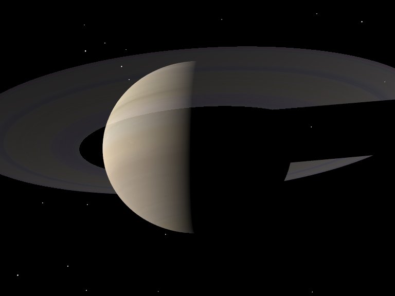

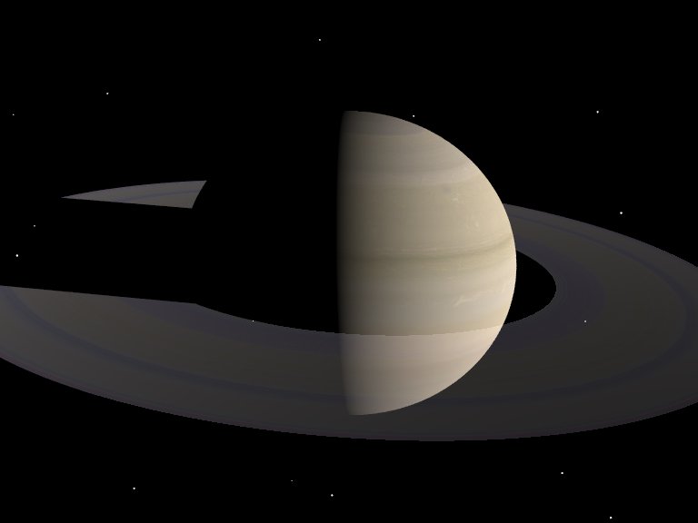

High!
After removing the absorption media, setting the extinction of the
scattering media to 0 and increasing the density_map's values by a
factor of 3000 (!), I at least got visible rings with a stark planet's
shadow on the lit side as well as on the unlit side, but they are both
too faint and too blue - and they cast no shadow on the planet!
The only way make them cast a shadow is to increase extinction and/or
adding an absorption medium - but whenever I try this, I got a shadow
cast by invisible rings!
HELP!!!
See you in Khyberspace!
Yadgar
Download '2009-11-29 saturn, take 10.jpg' (16 KB) Download '2009-11-29 saturn, take 11.jpg' (15 KB)
Preview of image '2009-11-29 saturn, take 10.jpg'
Preview of image '2009-11-29 saturn, take 11.jpg'

They cannot cast a shadow, if they do not absorb light (since the extinction is
zero and there is no absorption).  You can either fake a shadow, by placing
another ring with the no_image keyword and allow it to cast a shadow, or you
could adjust the media to make it do both.
I am not sure what you mean by invisible rings that cast a shadow - they don't
show up against the planet or space in lit areas, but the shadow does?  Also,
increasing all of the density_maps values is equivalent to increasing the
scattering color (second parameter).  Can you post some of the code?
-Reactor

Whenever I add even the slightest absorption media and/or extinction,
the rings simply disappear - but strangely, only now cast a shadow on
the planet!
Here is the code:

From: Jörg 'Yadgar' Bleimann
Subject: Re: Finally, the rings are visible, but...
Date: 1 Dec 2009 13:02:26
Message: <4b155a32@news.povray.org>
High!
Reactor wrote:
> What I did notice is that, as best as I can tell, you are viewing the rings edge
> on.  Does the media container show up when it isn't transparent?
I didn't try yet... but will do so later this night (CET)!
> The variable names are a little ambiguous, as such I could not tell the relative
> thickness of the rings.
Relative thickness is 200 metres!
> Did you
> already try increasing the scattering amount proportionally?
Yes, I just tried this, by setting the scattering amount to 10 - and I
got blazingly bright rings close to white-out, but still no shadow on
the planet! As general scattering amount and rgb values in the density
map are equivalent, there seems to be no point in trying the lower the
density values there instead...
And, yes, later this evening I will come up with a self-containing
Saturn scene to test for you! But first I have to do my daily Afghan
bodycount...
Yadgar
Date: 1 Dec 2009 16:53:49
Message: <4b15906d$1@news.povray.org>
High!

       scale bodies[0][1]/sc
       SetAxis(bodies[0][10], bodies[0][11])
#declare Saturn_Rings_Colors =
pigment
   image_map
     png "solarsys/sat_ring_color_bjoernjonsson.png"
#declare Saturn_Rings_Transparency =
pigment
   image_map
     png "solarsys/transparency_bjoernjonsson.png"
union
sphere // Saturn
   0, 1
   texture
     pigment
       image_map
         jpeg "solarsys/saturn_bjoernjonsson.jpg"
         map_type 1
         interpolate 2
     finish { F_Standard_Planetary_Surface }
   scale <bodies[1][1], bodies[1][2], bodies[1][3]>/sc
difference // rings
   cylinder
     <0, -0.11, 0>/sc, <0, 0.1, 0>/sc, 140390/sc
   cylinder
     <0, -0.12, 0>/sc, <0, 0.11, 0>/sc, 74510/sc
     hollow
     pigment { rgbt 1 }
     interior
       media
         scattering
           5, 10
           eccentricity -0.4
           extinction 0
         // absorption 0.
         density
           cylindrical
           density_map // preliminary low-res version
             #declare a=0;
             #while (a<255)
               #declare c=eval_pigment(Saturn_Rings_Colors,
<509/510-a/255, 0.5, 0>);
               #declare f=eval_pigment(Saturn_Rings_Transparency,
               [a*(((140390-74510)/140390)/255) rgb c*3000 /* filter
f.gray */ ]
               #declare a=a+1;
              #end
            scale 140390/sc
   SetAxis(bodies[1][10], bodies[1][11])
   translate Pos_Saturn/sc
camera
   location camPos/sc
   look_at camLook/sc
   angle camAng
// end of code
Yadgar
