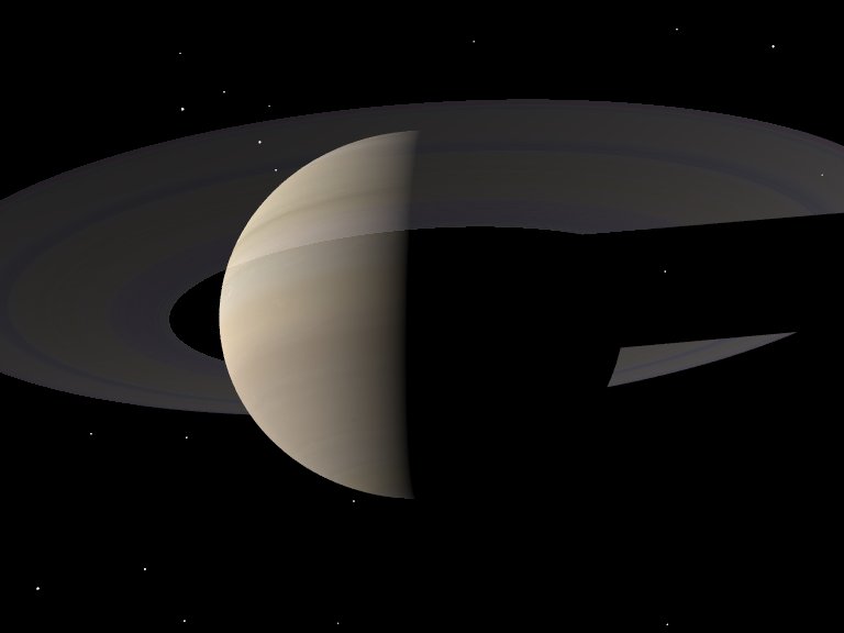

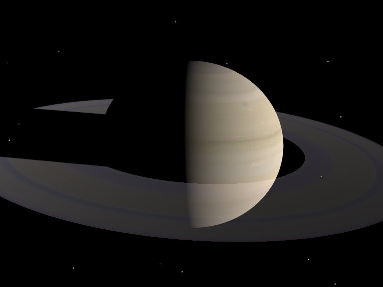

High!
After removing the absorption media, setting the extinction of the
scattering media to 0 and increasing the density_map's values by a
factor of 3000 (!), I at least got visible rings with a stark planet's
shadow on the lit side as well as on the unlit side, but they are both
too faint and too blue - and they cast no shadow on the planet!
The only way make them cast a shadow is to increase extinction and/or
adding an absorption medium - but whenever I try this, I got a shadow
cast by invisible rings!
HELP!!!
See you in Khyberspace!
Yadgar

They cannot cast a shadow, if they do not absorb light (since the extinction is
zero and there is no absorption).  You can either fake a shadow, by placing
another ring with the no_image keyword and allow it to cast a shadow, or you
could adjust the media to make it do both.
I am not sure what you mean by invisible rings that cast a shadow - they don't
show up against the planet or space in lit areas, but the shadow does?  Also,
increasing all of the density_maps values is equivalent to increasing the
scattering color (second parameter).  Can you post some of the code?
-Reactor

Whenever I add even the slightest absorption media and/or extinction,
the rings simply disappear - but strangely, only now cast a shadow on
the planet!
Here is the code:

#declare Saturn_Rings_Colors =
pigment
   image_map
     png "solarsys/sat_ring_color_bjoernjonsson.png"
#declare Saturn_Rings_Transparency =
pigment
   image_map
     png "solarsys/transparency_bjoernjonsson.png"
union
sphere // Saturn
   0, 1
   texture
     pigment
       image_map
         jpeg "solarsys/saturn_bjoernjonsson.jpg"
         map_type 1
         interpolate 2
     finish { F_Standard_Planetary_Surface }
   scale <bodies[1][1], bodies[1][2], bodies[1][3]>/sc
difference // rings
   cylinder
     <0, -0.11, 0>/sc, <0, 0.1, 0>/sc, 140390/sc
   cylinder
     <0, -0.12, 0>/sc, <0, 0.11, 0>/sc, 74510/sc
     hollow
     pigment { rgbt 1 }
     interior
       media
         scattering
           5, 10
           eccentricity -0.4
           extinction 0
         // absorption 0.
         density
           cylindrical
           density_map // preliminary low-res version
             #declare a=0;
             #while (a<255)
               #declare c=eval_pigment(Saturn_Rings_Colors,
<509/510-a/255, 0.5, 0>);
               #declare f=eval_pigment(Saturn_Rings_Transparency,
               [a*(((140390-74510)/140390)/255) rgb c*3000 /* filter
f.gray */ ]
               #declare a=a+1;
              #end
            scale 140390/sc
   SetAxis(bodies[1][10], bodies[1][11])
   translate Pos_Saturn/sc
camera
   location camPos/sc
   look_at camLook/sc
   angle camAng
// end of code
Yadgar

=?ISO-8859-1?Q?J=F6rg_=27Yadgar=27_Bleimann?= <yaz### [at] gmxde> wrote:
> High!
> Here it is:
The problem has to do with floating point accuracy limitations in the media
container.  This part here:
> #declare sc=13347; // 13347; // 1 POV unit = 13347 kilometres
does NOT go well with this part down here:
> difference // rings
>    cylinder
>    cylinder
The thickness of the rings is too small with respect to the rest of the scene.
I am sure it is the scientifically correct value, but there is a problem with
mixing such small and large values in a scene.  Interestingly enough, you should
be able to render the container shape with those dimensions without any
problems.  If you did that, you could use double_illuminate to make it look like
the media would.
If you want to use media, you will have to make the rings thicker and change
some of the sampling parameters.  This is the media block I used with visually
ok results.  I am not sure if the ring color and thickness is correct, but it
should be easy to tune at this point by changing the scattering extinction and
color values.
Ring code:
#local sc2 = 25; // new scale value for thickness only, as old
                 // scale value was too small.
difference // media rings
   cylinder
     <0, -0.11, 0>/sc2, <0, 0.1, 0>/sc2, 140390/sc
   cylinder
     <0, -0.12, 0>/sc2, <0, 0.11, 0>/sc2, 74510/sc
     hollow
     no_radiosity
     pigment { rgbt 1 }
     interior
       media
       samples 30
         scattering
           5, 150
           eccentricity -0.4
           extinction    0.4
         density
           cylindrical
             #declare a=0;
             #while (a<255)
               #declare c=eval_pigment(Saturn_Rings_Colors, <509/510-a/255, 0.5,
0>);
<c.red,c.green,c.blue>*f.gray ]
          /* you should be multiplying by f.gray, as it returns a transparency
             value from [0..1].
             Note that scattering media is inherently filtering, and the filter
             component of a color needn't be used.
               #declare a=a+1;
              #end
            scale 140390/sc
You can also test scaling the entire scene up by 100 units or so.  Consider this
thread here (web view)
http://news.povray.org/povray.general/thread/%3C47fa4f1b%241%40news.povray.org%3E/)
Anyway, hope that helps.  I rendered with those settings and got some ok
results, but the rings look rather different from camera 0 compared to camera 1.
 I think part of this is the media type, which has direction dependent
scattering, but this might mean you'll have to change sampling parameters
between angles if you want a certain look.
-Reactor
