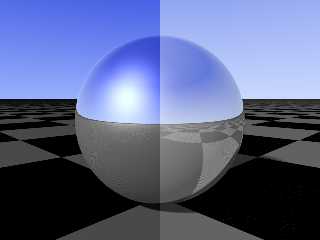

I guess you'll agree there's something wrong with the reflection on the
left side...
Although artificially constructed, this scene may serve to showcase how
raytracing computations can go wrong when ignoring gamma issues.
Left side was rendered with POV-Ray 3.6 with default settings (i.e.
without any gamma handling), right side was rendered with POV-Ray 3.7
defaults (i.e. full-fledged gamma handling); the only difference between
the scenes is in the brightness of the truly-grey squares, to roughly
preserve the percieved contrast to the black-and-white-striped squares
as seen on the unreflected plane (just as you would have to overhaul a
legacy scene if you want to render it with full gamma handling).
Download 'gammachecker_comparison.png' (103 KB)
Preview of image 'gammachecker_comparison.png'

No, what looks "right" can be quantified quite well: For instance, a
50%-intensity-grey should look exactly the same (when you squint your
eyes a bit, or otherwise "physically blur" what your display shows) as a
pattern of alternating black (0%) and white (100%) stripes.

> Or, better put, is the left or right side of your image "correct"?
As you can see (or /should/ see, unless your display an/or your image
viewing software is /totally/ screwed up), the left side shows a
checkered plane, but the reflection on the sphere does not. Can this
possibly be correct?
The right side may or may not look /perfectly/ correct, depending on
whether your display is perfectly calibrated or not, but if it is
/anywhere/ close to sanity, it /will/ look "much more correct" than the
left side (that's a physical fact, not just an assumption about your
personal visual perception).

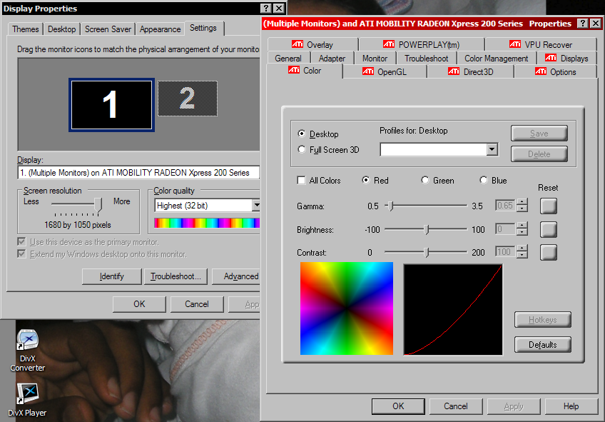

I am having lots of problems with gamma correction on my system. At least
there are a lot of iffy things.
Contrary to what has been posted here, my video card's driver seems to do
some gamma correction (Nvidea). At least I can do a some gamma correcting in
the setup. However, it is a lot of voodoo: I don't know for sure what is
corrected and when. I really don't see any difference.

I have this gamma control dialog box on my system.  I don't know whether it
applies gamma correction to the output signal, or controls the LCD itself,
though I suspect the former.
I've never seen one of these on a CRT based system, but that might well be an
artifact of history.
Download 'gamma_control.png' (206 KB)
Preview of image 'gamma_control.png'

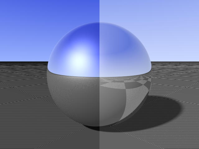

From: clipka
Subject: Re: Why is gamma-correction applied in povray, anyway?
Date: 5 Nov 2009 18:11:58
Message: <4af35bbe$1@news.povray.org>
TC schrieb:
> Thank you for the explanation - it surely beats wikipedia.
Thanks :-)
> I was referring to luminance, not to the reflection in the sphere. The
> brightness of the sky is very different, too. I meant: what is more correct
> (related to the sky) - luminence on the left or right?
That depends on how you prefer to interpret the color values in the
scene file.
I'd say both are wrong in this respect, because the original scene
author tried to achieve what can be seen on the left, but due to not
paying attention to gamma issues he ended up with parameters that result
in the image on the right when the computations are done properly.
> Of course reflection on the left makes more sense than on the right. Is this
> a gamma-related problem or is this an error in povray?
Whoops - are you mixing up left & right here?
It actually is a gamma-related problem, which in this case manifests
itself at the antialiasing step.
You could, with some legitimacy, also call this a design error in the
old POV-Ray versions (in this case 3.6 used with default parameters). It
is /not/ possible to produce the effect seen on the left-hand side with
POV-Ray 3.7, unless deliberately forcing it to enter 3.6-compatibility mode.
