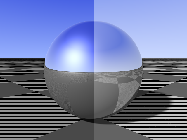

I guess you'll agree there's something wrong with the reflection on the
left side...
Although artificially constructed, this scene may serve to showcase how
raytracing computations can go wrong when ignoring gamma issues.
Left side was rendered with POV-Ray 3.6 with default settings (i.e.
without any gamma handling), right side was rendered with POV-Ray 3.7
defaults (i.e. full-fledged gamma handling); the only difference between
the scenes is in the brightness of the truly-grey squares, to roughly
preserve the percieved contrast to the black-and-white-striped squares
as seen on the unreflected plane (just as you would have to overhaul a
legacy scene if you want to render it with full gamma handling).
Download 'gammachecker_comparison.png' (103 KB)
Preview of image 'gammachecker_comparison.png'

No, what looks "right" can be quantified quite well: For instance, a
50%-intensity-grey should look exactly the same (when you squint your
eyes a bit, or otherwise "physically blur" what your display shows) as a
pattern of alternating black (0%) and white (100%) stripes.
> Is the "raw" povray output correct (in the sense of: does the output follow
> the laws of physics), or isn't it?
Sort of, yes. There are some features in it that don't /exactly/ follow
physics, but even those are designed to come as close as possible in the
/linear/ world.
> Does it >have< to be corrected?
Yes.
The 2.2 gamma curve is much closer to the dynamics of human perception
than linear color space; e.g. the difference between a 10%-intensity
grey and an 11%-intensity grey is percieved as far greater than between
a 90%-intensity grey and a 91%-intensity grey. Thus, for efficient
storage of image data, it makes sense to "compress" brighter colors and
instead "expand" darker colors, to make the most out of the bit depth.
This is called "gamma encoding".
For gamma-encoded images, a color depth of 8 bits per pixel is just
about enough to avoid visible color banding. With linear encoding on the
other hand, a color depth depth of 12 bits per pixel or more would be
needed to avoid banding artifacts in dark areas, while for brighter
regions some 6 bits per pixel would suffice.
Obviously, this is not very efficient, and since high-performace RAM
suitable for graphics card frame buffers used to be very expensive (and
still is to some extent), while a few additional lines of software code
are cheap, graphics hardware almost invariably used gamma encoding for
the frame buffers. Not to mention that it also fit so well with the
inherent gamma of CRTs, allowing both the graphics adaptor and CRT
display electronics to be pretty simple.
Therefore, even today, output devices are /not/ calibrated to achieve
/linear/ behavior, but to achieve some /standard/ gamma (typically 2.2
on PC systems, though the sRGB output curve is becoming more frequent),
which is then made known to (or silently assumed by) the image
processing software running on the system. Most operating systems have
either an official or at least a de-facto standard for the gamma
encoding to be used for data submitted to the display subsystem.
Of course, the same storage efficiency applying to graphics hardware is
of benefit for image file formats as well; for this reason, and because
image viewing software has a much easier job if all it needs to do is
shove the image file data into the display frame buffer, gamma encoding
(double featuring as pre-correction, and often exclusively interpreted
as such) has been the de-facto standard for virtually all 8-bit image
file formats out in the wild, and is explicitly recommended for the most
common formats nowadays.
Therefore, if POV-Ray would /not/ perform gamma pre-correction for the
preview display, it would go against operating system conventions; and
if it would /not/ perform gamma encoding / pre-correction for the output
file, it would go against de-facto and recommended standards of the
respective file format.
Note that for some file formats, POV-Ray does /not/ apply gamma
correction, namely Radiance HDR and OpenEXR, as both formats are defined
to encode linear light intensity data (which they can do efficiently
because they use floating-point-like data formats).
> Or, better put, is the left or right side of your image "correct"?
As you can see (or /should/ see, unless your display an/or your image
viewing software is /totally/ screwed up), the left side shows a
checkered plane, but the reflection on the sphere does not. Can this
possibly be correct?
The right side may or may not look /perfectly/ correct, depending on
whether your display is perfectly calibrated or not, but if it is
/anywhere/ close to sanity, it /will/ look "much more correct" than the
left side (that's a physical fact, not just an assumption about your
personal visual perception).
The only thing that could mess up this "experiment" would be a system
that ignores both color profile information and gAMA chunk present in
the image file, /and/ instead of exhibiting just some typical random
display gamma would happen to use linear color space. *Very* unlikely,
unless the person in charge of the system has no clue about color
management but thinks he/she does.
That, or you may be unable to squint your eyes; in that case, some
peculiarities about your visual perception might kick in and spoil it
all, but even that seems rather unlikely to me. As soon as you somehow
physically blur the image projected by the display (which is what
squinting your eyes does), the experiment /will/ work on every system
that is able to display PNG files at least /roughly/ right.

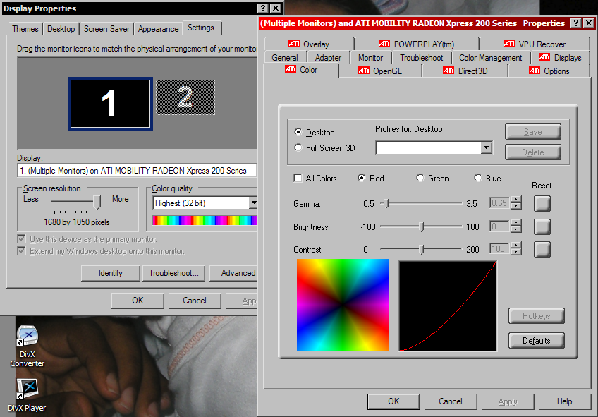

I am having lots of problems with gamma correction on my system. At least
there are a lot of iffy things.
Contrary to what has been posted here, my video card's driver seems to do
some gamma correction (Nvidea). At least I can do a some gamma correcting in
the setup. However, it is a lot of voodoo: I don't know for sure what is
corrected and when. I really don't see any difference.

I have this gamma control dialog box on my system.  I don't know whether it
applies gamma correction to the output signal, or controls the LCD itself,
though I suspect the former.
I've never seen one of these on a CRT based system, but that might well be an
artifact of history.
Download 'gamma_control.png' (206 KB)
Preview of image 'gamma_control.png'

TC schrieb:
> Thank you for the explanation - it surely beats wikipedia.
Thanks :-)
> I was referring to luminance, not to the reflection in the sphere. The
> brightness of the sky is very different, too. I meant: what is more correct
> (related to the sky) - luminence on the left or right?
That depends on how you prefer to interpret the color values in the
scene file.
I'd say both are wrong in this respect, because the original scene
author tried to achieve what can be seen on the left, but due to not
paying attention to gamma issues he ended up with parameters that result
in the image on the right when the computations are done properly.
> Of course reflection on the left makes more sense than on the right. Is this
> a gamma-related problem or is this an error in povray?
Whoops - are you mixing up left & right here?
It actually is a gamma-related problem, which in this case manifests
itself at the antialiasing step.
You could, with some legitimacy, also call this a design error in the
old POV-Ray versions (in this case 3.6 used with default parameters). It
is /not/ possible to produce the effect seen on the left-hand side with
POV-Ray 3.7, unless deliberately forcing it to enter 3.6-compatibility mode.
... which doesn't seem to be too uncommon, unfortunately.
Yes, I guess I know that tool. I used it, too, to calibrate my display.
This should actually "patch" some lookup table in the graphics hardware,
which maps 8-bit framebuffer values to values supplied to the ADC (to
generate the analog signal for the VGA interface) or transmitted on the
DVI interface.
