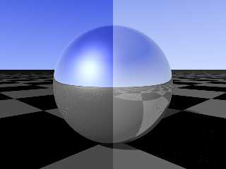

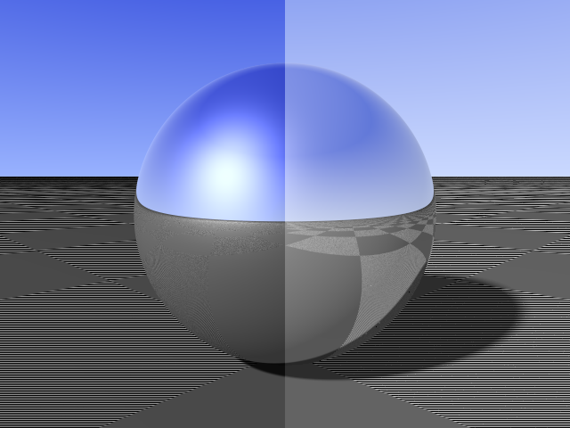

I guess you'll agree there's something wrong with the reflection on the
left side...
Although artificially constructed, this scene may serve to showcase how
raytracing computations can go wrong when ignoring gamma issues.
Left side was rendered with POV-Ray 3.6 with default settings (i.e.
without any gamma handling), right side was rendered with POV-Ray 3.7
defaults (i.e. full-fledged gamma handling); the only difference between
the scenes is in the brightness of the truly-grey squares, to roughly
preserve the percieved contrast to the black-and-white-striped squares
as seen on the unreflected plane (just as you would have to overhaul a
legacy scene if you want to render it with full gamma handling).
Download 'gammachecker_comparison.png' (103 KB)
Preview of image 'gammachecker_comparison.png'

> Or, better put, is the left or right side of your image "correct"?
As you can see (or /should/ see, unless your display an/or your image
viewing software is /totally/ screwed up), the left side shows a
checkered plane, but the reflection on the sphere does not. Can this
possibly be correct?
The right side may or may not look /perfectly/ correct, depending on
whether your display is perfectly calibrated or not, but if it is
/anywhere/ close to sanity, it /will/ look "much more correct" than the
left side (that's a physical fact, not just an assumption about your
personal visual perception).
The only thing that could mess up this "experiment" would be a system
that ignores both color profile information and gAMA chunk present in
the image file, /and/ instead of exhibiting just some typical random
display gamma would happen to use linear color space. *Very* unlikely,
unless the person in charge of the system has no clue about color
management but thinks he/she does.
That, or you may be unable to squint your eyes; in that case, some
peculiarities about your visual perception might kick in and spoil it
all, but even that seems rather unlikely to me. As soon as you somehow
physically blur the image projected by the display (which is what
squinting your eyes does), the experiment /will/ work on every system
that is able to display PNG files at least /roughly/ right.

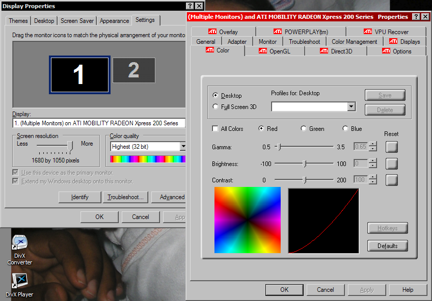

I am having lots of problems with gamma correction on my system. At least
there are a lot of iffy things.
Contrary to what has been posted here, my video card's driver seems to do
some gamma correction (Nvidea). At least I can do a some gamma correcting in
the setup. However, it is a lot of voodoo: I don't know for sure what is
corrected and when. I really don't see any difference.

From: Cousin Ricky
Subject: Re: Why is gamma-correction applied in povray, anyway?
Date: 5 Nov 2009 17:45:01
Message: <web.4af354fa6aedb0e878641e0c0@news.povray.org>
"scott" <sco### [at] scottcom> wrote:
> All monitors (all consumer ones at least) apply a gamma function to the
> incoming data before displaying it.  This is fixed, you cannot change this,
> it's just how they work (this was how CRTs worked, LCDs just copied them so
> everything looks the same as before).
> This is the whole point of why you *must* "gamma correct" data before
> sending it to the monitor (that just means applying the inverse of the
> monitor gamma function, so it cancels out).
> So, no, you don't need to "gamma correct" your monitor - that makes no sense
> at all.
I have this gamma control dialog box on my system.  I don't know whether it
applies gamma correction to the output signal, or controls the LCD itself,
though I suspect the former.
I've never seen one of these on a CRT based system, but that might well be an
artifact of history.
Download 'gamma_control.png' (206 KB)
Preview of image 'gamma_control.png'
From: clipka
Date: 5 Nov 2009 18:11:58
Message: <4af35bbe$1@news.povray.org>
TC schrieb:
> Thank you for the explanation - it surely beats wikipedia.
Thanks :-)
> I was referring to luminance, not to the reflection in the sphere. The
> brightness of the sky is very different, too. I meant: what is more correct
> (related to the sky) - luminence on the left or right?
That depends on how you prefer to interpret the color values in the
scene file.
I'd say both are wrong in this respect, because the original scene
author tried to achieve what can be seen on the left, but due to not
paying attention to gamma issues he ended up with parameters that result
in the image on the right when the computations are done properly.
> Of course reflection on the left makes more sense than on the right. Is this
> a gamma-related problem or is this an error in povray?
Whoops - are you mixing up left & right here?
It actually is a gamma-related problem, which in this case manifests
itself at the antialiasing step.
You could, with some legitimacy, also call this a design error in the
old POV-Ray versions (in this case 3.6 used with default parameters). It
is /not/ possible to produce the effect seen on the left-hand side with
POV-Ray 3.7, unless deliberately forcing it to enter 3.6-compatibility mode.
... which doesn't seem to be too uncommon, unfortunately.
Yes, I guess I know that tool. I used it, too, to calibrate my display.
This should actually "patch" some lookup table in the graphics hardware,
which maps 8-bit framebuffer values to values supplied to the ADC (to
generate the analog signal for the VGA interface) or transmitted on the
DVI interface.
> Now, I am using Corel quite a lot. Corel has a lot of colour correcting,
> too. I downloaded the proper colour-management system files for my monitor
> and my printer, respectively, but the printed result did not look much like
> the screen. The PDF-file I sent to my printer (I mean the real one, the guy
> who doesn't bother printing anything below 1000 copies ;-) did look like
> neither my printout, nor the screen.
I guess there's some caveat here: The monitor vendor doesn't know what
graphics card you are using, and how you set your display gamma.
> So I did trash all colour-correcting. All set to "ignore" - from video card
> driver to Corel to printer profile and printer driver. And behold: now I get
> on my printer what I see on my TFT and the guys at the printing press
> produce something that comes close enough to what I want.
I guess you just have to know exactly what you're doing in order to
benefit from color management. I for one don't, so I stick to plain old
gamma correction for now.
> So I am a bit distrustful of colour correction, especially when it is stored
> as a kind of optional parameter in the image-file, like in PNG. Depending on
> the respective viewer / editor, gamma correction in PNG is either ignored or
> applied. If it is applied, one only can hope it is applied correctly. This
> really is a problem. Do you know which browsers support PNG
> gamma-correction?
You can try yourself: Just render a POV-Ray scene to PNG using the 3.7
beta, once with File_Gamma=2.2 and once with File_Gamma=1.0.
Any software displaying both files identically (except maybe for a bit
of color banding in the File_Gamma=1.0 version) is doing proper gamma
handling.
Internet Explorer 8 does it right. The IC image viewer does, too, and
Windows Explorer's image preview likewise.
Photoshop 6.0 does it wrong (but I guess current versions do a better
job), and so does Microsoft Paint.
