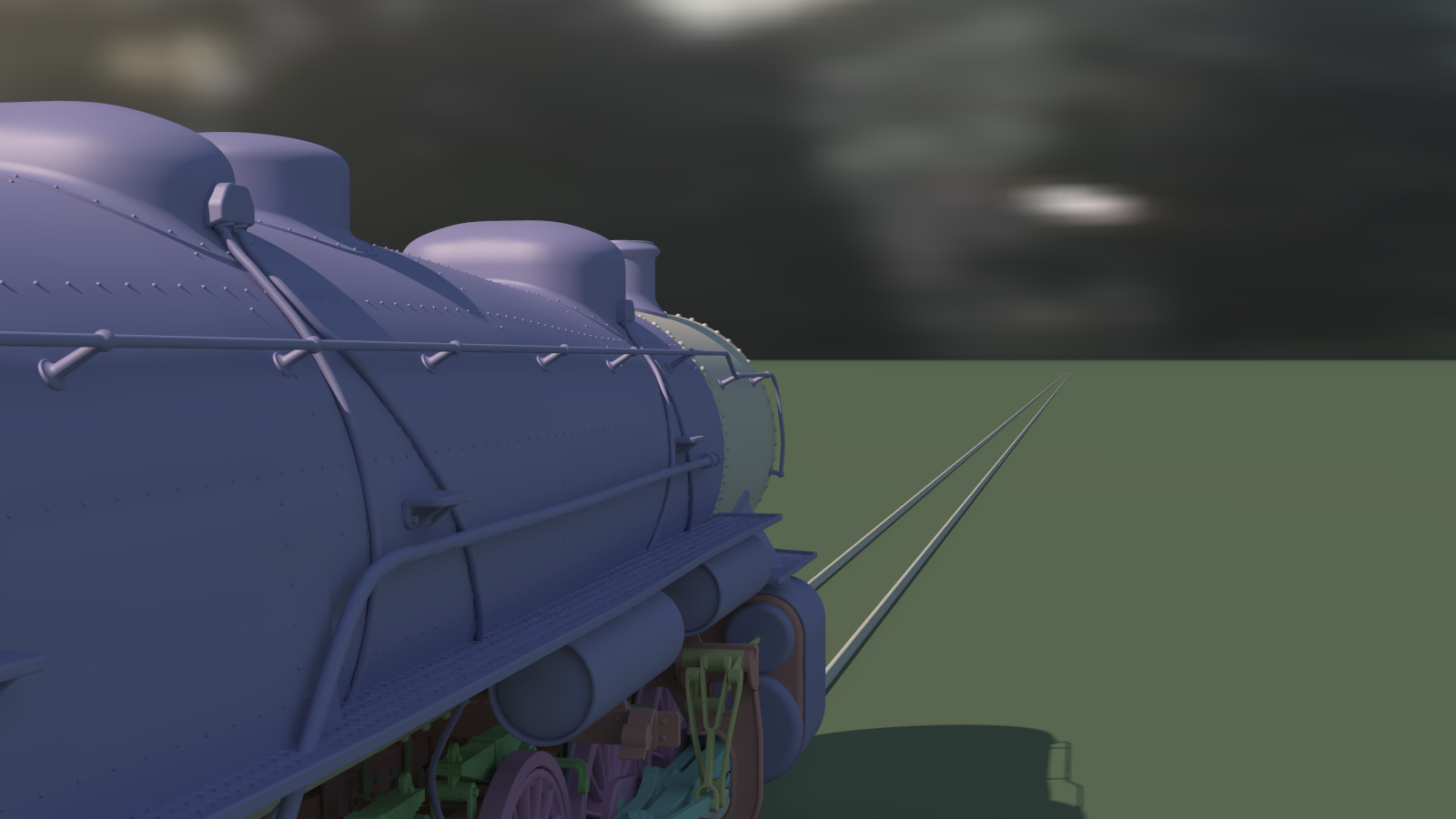

Added some more "steam greebles":
- Corrugated catwalks, handrails & treads
- Sand pipework
- Feedwater pipe
- Pressured air tanks
- Rivets, rivets and more rivets
Not perfectly authentic yet (e.g. the air tanks should actually go on
the left-hand side), but authenticity has to wait until after the
TINA-CHeP deadline (stay tuned on www.tc-rtc.co.uk).
Download 'steam 2009-10-17 1702.png' (462 KB)
Preview of image 'steam 2009-10-17 1702.png'

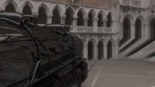

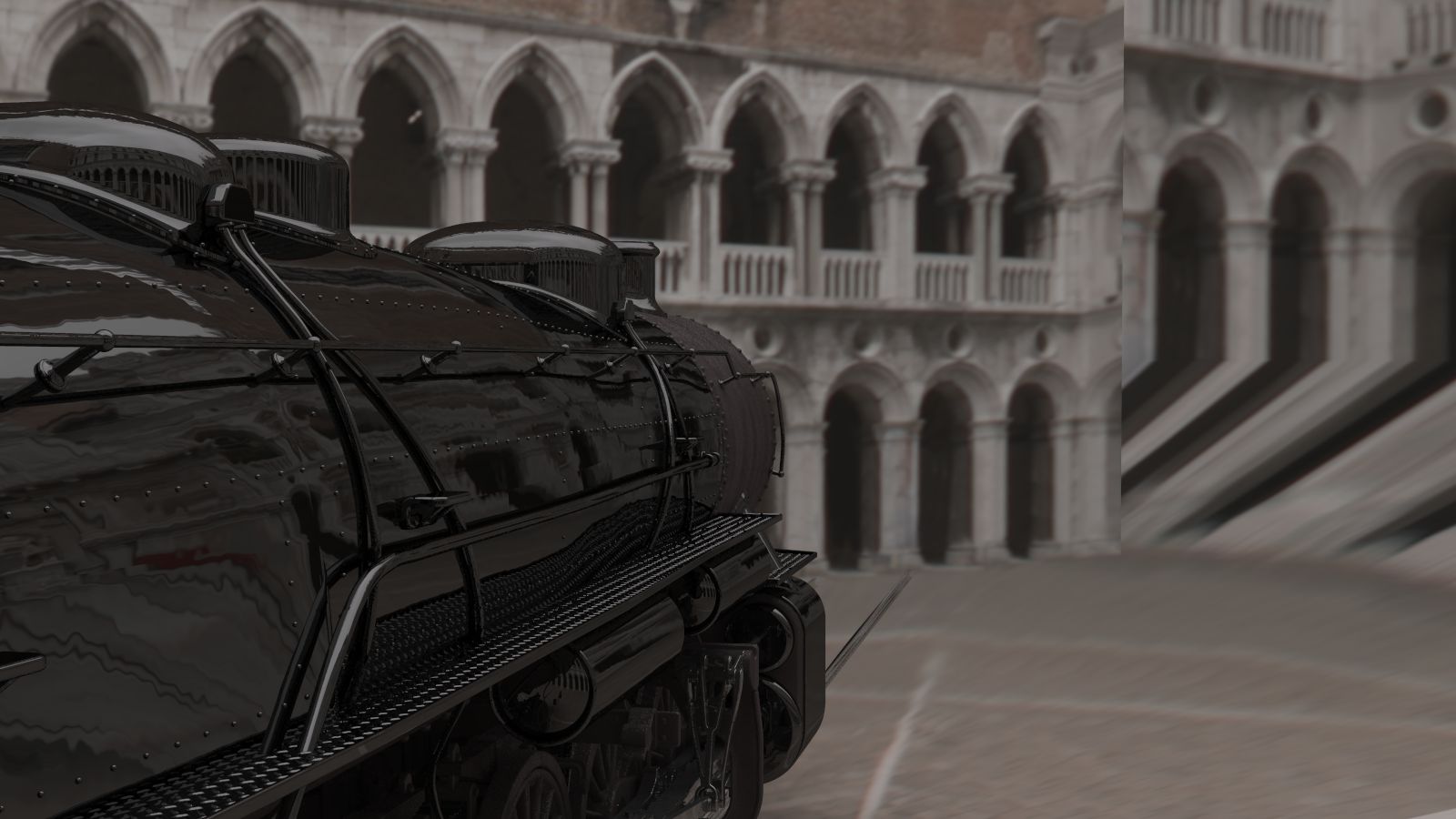

From: clipka
Subject: Re: Gotta catch that train
Date: 17 Oct 2009 12:03:05
Message: <4ad9eab9@news.povray.org>
... and on display at venice after a fresh paint job.
Download 'steam 2009-10-17 1757.jpg' (126 KB)
Preview of image 'steam 2009-10-17 1757.jpg'

From: SafePit
Date: 18 Oct 2009 12:40:01
Message: <web.4adb449b3d8eed9c1cb651830@news.povray.org>
I like the paint and imperfections of the surface.  Did you use a warp or other
finish to do that?
From: nemesis
Date: 18 Oct 2009 18:59:03
Message: <4adb9db7@news.povray.org>
that's so friggin' nice!
From: clipka
Date: 19 Oct 2009 01:49:59
Message: <4adbfe07@news.povray.org>
> finish to do that?
Thanks. The irregularities in the reflection are simply two overlayed
"bumps":
   normal {
     average
     normal_map {
       [1 bumps 0.01 scale  2.0*in ]
       [1 bumps 0.05 scale 20.0*in ]
where "in" is a distance equivalent to 1 inch in the model.
The rivets are just spheres.
The corrugated catwalk uses an isosurface based on a "bump map" image;
an actual bump map turned out to be problematic regarding the direction
of light (an old ailment of POV-Ray's bump mapping), and the isosurface
didn't bog down rendering time too much.
From: Shay
Date: 30 Oct 2009 14:25:51
Message: <4aeb2faf@news.povray.org>
> - Sand pipework
> - Feedwater pipe
Very nice, but as predicted loses something when "properly" textured. By
modeling in different colors, you revealed things that wouldn't be
present in a photograph or photo-realistic render.
This is important, I think, because so few things render or photograph
well. What looks good in flattened 3D? Relatively convex objects like
faces, buildings, and landscapes. That's it. Sure, you can find some
impressive 3D examples of other things, but compare those to 2D work of
the same subject and I'll bet you find the 3D lacking. A few years ago,
I ran across the CGTalk "Grand Space Opera" challenge which blew my mind
when I compared the 2D to 3D entries.
What's the problem with 3D? I believe there's a human tendency to
separate any image into positive and negative or light and dark space
(look at the difference in perspective one can gain from cropping a
render). A 2D artist can overcome this and create more spaces with his
complete control of localized contrast and "texture" of the flattened
image. A 3D artist could exercise more control than most do, but the
time required for extra light sources and experimentation is great.
Something I will continue to think on.
  -Shay
