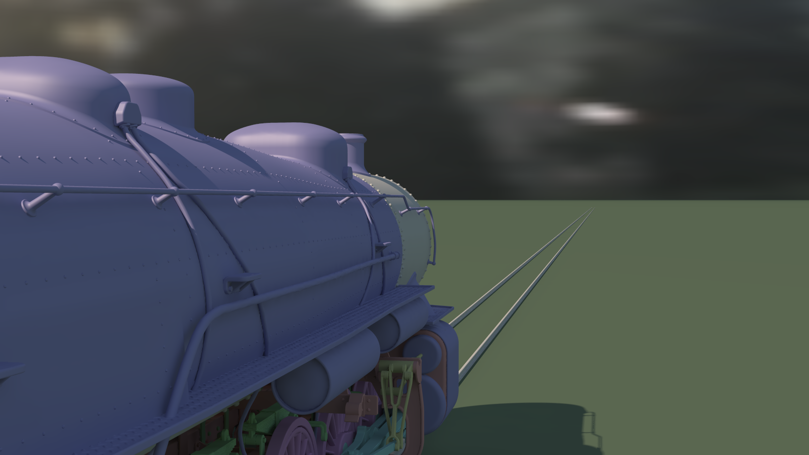

Added some more "steam greebles":
- Corrugated catwalks, handrails & treads
- Sand pipework
- Feedwater pipe
- Pressured air tanks
- Rivets, rivets and more rivets
Not perfectly authentic yet (e.g. the air tanks should actually go on
the left-hand side), but authenticity has to wait until after the
TINA-CHeP deadline (stay tuned on www.tc-rtc.co.uk).

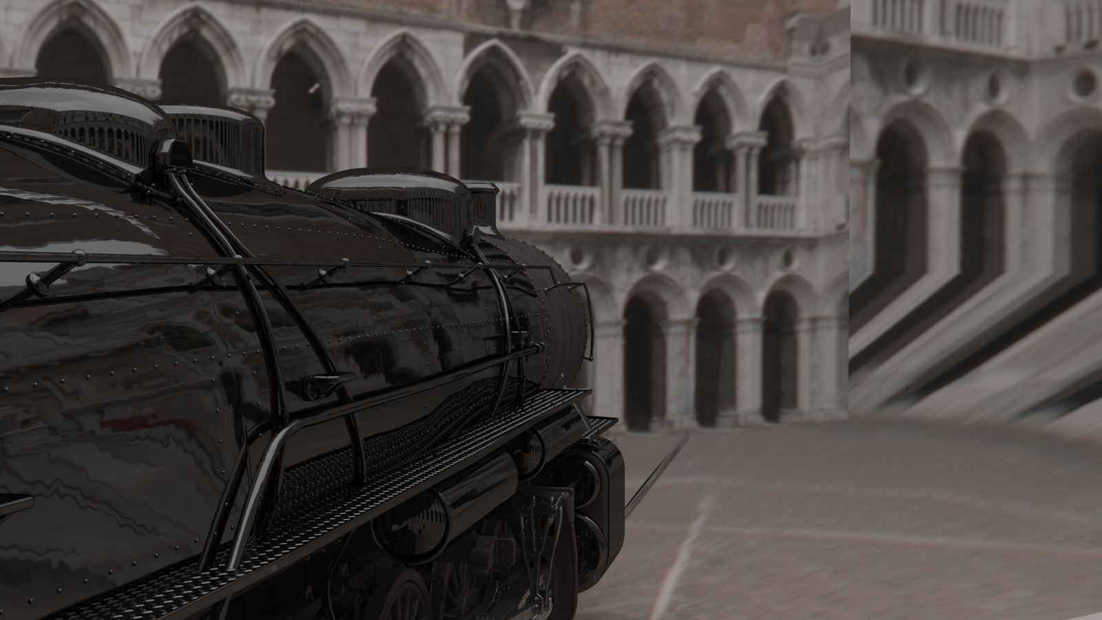

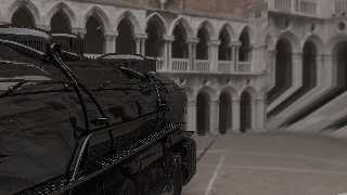

... and on display at venice after a fresh paint job.
You must rotate that HDR background. The seam is horrible.
Other than that, good job.
I just use it as a lighting stage, which is why I didn't bother.
I like the paint and imperfections of the surface.  Did you use a warp or other
finish to do that?
that's so friggin' nice!
> finish to do that?
Thanks. The irregularities in the reflection are simply two overlayed
"bumps":
   normal {
     average
     normal_map {
       [1 bumps 0.01 scale  2.0*in ]
       [1 bumps 0.05 scale 20.0*in ]
where "in" is a distance equivalent to 1 inch in the model.
The rivets are just spheres.
The corrugated catwalk uses an isosurface based on a "bump map" image;
an actual bump map turned out to be problematic regarding the direction
of light (an old ailment of POV-Ray's bump mapping), and the isosurface
didn't bog down rendering time too much.

Very nice, but as predicted loses something when "properly" textured. By
modeling in different colors, you revealed things that wouldn't be
present in a photograph or photo-realistic render.
