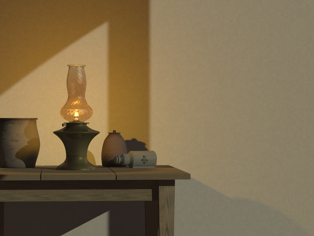

This is the brass lamp that I'd been working on for a while. I finally
solved the problems with the lamp globe.
Came up with the normal on the globe after working through Warps slope map
tutorial!
Jim
Download 'BrassLamp.png' (808 KB)
Preview of image 'BrassLamp.png'

Impressive! I guess the normal work on the globe really makes it.
BTW, what's that grey flask on the right? What would anyone build a
vessel like that for? (Needs some more beveling work around its resting
surface and where the box meets the cylinder, btw... the table could
also need some.)

My guess would be that it's a traditional solution to the thick gloopy
liquid problem, before squeezy bottles and upside-down ketchup bottles were
invented, so you don't have to wait while it makes its way all the way from
the bottom to the spout each time you want some?
Anywhere close?
Chris B.

Yes it does! The problem (you and discussed) with the globe was even though
I could see through the lath object, it was rendering the volume of the
object until I figured out how to close the spline.
> BTW, what's that grey flask on the right? What would anyone build a vessel
> like that for? (Needs some more beveling work around its resting surface
> and where the box meets the cylinder, btw... the table could also need
> some.)
The grey object on the right is a bed warmer .... fill it with hot water and
it goes between the sheets (down by your toes), and yes perhaps a little
more work is needed! It's a union of lathe object and a rounded box. Any
ideas how to smooth the transition from base to lathe object?
The table could probably use a little more normal work, but the edges ...
well I have this table in the shop, pretty crude primitive construction. The
methods of the period (c1840) never broke the edges like you're suggesting.
Not round legs either ... basic straight egdes and tapered ... pegged
together, NO NAILS!!!
Thanks!
Jim

Way off (ha-ha) ... it's a bed warmer!
Jim

I would describe it as an old fashioned or stone "hot water" bottle.
I'm not sure that I can describe it in English but I will try,
Add a cylinder that is tangential to the lathe object and the base and has a
radius that suits your model (This is easier when you use a modeller and you can
see where things touch. :P). Add a box where one face goes through the tangents
of the cylinder and lathe object at the top and the cylinder and base. Turn that
into a CSG difference (you may need to add extra boxes to clean it up) with the
cylinder subtracted from the box. You should now have an object that is a
"filler".
I've not tried it but it is the way I do these things.
Regards
     Stephen
Yes: Hard math :-P
I'll need a macro for linking rectangular blocks to cylinders, too, but
so far I haven't figured out the details yet. ATM I could only give you
an example of how to round off the edges on a linear polygon with
circular arcs, but although it's presumably a closely related problem,
it's not exactly the same.
Even without deliberate rounding, beveling or even sanding, boards will
/never/ have perfectly sharp edges - not to mention some deal of
involutary beveling by wear.
(That's why on my steam locomotive I'm actually beveling - or more
precisely, rounding off - /everyhing/ at least a tiny bit, even if it is
supposed to be machined steel instead of cast iron.)

Ok ... (clipka's and yours) inputs have started some ideas. I'll sit down
with a sheet of graph paper (this computer doesn't have POV) while I'm
watching the shop.
Cheers!
