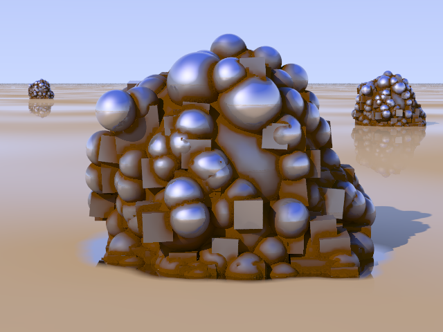

To accomplish its task efficiently, radiosity needs to keep track of how
far other objects are. Isn't it a shame to leave this information to
radiosity alone, when it would come in handy for a proximity pattern?
This shot is proof of that concept.
Download 'proximity.png' (276 KB)
Preview of image 'proximity.png'

   Very promising... I'm already impatient to try it. Indeed, the wet-sand
beach surface is also very nice, and intriguing.
jaime
I'm quite confident to finish it up in time for beta 35 ;-). ATM it only
works with texture maps - which of course is flexible enough, but I'd
prefer to make it work with pigment and normal maps, too. (No way of
making it work with pattern functions though. At least not as long as it
re-uses radiosity data.)
I came across the wet-beach idea by accident. It's basically just a bozo
texture map with a dry-beach (= diffuse only) and a wet-beach (= highly
reflective) texture. Except that I also did make use of that proximity
pattern to force the wet-beach texture in the proximity of "the Thing",
to give the illusion of a washed-out channel around it.

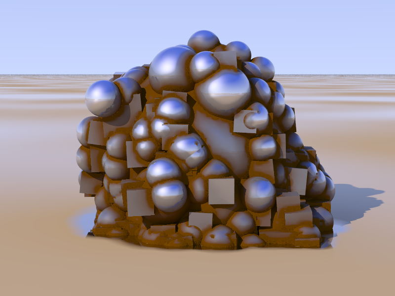

Samuel Benge schrieb:
> And a good proof it is! I do like proximity patterns :)
> To be truly useful though, the effect must be a pattern or a function so you can
> use it in any material block.
> Will the effect remain the same even if you change the camera settings?
I guess details may suffer when too far away from the camera (due to
radiosity code maintaining some maximum sample density, which depends on
distance from camera), but they'll just get less precise, and don't seem
to "shift" (that was a problem initially).
See attached shot.
One thing that bothers me though is that the proximity pattern is highly
sensitive to final-render-sampling artifacts, so it requires a
higher-resolution pretrace.
Download 'proximity.png' (215 KB)
That's good to know, since a shifting pattern can lose all semblance of realism
during animation.
> See attached shot.
It seems to behave itself well enough.
There's always a trade off somewhere :(
Sam
