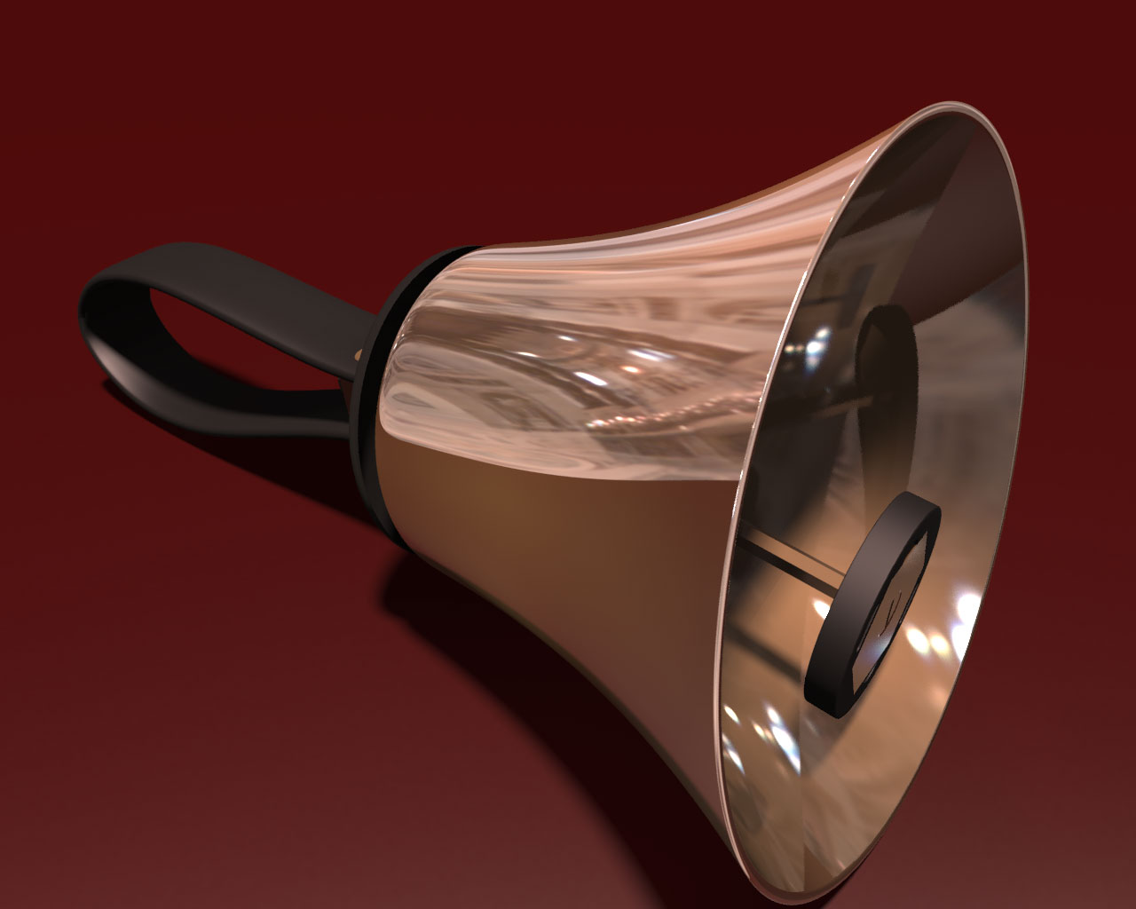

An image I've been working on for a few days.
Thanks to Chris B for pointing me to the SweepSpline macro, and thanks
to Mike Williams for actually making it. The handle is a swept object,
if it wasn't obvious.
Everything visible in this image is a superellipsoid, prism, lathe, or
swept spline, though a few cylinders were used for CSG.
As for the realism, the inside of the bell is too reflective but I
haven't been able to find a good way to make it dull/unpolished but yet
still look like clean metal. My attempts at micro and macro normals
(using variations of the textures that Ive posted in the metals.inc
thread a while ago) didn't work well, and there are very fine lines
between completely black, way-too-bright, and fuzzy.
Render time 2:06:31 on a quad-core 2.6GHz, beta33. Minor focal blur,
radiosity with decreased brightness, and area light used. I think the
line up the middle of the inside of the bell is a seam in the HDR probe
(which is St.Peter's Basilica from Paul Debevec's gallery), I will
rotate it once I have more changes to make.
CShake
Some ideas to try:
- As the bell's texture lives primarily from reflecting the light probe,
and nothing else does, blurring the probe instead of the texture surface
could to the trick.
- Add a bit of deformation to the bell, using pertubed normals (some
subtle bumps), to "break" the overly-ideal look of the bell.
- Use an averaged texture, with the major component as-is and another
one with significant micro normal pertubations, to simulate tiny
scratches in an otherwise well-polished surface.
- Maybe add a coat-of-arms or something, etched into the outside of the
bell.
You should also do something to the belt, to break up the "sterility".
Some leather-like crackle normals (with an offset value) maybe.
The clapper suffers from not having bevelled edges, maybe a cylindrical
shaft would do a lot better.
Appears a bit long to me. Then again, I'm not too familiar with
rendering times of spline-based shapes.
 > Minor focal blur,
I think it shows that you decreased radiosity brightness: It should be
stronger. I can't exactly pinpoint why, but maybe it's the way the bell
and the handle appear to be lit totally differently.
(just my $0.02)
 > I think the
Given the symmetry of that line, I'm pretty sure it's not in the light
probe, but the bell reflecting its own rim. Which in turn indicates that
the reflection is a bit too strong.
If you're using them right, the Devebec light probes are perfectly seamless.

clipka wrote:
> Some ideas to try:
> could to the trick.
Possible, but I'd like to make it possible to reuse the model in other
places, so blurring the background is something I'll leave as a last option.
I did that a bit on the inside (it's a slightly different finish/normal
but the same pigment), but evidently not enough. I am content with the
outside as-is, because a newly polished bell does look very close to
that. I'm going to try to add 'rings' on the inside though, as evidence
of the lathe tool used to shape the metal.
I haven't played with averaged textures yet, seems like a good thing to
look into.
> bell.
Not in the plan right now, but who knows.
It is supposed to be fairly smooth plastic, but it does need something.
I'm trying for realism in the model here, and the shapes of everything
are very close right now to what a real bell looks like. The shaft
actually is a hexagon, though I could round over the edges of the
clapper itself a little more.
>  > Minor focal blur,
> (just my $0.02)
I found that using rad brightness 1.0 made a huge bright glare on the
side of the bell, which also suggests that there is too much reflection.
Another reason the lighting is a bit odd is that I added a spotlight a
ways behind the camera to illuminate the inside, as increasing the
ambient of the light probe made the whole thing glow. Gotta reduce that
reflection I see now.
>  > I think the
>> probe (which is St.Peter's Basilica from Paul Debevec's gallery), I
>> will rotate it once I have more changes to make.
> seamless.
Right you are, I rotated the probe and got the same effect. I wasn't
sure though, since I had to convert it to spherical mapping in HDRShop,
as b33 doesn't support map_type 7.
Thanks for the input, I'll be working on it more.
For reference, this is the type of bell I'm trying to model:
http://www.schulmerichbells.com/products_hb_anatomy_of_handbell.php
CShake
Are you sure these things are produced on a lathe? I'd actually expected
them to be drawn.
For plastic it's quite an unusual color.
Are you using conserve_energy? If not, then you should.
Define "whole thing". Are you talking about the light probe, or the bell?
Expect HDRShop to make a perfect job, too. I never had any trouble
(except that I found I needed to flip left/right when using spherical
mapping with a converted probe instead of map type 7 with the original,
and I think it also needed some N*90 degrees of rotation).
From: clipka
Subject: Re: Handbell
Date: 18 Aug 2009 16:10:58
Message: <4a8b0ad2@news.povray.org>
> them to be drawn.
Hm, well, seems like they're typically cast, then finished up on a lathe
indeed.
