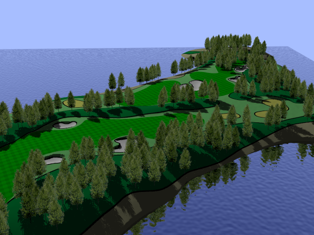

Hi all, thought I'd share the output of Leveller's recent changes to its
POV-Ray export -- textured billboards that auto-rotate to face the
camera during stills and animations, plus path-based camera motion.
http://www.daylongraphics.com/products/landshaper_golf/gallery/povray_flyover3.swf
(The water waves are animated, but it's not really evident because of
their far distance from the camera.)
Render speed was good; 2 hours for 240 frames of 512 x 384 on a single
thread in 3.6. Hope to get quad-core 3.7 benchmarks later on.
max_trace has to be set very high, but the number of billboards
intersecting an eye ray on average isn't great for a typical flyover.
Ray

From: Ray Gardener
Subject: Re: Animation with billboards
Date: 5 Jun 2009 16:09:44
Message: <4a297b88$1@news.povray.org>
Christian Froeschlin wrote:
> Nice. I suppose only the trees are billboards?
Thank you; yes.
> Can this technique produce shadows as well?
Yes, but the shadows look increasingly wrong when the lightsource is at
right angles to the viewing direction. The light "sees" the billboards
from the side instead of face-on. Ground-level renders fare better
because shadows get thin anyway, but overall I prefer to leave shadows off.
Shadows could probably be rendered in a separate pass by facing the
billboards at the light and then compositing them back, but there's a
point where the complexity of setting that up weighs against the
simplicity of just using actual geometry (and it defeats the point of a
raytracer to employ scanline-style workarounds). You could use cross
billboards too.
The savings in memory and bounding-tree traversal are probably not high
enough (or perhaps don't matter in these days of powerful hardware) to
use billboards primarily, but I find them very helpful when prototyping
because it's usually easier to get a picture than a model, and pictures
are more portable between different renderers, gallery building is easy,
etc. It's nice to have the option of dropping in billboards for any
models that I don't have available yet -- I can quickly storyboard a
scene, play with ideas, etc. before committing to making or finding the
real geometry.

From: Ray Gardener
Date: 6 Jun 2009 20:26:16
Message: <4a2b0928@news.povray.org>
Cousin Ricky wrote:
> Now that is one wicked water hazard!
Yep. The heightfield is actually based on part of a real course,
although I forget where exactly (the layout anyway; I had to guess at
the elevations). Some people like their holes challenging. :)
There aren't any water hazards actually in the line of play; it's just
on the surrounding perimeter. If you shank, on another course you'd be
deep in some bad rough anyway (or on another fairway).
Shadows coming out nice per Alain's suggestion (attached image), the
video is about halfway rendered. I added 'no_reflection' to the
light-facing billboards as well to keep reflections matched to the
cam-facing boards.
Ray
Download 'animtest102.png' (392 KB)
Preview of image 'animtest102.png'
From: Ray Gardener
Date: 6 Jun 2009 21:56:42
Message: <4a2b1e5a@news.povray.org>
Same animation, with shadows:
http://www.daylongraphics.com/products/landshaper_golf/gallery/povray_flyover4.swf
Ray
Date: 7 Jun 2009 10:54:01
Message: <4a2bd489$1@news.povray.org>
Ray Gardener nous illumina en ce 2009-06-06 20:27 -->
> cam-facing boards.
> Ray
Now, the only thing that can tip you is that the bilboards don't self shadow.
Most peoples won't notice that, it's minimised by the actual texture and the
shadows from the other ones.
From: Darren New
Date: 7 Jun 2009 12:46:19
Message: <4a2beedb$1@news.povray.org>
Very nice. You have to look very close to tell the trees are billboards.
   Darren New, San Diego CA, USA (PST)
