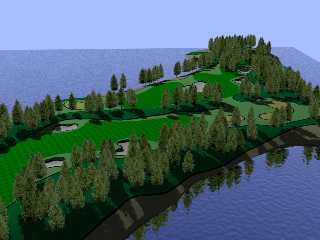

Hi all, thought I'd share the output of Leveller's recent changes to its
POV-Ray export -- textured billboards that auto-rotate to face the
camera during stills and animations, plus path-based camera motion.
http://www.daylongraphics.com/products/landshaper_golf/gallery/povray_flyover3.swf
(The water waves are animated, but it's not really evident because of
their far distance from the camera.)
Render speed was good; 2 hours for 240 frames of 512 x 384 on a single
thread in 3.6. Hope to get quad-core 3.7 benchmarks later on.
max_trace has to be set very high, but the number of billboards
intersecting an eye ray on average isn't great for a typical flyover.
Ray
From: Christian Froeschlin
Subject: Re: Animation with billboards
Date: 5 Jun 2009 10:36:39
Message: <4a292d77$1@news.povray.org>
Nice. I suppose only the trees are billboards?
Can this technique produce shadows as well?

From: Ray Gardener
Date: 5 Jun 2009 16:09:44
Message: <4a297b88$1@news.povray.org>
Thank you; yes.

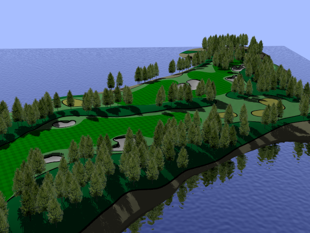

Yes, but the shadows look increasingly wrong when the lightsource is at
right angles to the viewing direction. The light "sees" the billboards
from the side instead of face-on. Ground-level renders fare better
because shadows get thin anyway, but overall I prefer to leave shadows off.
Shadows could probably be rendered in a separate pass by facing the
billboards at the light and then compositing them back, but there's a
point where the complexity of setting that up weighs against the
simplicity of just using actual geometry (and it defeats the point of a
raytracer to employ scanline-style workarounds). You could use cross
billboards too.
The savings in memory and bounding-tree traversal are probably not high
enough (or perhaps don't matter in these days of powerful hardware) to
use billboards primarily, but I find them very helpful when prototyping
because it's usually easier to get a picture than a model, and pictures
are more portable between different renderers, gallery building is easy,
etc. It's nice to have the option of dropping in billboards for any
models that I don't have available yet -- I can quickly storyboard a
scene, play with ideas, etc. before committing to making or finding the
real geometry.
Joerg Schrammel's (Genesis Toolkit) work with textured cones is a neat
in-between approach, which requires less (or no) camera-facing of trees
and can cast reasonable shadows. The downside is that the textures are a
little trickier to set up.
Mixing geometry with billboards is done to good effect for some trees.
Trunk and branches are 3D but leaf clusters are billboards. They are
rotated fully to camera-face (not just around the Y axis), and it's easy
to sway them in animations to simulate wind. They also light better.
Date: 6 Jun 2009 11:14:41
Message: <4a2a87e1$1@news.povray.org>
Ray Gardener nous illumina en ce 2009-06-05 16:10 -->
> Thank you; yes.
> billboards too.
> real geometry.
You can have the shadows and the bilboards in one pass.
Just double the billboards. One set always faces the camera and is set to no_shadow.
The second set is set to face the light and is set to no_image.
From: Ray Gardener
Date: 6 Jun 2009 17:46:45
Message: <4a2ae3c5@news.povray.org>
>> Thank you; yes.
>> at right angles to the viewing direction. The light "sees" the
>> billboards from the side instead of face-on. Ground-level renders fare
>> better because shadows get thin anyway, but overall I prefer to leave
>> shadows off.
>> a raytracer to employ scanline-style workarounds). You could use cross
>> billboards too.
>> high enough (or perhaps don't matter in these days of powerful
>> hardware) to use billboards primarily, but I find them very helpful
>> when prototyping because it's usually easier to get a picture than a
>> model, and pictures are more portable between different renderers,
>> gallery building is easy, etc. It's nice to have the option of
>> dropping in billboards for any models that I don't have available yet
>> -- I can quickly storyboard a scene, play with ideas, etc. before
>> committing to making or finding the real geometry.
>> trees and can cast reasonable shadows. The downside is that the
>> textures are a little trickier to set up.
>> easy to sway them in animations to simulate wind. They also light better.
> to no_shadow.
Hey, yeah, thanks, I'll try that.
Ray

Shadows coming out nice per Alain's suggestion (attached image), the
video is about halfway rendered. I added 'no_reflection' to the
light-facing billboards as well to keep reflections matched to the
cam-facing boards.
Ray
Download 'animtest102.png' (392 KB)
Preview of image 'animtest102.png'
From: Ray Gardener
Date: 6 Jun 2009 21:56:42
Message: <4a2b1e5a@news.povray.org>
Same animation, with shadows:
http://www.daylongraphics.com/products/landshaper_golf/gallery/povray_flyover4.swf
Ray

Now, the only thing that can tip you is that the bilboards don't self shadow.
Most peoples won't notice that, it's minimised by the actual texture and the
shadows from the other ones.
Very nice. You have to look very close to tell the trees are billboards.
