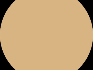

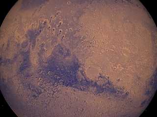

To implement a LOD (level of detail) system for large surface textures
of planets in my Solar System model, I started with testing the FOV
width in POV units corresponding to camera distance and angle.
As the horizontal image width (in POV units) as
camera_distance*tan(angle/2), a sphere with a radius of 3396.2 units
(the planet Mars) should exactly fit into the camera window when viewed
from a distance of 9330.982812 units - but instead the planet's disc is
still too large for the image (see attachment)! Obviously, "angle 40"
does not give really a 40-degree FOV, but a somewhat narrower one... or
what else did I get wrong?
See you on www.khyberspace.de!
Yadgar
Download '2009-05-03 mars, take 3.jpg' (102 KB)
Preview of image '2009-05-03 mars, take 3.jpg'

  Did you take into account perspective? You are not using a disc, but a
sphere, and perspective will make the half of the sphere closer to the
camera be larger than the "disc" at that exact distance.
  You should try it with a true disc object instead.

From: clipka
Subject: Re: Viewing geometry problem
Date: 4 May 2009 06:25:00
Message: <web.49fec16ac9b881af451fd6cd0@news.povray.org>
> I don't think the spherical shape would have *that much* of an effect.
We're talking about a ratio of distance vs. radius of roughly 2:1. At that
distance, we're talking about roughly 10-15% "overshoot" (didn't bother to
calculate it, just drew a picture instead and measured), which would fit the
bill quite well it seems.

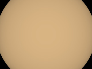

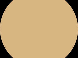

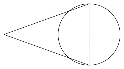

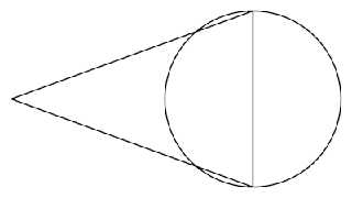

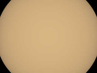

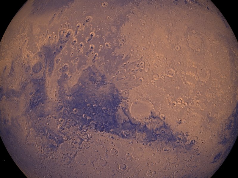

Oh, but it does.  Please find attached the view of a sphere using Yadgar's
numbers, the view of a disc with the same geometry, and a diagram of the
geometry.
<Insert witty .sig here>
Download 'yadgar-sphere.jpg' (6 KB) Download 'yadgar-disc.jpg' (6 KB) Download 'yadgar-geometry.png' (15 KB)
Preview of image 'yadgar-sphere.jpg'
Preview of image 'yadgar-disc.jpg'
Preview of image 'yadgar-geometry.png'

Wow, that's a lot more than I would have expected. I guess the camera is pretty
close (relatively). Thanks for the illustration!

To see what's going on,
1) Draw a circle.
2) Draw a line dividing the circle into equal halves.
3) Select a point on either side, outside of the circle.
4) Draw two lines, one going from the point you chose in step three to
each of the ends of the circle's diameter.
You will observe that one or both of the lines from step 4 intersect the
circle before reaching the end of the diameter.

From: Jellby
Date: 8 May 2009 13:40:04
Message: <7g5ed6-q79.ln1@badulaque.unex.es>
Among other things, sooperFoX saw fit to write:
If r is the radius of the sphere/disc and d is the distance from its center
to the camera, then the angle occupied by a disc is:
alpha = atan (r/d)
while the angle occupied by a sphere is:
beta = asin (r/d)
The smaller r/d the more similar alpha and beta are, but alpha is always
smaller than beta, and for r/d=0.5:
