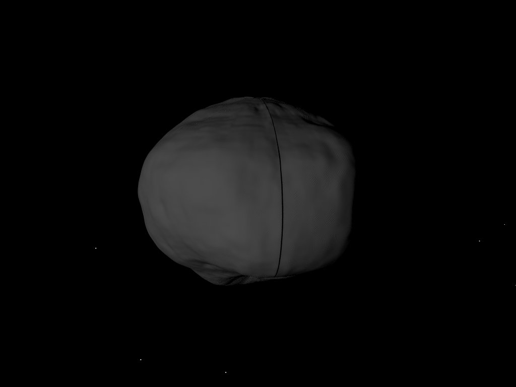

Now I'm rid of the clippings... but then, I noticed an ugly gap in
Phobos' surface (see attachment). I thought this might be because of not
having connected the ends of each stripe of mesh faces (corresponding to
lines in the original map image), so I changed my code:

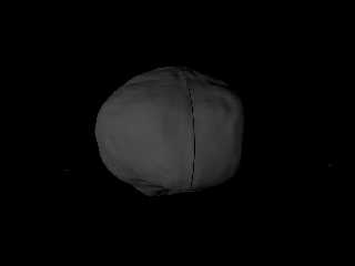

From: Jörg 'Yadgar' Bleimann
Subject: Re: Am I just too stupid for programming?!?
Date: 20 Apr 2009 07:27:01
Message: <49ec5c05@news.povray.org>
clipka wrote:
> No, I don't see attachment :P
Here it is:
Download '2009-04-20 phobos, take 2.jpg' (14 KB)
Preview of image '2009-04-20 phobos, take 2.jpg'

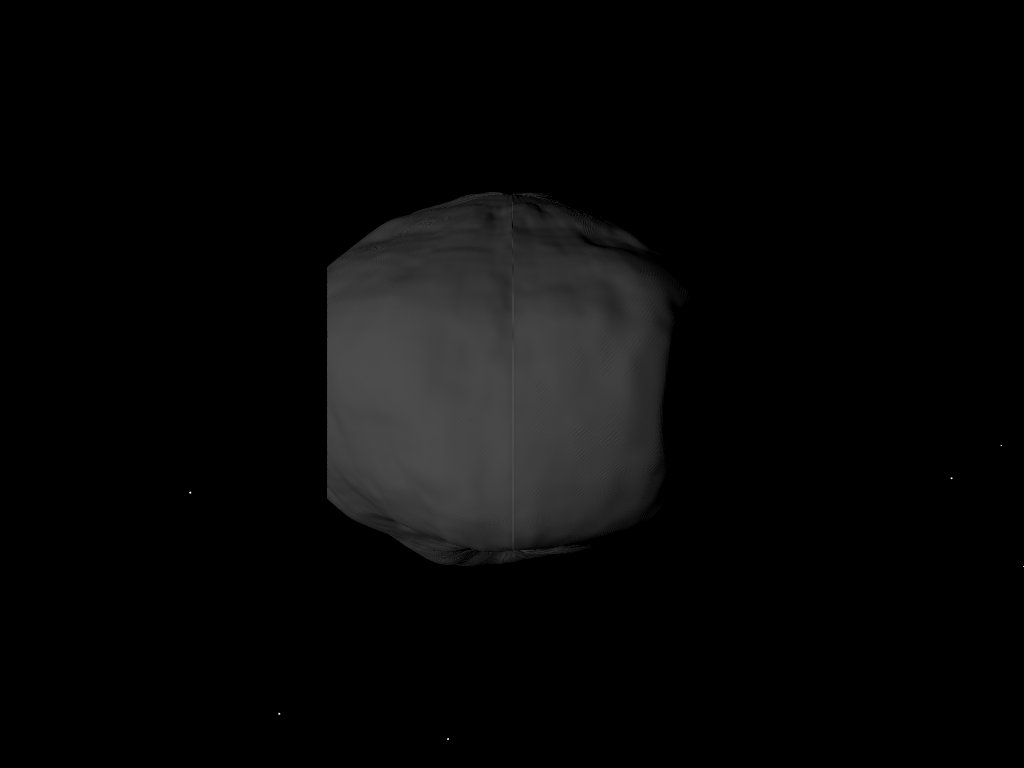

Date: 20 Apr 2009 08:35:02
Message: <49ec6bf6@news.povray.org>
High!
I must have placed one #end statement too much within my nested loop - I
removed it, and now it runs! At least the meridional gap is (almost)
gone, but as you can see in the latest image below, Christoph was right
in assuming that altering the scaling divisor won't help in the long run!
Onward to the next issue... the bounding problem!
See you in Khyberspace!
Yadgar
