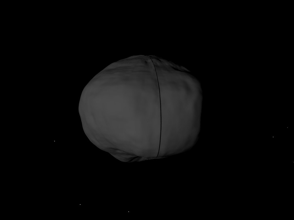

Now I'm rid of the clippings... but then, I noticed an ugly gap in
Phobos' surface (see attachment). I thought this might be because of not
having connected the ends of each stripe of mesh faces (corresponding to
lines in the original map image), so I changed my code:
   face_indices
     638398 // added (399-1)*2 = 796
     #declare a=0;
     #while (a<399)
       #declare b=0;
       #while (b<800) // runs now to 800 rather than 799
         <a*800+b, a*800+b+1, (a+1)*800+b>, // line 313
         #if (b=799 & a=398)
           <319999, 319200, 318400> // last triangle
         #else
           <(a+1)*800+b, (a+1)*800+b+1, a*800+b+1>,
         #end
         #declare b=b+1;
       #end
       #declare a=a+1;
     #end
...but all I get is the error message
"Parse Error: No matching } in 'face_indices', < found instead" (in line
313)!!!
See you in Khyberspace!
Yadgar

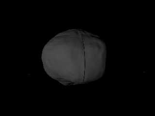

From: Jörg 'Yadgar' Bleimann
Subject: Re: Am I just too stupid for programming?!?
Date: 20 Apr 2009 07:27:01
Message: <49ec5c05@news.povray.org>
clipka wrote:
> No, I don't see attachment :P
Here it is:
Download '2009-04-20 phobos, take 2.jpg' (14 KB)
Preview of image '2009-04-20 phobos, take 2.jpg'

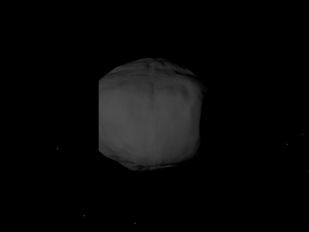

Date: 20 Apr 2009 08:35:02
Message: <49ec6bf6@news.povray.org>
High!
I must have placed one #end statement too much within my nested loop - I
removed it, and now it runs! At least the meridional gap is (almost)
gone, but as you can see in the latest image below, Christoph was right
in assuming that altering the scaling divisor won't help in the long run!
Onward to the next issue... the bounding problem!
Yadgar
