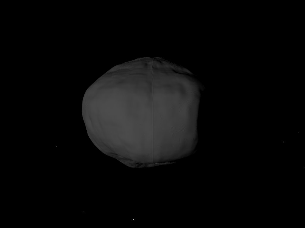

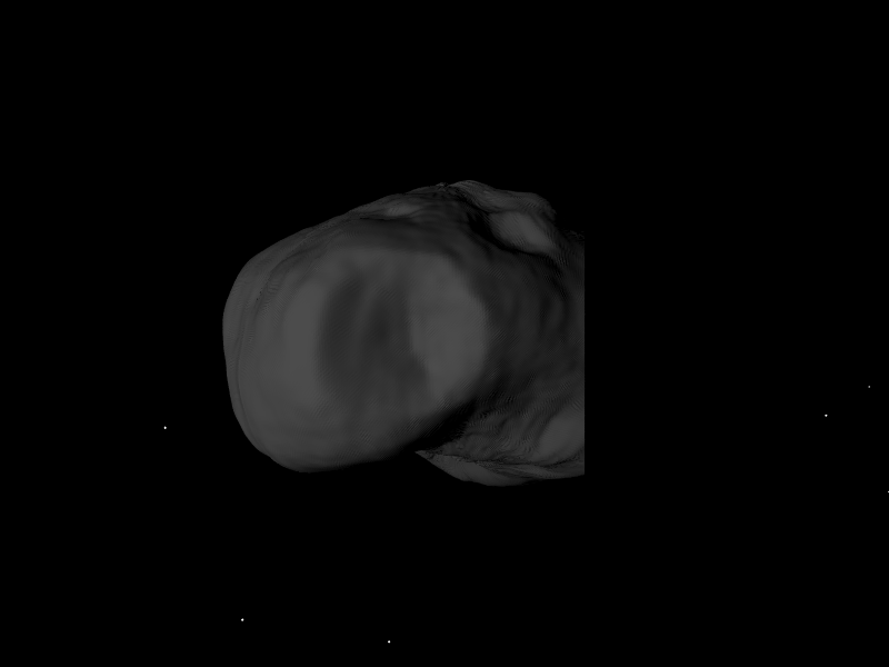

Meanwhile, I improved the 8bit grayscale "heightfields" of Deimos and
Phobos by using HLA to convert them into POV-Ray 16bit images and
blurred them slightly to get rid of the "greebled" look... then I
rendered both moons again and noticed portions being vertically cut off
(see attachments)! It can hardly be a matter of not enough RAM, as I
just recently installed another 1 GB, so that I now have 1536 MB (and
according to POV-Ray, the maximum memory used is about 650 MB)...
See you in Khyberspace!
Yadgar

From the 'straight line' appearance of the cutoff, it looks so much like a
bounding-box problem; but your asteroid code has no explicit bounding box, so
that's a mystery. Have you tried rotating the asteroid to see if that straight
line is actually a flat 'plane' (or else a big hole?) The other possibility
that comes to mind is this: Since you reworked the image map, could the problem
again be related to the needed fix that Clipka mentioned in your previous post?
Is eval() 'seeing' the entire image map?
KW

Where is the moon, and how big is it, in POV-Ray co-ordinates?
like a
box, so
 > that's a mystery.
Perhaps I should look up the manual sections on bounding...
 > line is actually a flat 'plane' (or else a big hole?).
Yes, I have... it seems to be a hole rather than a plane!
the problem
previous post?
No, I did not touch the code since!
Yes, it does, as the image_map extends from <0, 0, 0> to <1, 1, 0>,
eval_pigment() goes from
<(0.5+0)*(1/800), (0.5+0)*(1/400), 0> to <(0.5+799)*(1/800),
(0.5+399)*(1/400), 0>!
Yadgar

Can you make a shot of the hole from more sideways?
If you rotate the camera, does the shape of the hole change?
If you rotate the asteroid, does the shape of the hole change?
If you move the asteroid slightly (by, say, 1/10 of its total dimensions), does

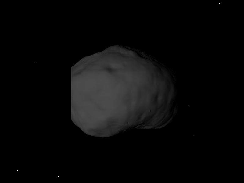

Originally, my Phobos has radii of about 13.4 x 11.2 x 9.2 POV units, as
the sun sits at the origin, Phobos' orbit together with Mars is about
227900000 POV units wide. Knowing that most objects at such distances
won't render correct, I introduced a scaling divisor and set it to 13347
- probably this is too high for small objects like asteroids and
irregular moons. I decreased it to 13 (!) - and then, the clipping
disappeared!
Yadgar
> disappeared!
You have a bounding box problem. And your divisor won't solve it.
For memory efficiency, POV-Ray uses single-precision floating point numbers for
bounding boxes. Those are precise to about 7 digits.
So at a position 227900000 whatever-units away from the co-ordinate origin,
bounding boxes have a "resolution" of 100 whatever-units. Dividing all
dimensions will not help you: It's the relative size that kills here. You may
find divisors that *happen* to be ok for where the moon sits right now, but
things will go awry again as soon as you move the moon around.
What you really need to do is turn off bounding boxes altogehter. It's not as
bad as it sounds: You probably just have spheres and meshes. As long as you
generate the meshes near the origin, their internal bounding mechanism will
kick in, and do a good job on it. And those few spheres are quickly checked for
intersections - or you may want to manually bound them, maybe together with
their moons.
Or, even better yet:
Instead of centering your universe on the sun, center it to the camera. And make
sure you use as few "moves" for your moons as possible: I'm not sure ATM how
bounding boxes react to being translated to millions of POV-Units away, only to
be pushed back again shortly after; I guess they're just modified, not re-built
from scratch.
To this end, you may need to set up your transformations first (using the
transform{} statement) - "stacking" all the translations and rotations into a
single transform{} variable per moon, and then apply them in one go.

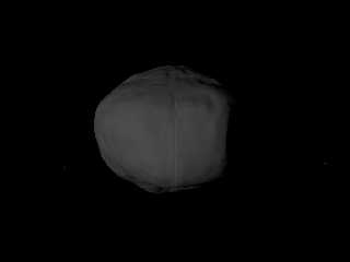

That was pretty easy, just -MB in the command line... here we go!
Yadgar
