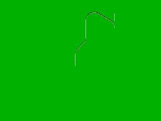

Another raytracing and video editing weekend with my loved one... I
started a medium-sized project dealing with an automatic commuter maglev
train system (to be later on implemented in some futuristic city), first
the rail segments, for which I programmed two macros (see code on p.b.s-f.).
These macros (StraightRail() and BendRail()) are invoked according to
data read in from an ASCII text file (attached here) and stored in a
two-dimensional array. The format of the data is as follows:
1. Segment type (0 for "straight", 1 for "bend")
2. Length (if straight)/Arc angle (if bend)
3. Radius (bend only; third value is not read for straight segments)
This array is processed line by line, and the subsequent rail segments
are translated and rotated to fit together. All worked well - unless I
added a bend segment curving "southward". The following straight segment
was placed out of way, as you can see on the attached image.
It seems to be a problem with the z dimension, as the x value is correct...
See you in Khyberspace!
Yadgar

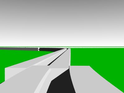

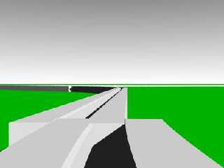

 From 400 metres above, your code looks like a solution... but then I
started animating a camera ride along the rail, and when I came to the
end of the first curved section, I got the result attached here...
I just can't figure out the reason... I tried several values for "diff",
the closest I found was 0.09 (and -0.09 respectively for left bends),
but even then only the end of the right bend roughly fits together with
the second straight section, not the end of the second curved (left
bend) section visible to the left of the image... I'm totally clueless!
Yadgar

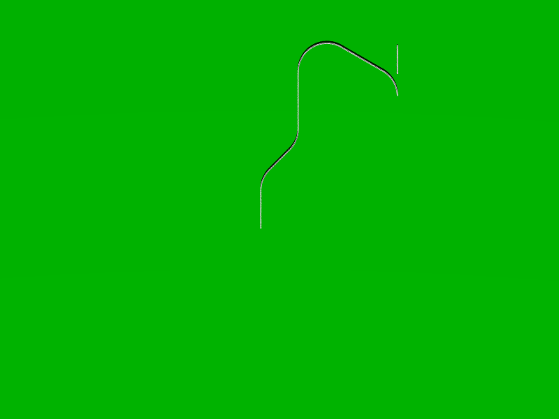

  Ah, so there are another design problem. The StrightRail() object is
not centered , and that's what you're seeign. I propose you to center it:
#macro StraightRail(le) // le: length in meters
     object { StraightOuterRounding }
     object { StraightOuterRounding translate x*0.59 }
     texture { T_Bright_Metal } translate -0.3*x //<---- center it
#end
Then the BendRail don't need to be off-centre:
#macro BendRail(rd, ang)
     object { BendOuterRounding translate y*0.495 }
     object { BendInnerRounding translate y*0.495 }
     texture { T_Bright_Metal } #if(!RevEng)
     #if (ang >= 0)
       translate x*rd //<--------- also centered
     #else
       translate -x*rd
     #end #end
#end
And now there is no need to compute this movement
     #case (1)
       object
         BendRail(RailElements[i][2], RailElements[i][1])
         rotate y*d
         translate trans
         #if (RailElements[i][1] >= 0 )
           #declare diff = 0.3;
         #else
           #declare diff = -0.3;
         #end
        */ //<-- simply eliminate this term from the equations.
     #break
   #end
cheers.

Works great!
Muchas gracias, Martin!
