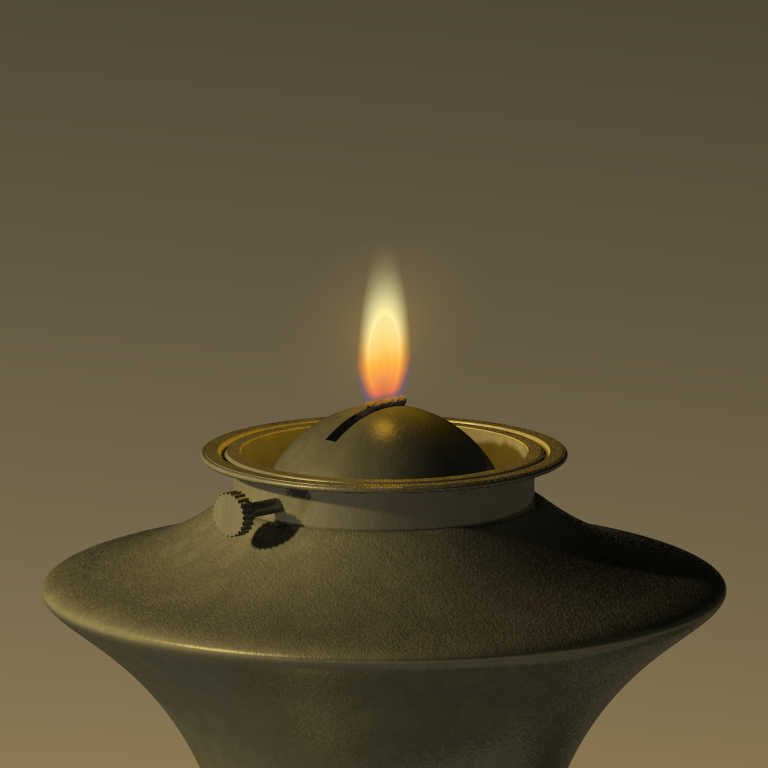

I'm working on this brass lamp as a logo for my project (LAMP server) home
page, and I'm wondering about a problem when I put the glass globe on the
lamp. BTW: I can't take credit for the flame and I don't remember the user
however in the macro the title "Tea Light" was mentioned. Nice macro ....
dropped right into my scene with no problems.
Back to the problem .... the globe is a lathe object and it's very carefully
placed to avoid coincidence surfaces. The glass is lifted from "simple
glass" in the glass includes. The media containers for the flame show up
when ior is anything > 1 ... set at 1 the glass just doesn't look right,
besides that's not correct anyway (for glass).  I've been pretty careful
about making sure textures are radiosity compatible, so I'm fairly sure I've
avoided the "rookie" mistakes, so if anyone has and idea's I'd appreciate
any pointers you'd have to offer.
I'd like to include the globe on the lamp, but it looks pretty decent
without it. The flame looks outstanding! Thanks "Tea Light" artist!!!
Cheers Jim

Looks great!
Add a bit of absorbing (black) media to the flame for yet more realism.

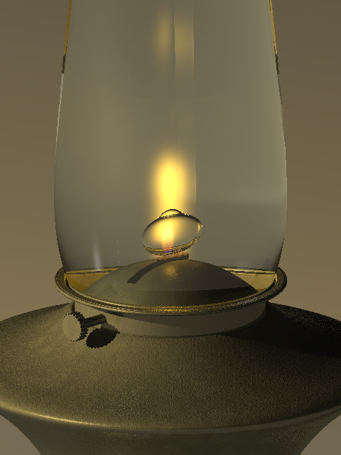

news:web.49cfaf4030aab812ea392f10@news.povray.org...
> Can you post a shot of the issue?
In this image the ior=1.25 ... it shows the artifact clearer, at ior=1.5 the
pattern is repeated multiple times.
The flame macro has three media containers, two near the flame itself
(spheres) and a cylinder going up in y dirirection.

yes, that was one of my first stops in my trouble shooting process ... I
have a conditional that allows me to switch from textures to pigments with
no transparency.
the z axis runs through flame adjust and the sphere containers near the
flame are irregular scaled (thin in x dir)
when I run into problems like these I always turn to the documentation for
ideas and played around with maxtracelevel. I had 20 in globals block ...
tried doubling it several times and the problem got worse. decreased it and
I reproduced the black effect that overlapping media containers causes. one
test I didn't do was without radiosity ... I'm not sure if that's worth the
effort adcbailout maybe??? But I'm not sure if that makes sense either. As I
said before the scene seems mechanically sound (not collisions) .... I'm out
of ideas.

Does your glass have a thickness, or is it solid trough?
Now, there is a magnifier like effect that should NOT be there. Then, the
flame's container apears to have an ior of 1.000.
It's a lathe object, and I rotated it slightly just to make sure I could see
all the way through it. Without a texture it looks like a hollow tube ...
btw: when it's textured hollow on or off appears to make no difference. It
indeed appears to be acting like a solid object.
Just to be clear about it I'm running 3.6.1 on linux ... I'm not on that
machine now but planned on doing some more testing (purely trial and error
at this point) this evening .... perhaps I should post a couple of relevent
code segments to see if anyone can spot what's going on here.
yes that describes what we're seeing perfectly ....  the effect gets more
pronounced as ior is increased.
> Then, the flame's container apears to have an ior of 1.000.
I don't recall (it's someone elses macro) but I'll check
Thanks

Duh - from the looks of it, I'd say your glass globe is *solid*!
Aside from this giving totally unrealistic results anyway, this will result in
the media containers cutting "bubbles" and a chimney into it, which perfectly
explains the effect.
So your objects *do* intersect - not their surfaces, but their volumes.

Just a quick question: How large is the whole smash, in POV dimensions?
Try scaling everything up by a factor of 10 or even 100. I have the impression
that POV rejects the inner wall of your glass globe (there are hints that there
*is* such an inner wall) due to the glass being too thin.
IIRC the limit is 0.001 units (may be 0.0001, need to look at the code).
Surfaces closer than that will give you trouble.
well double duh .... that's what appears to be happening but I've proven
that the globe is a tube. I gave it just a pigment and rotated it so I could
see ALL the way throught it!
I even used just a plain cone object with open and hollow keywords and the
effect is still there.
doesn't open (if applicable) and hollow keywords overcome that problem?
there
then a differenced cone (with some thickness) should overcome that right?
if that's true then perhaps that's what I'm battling (infinite thinness)
haha ... that sounds odd!

Uhm - no.
"Open" basically creates an object with an infinitely thin wall - but such an
object has no interior that an IOR would be applicable to. Or, seen from a
different perspective (and that's also POV's perspective), the interior does
*not* pertain to the wall (which is just an infinitely thin surface), but
