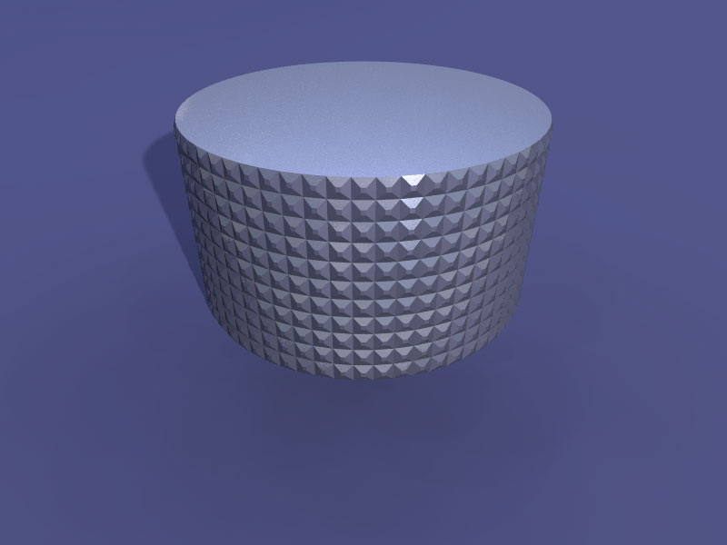

Just finished a macro that will generate a knurled cylinder (since you
can't really knurl anything else, it's a lathe operation...).
Parameters are:
major_radius (radius to the middle of the knurl)
knurl_depth
edge_length (edge being the sides of the square for each point)
cylinder_height
flatten_percent (amount of the point flattened off)
Thanks to clipka for how to CSG with a mesh and have it preserve
interior, I had never seen inside_vector before.
It was inspired by the impressive looking hockey puck by P Brewer, and
since he said it was too hard to figure out the mesh, I took it as a
math challenge. It is mainly a mesh2, fully optimized with no
overlapping vertexes.
If there is any desire, I will clean it up and post an include file in
p.b.sf, else I'll just be happy with my own work.
cshake

From: CShake
Subject: Re: Knurling Macro
Date: 25 Mar 2009 00:31:30
Message: <49c9b3a2$1@news.povray.org>
Ok, I'm just being stupid, it should be diagonal. I'll work on that now.

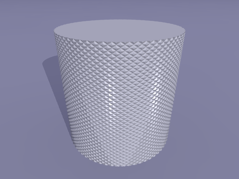

Sorry about the incorrect last one, that was just a square bumps thing,
here's a real knurl.
Once again, the shape of the 'cylinder' itself is defined, then the
spacing of the peaks (this time different for vertical and horizontal,
to allow for non-45degree angles of knurling). Tops of peaks can be
flattened off, and the valleys can be chopped too (though that isn't
possible when doing this on a lathe).
As before, it is an optimized mesh2 with the minimum possible number of
vertexes and triangles, and if anyone wants it I can post the macro.
cshake

From: clipka
Date: 25 Mar 2009 12:55:00
Message: <web.49ca611025cfdcec1f399840@news.povray.org>
How 'bout adding it to the POV object collection?

From: CShake
Date: 26 Mar 2009 00:28:32
Message: <49cb0470$1@news.povray.org>
Done. Have fun.
I followed all the specifications on the help page for standards
compliance, though the file does produce a runtime parse warning (patch
objects not allowed in an intersection) but works as expected with no
artifacts or anything. Tested in MegaPOV 1.2.1 and POV 3.7b31
Beautiful work!  This is a 'keeper' image for me, going into my collection.
I was wondering if you had previously tried the 'quilted' pattern (as turned
into a function, for use with the HF_Cylinder macro in shapes.inc)? That would
seem to be an alternate method to create a knurling effect on a cylinder,
although I haven't tried it myself.
Ken W.
> Ken W.
Actually I hadn't thought of that, I just have a mental association
between functions and normals, so I never thought of using it as a
heightfield. I may look into that at some point, maybe see if there are
performance gains for one implementation over the other.
A cylindrical HF macro will do nothing different from what you did - it actually
creates a mesh, too - except that it cannot optimize, and you may get
"interference pattern" if you choose a too low resolution. So I guess your
custom-tailored knurl mesh should always be faster and of better quality.
Ah yes, you're right about that. And the HF_Cylinder macro can be quite slow at
hi-rez.
