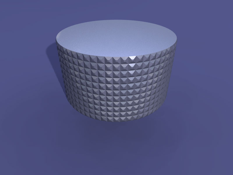

Just finished a macro that will generate a knurled cylinder (since you
can't really knurl anything else, it's a lathe operation...).
Parameters are:
major_radius (radius to the middle of the knurl)
knurl_depth
edge_length (edge being the sides of the square for each point)
cylinder_height
flatten_percent (amount of the point flattened off)
Thanks to clipka for how to CSG with a mesh and have it preserve
interior, I had never seen inside_vector before.
It was inspired by the impressive looking hockey puck by P Brewer, and
since he said it was too hard to figure out the mesh, I took it as a
math challenge. It is mainly a mesh2, fully optimized with no
overlapping vertexes.
If there is any desire, I will clean it up and post an include file in
p.b.sf, else I'll just be happy with my own work.

Ok, I'm just being stupid, it should be diagonal. I'll work on that now.

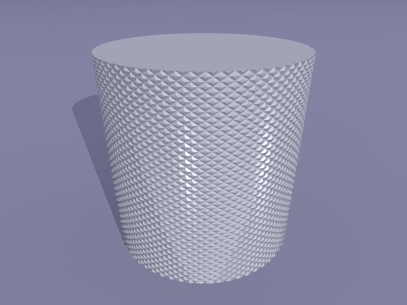

Sorry about the incorrect last one, that was just a square bumps thing,
here's a real knurl.
Once again, the shape of the 'cylinder' itself is defined, then the
spacing of the peaks (this time different for vertical and horizontal,
to allow for non-45degree angles of knurling). Tops of peaks can be
flattened off, and the valleys can be chopped too (though that isn't
possible when doing this on a lathe).
As before, it is an optimized mesh2 with the minimum possible number of
vertexes and triangles, and if anyone wants it I can post the macro.

How 'bout adding it to the POV object collection?

Beautiful... next time we'll have to work together. =)
This would have saved me quite a lot of frustration and time.

Done. Have fun.
I followed all the specifications on the help page for standards
compliance, though the file does produce a runtime parse warning (patch
objects not allowed in an intersection) but works as expected with no
artifacts or anything. Tested in MegaPOV 1.2.1 and POV 3.7b31

Beautiful work!  This is a 'keeper' image for me, going into my collection.
I was wondering if you had previously tried the 'quilted' pattern (as turned
into a function, for use with the HF_Cylinder macro in shapes.inc)? That would
seem to be an alternate method to create a knurling effect on a cylinder,
although I haven't tried it myself.

Actually I hadn't thought of that, I just have a mental association
between functions and normals, so I never thought of using it as a
heightfield. I may look into that at some point, maybe see if there are
performance gains for one implementation over the other.

A cylindrical HF macro will do nothing different from what you did - it actually
creates a mesh, too - except that it cannot optimize, and you may get
"interference pattern" if you choose a too low resolution. So I guess your
custom-tailored knurl mesh should always be faster and of better quality.

Ah yes, you're right about that. And the HF_Cylinder macro can be quite slow at
hi-rez.
