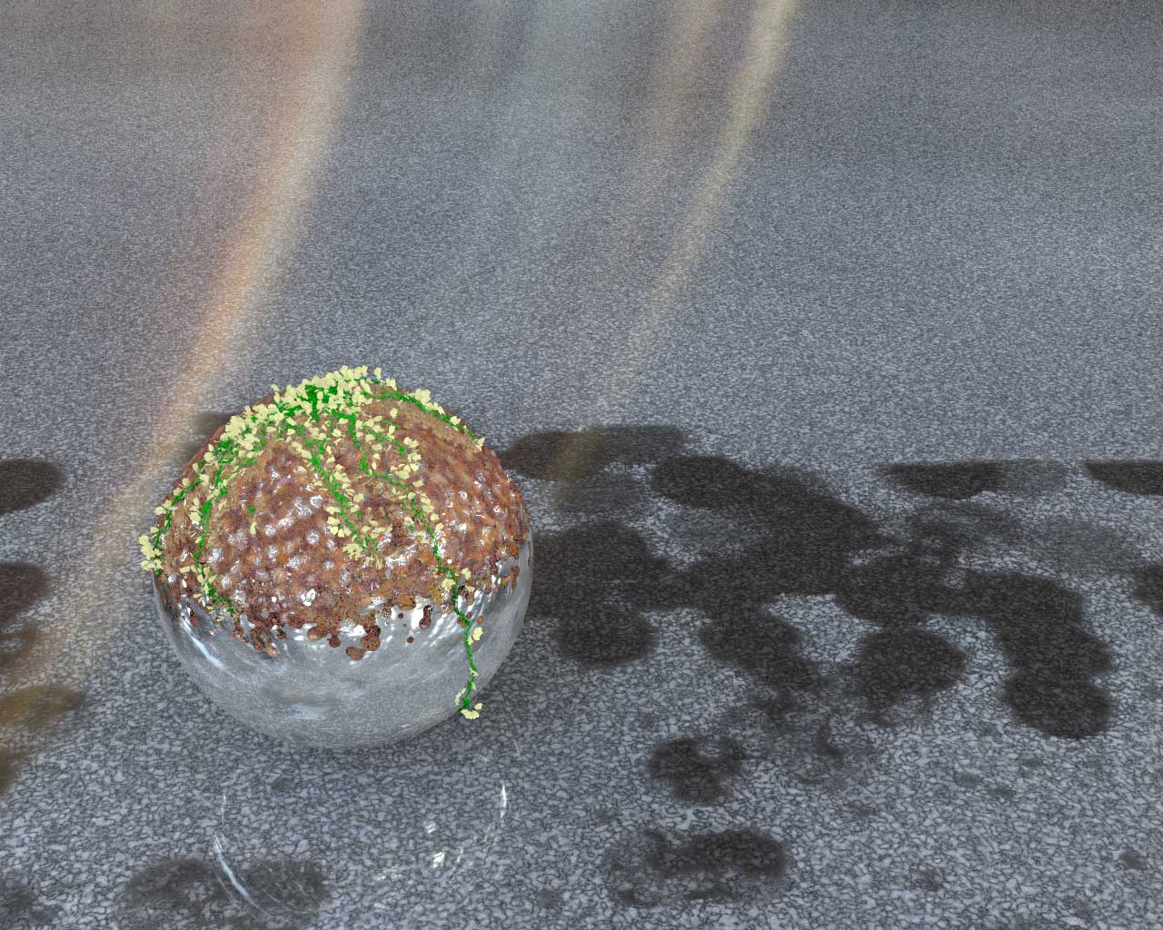

1) I messed up scaling the water iso, so the waves are too wide to see.
2) I used a crappy HDR probe image.
3) I used the vine macro and the corrosion macro, just to see if they play
nice. They do.
This image uses radiosity, but I doubt it caused the odd blotches.
Anyone have any ideas about what these are? Once I can figure it out, I'll
rerender...as it took 13hr..
ian

From: Bill Pragnell
Subject: Re: Ooops. Odd blotches.
Date: 13 Mar 2009 05:15:00
Message: <web.49ba240d644b8e0a6dd25f0b0@news.povray.org>
They look like radiosity artifacts to me. Try raising the count. Also, make sure
recursion_limit is high enough that radiosity rays are making it through the
water surface!
Bill
From: [GDS|Entropy]
Date: 13 Mar 2009 08:19:42
Message: <49ba4f5e$1@news.povray.org>
"Bill Pragnell" <bil### [at] hotmailcom> wrote in message
news:web.49ba240d644b8e0a6dd25f0b0@news.povray.org...
>> I'll
> make sure
> the
> water surface!
> Bill
Turns out that it was MTL... O_o'
I fixed my isosurface. And I found a bug in my macros.
Apparently, something does not like it when your trace test vector is
different between calls to the various macros. WTF? I thought that I had
written them so that it didn't matter. Guess I was wrong.
Once this next render is done I will post its source, as I am not seeing the
problem.
My next version will probably include the glacier iso and snow macros, so I
can have spring on the lower left and winter on the upper right, just to get
some thematic asymmetric balance in there.
ian
From: Trevor G Quayle
Date: 13 Mar 2009 13:05:01
Message: <web.49ba9221644b8e0a81c811d20@news.povray.org>
> nice. They do.
> ian
It looks like they may possibly be bird droppings.
Actually they do look like radiosity artifacts.
-tgq
From: clipka
Date: 14 Mar 2009 12:35:00
Message: <web.49bbdbc3644b8e0a4c2c4c080@news.povray.org>
Looks weird (even without the blotches). Like it!
I *guarantee* you it did, beyond any doubt.
The blotches also tell me that you're using a version of POV prior to
3.7.0.beta.29-rad1 (or a derivative; given that you mention HDR, I reckon it's
MegaPOV 1.2.1)
Your scene's setting is the role model for the infamous POV 3.6 (and earlier)
"black splotchy artifacts" radiosity bug: An abundance of reflective stuff with
an abundance of interreflection. With this setting, you're almost *inevitably*
to contract the "black pox".
There's just one thing to rule them all, find them, bring them all, and in the
brightness bind them: Crank up max_trace_level a really good deal. All other
resistance is futile.
(Or use the current POV 3.7 beta of course.)
From: clipka
Date: 14 Mar 2009 12:50:01
Message: <web.49bbdfbd644b8e0a4c2c4c080@news.povray.org>
> water surface!
recursion_limit is not the screw to tweak here. That parameter is somewhat akin
to the max_trace_level, but rather than limiting the number of *total* bounces
calculated, it just limits the number of *diffuse* bounces. There may be an
arbitrary number of reflection/refraction bounces in between - radiosity
doesn't care (unless the general max_trace_level restriction kicks in).
I never tested it, but thinking about it, my first guess would be that raising
recursion_limit would actually make the splotches worse in number (albeit
possibly weaker).
From: Paolo Gibellini
Date: 18 Mar 2009 09:07:03
Message: <49c0f1f7$1@news.povray.org>
Mmm...
Apart of artifacts, with some texture correction you could realize a
spherical pizza!
Paolo
