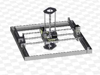

As well as pretty pictures, POVRay is very useful as a 3D design tool.
I've been designing a CNC router for the last few weeks and being able
to render it from any angle has helped me get over many design
difficulties.

As always when designing such machinery, 'success lies in the details'--the
proper bearings, the elimination of mechanical backlash, etc.  I'm curious as
to what type of threaded drive shafts you plan on using?
Something to be aware of (and this is from my own personal experience) is that
using *multiple* threaded shafts to drive a single axis can create problems and
headaches in trying to get things to work reliably (not insurmountable ones, of
course)-- the shafts need to be as parallel as is humanly possible--in two
axes--so the moving platform doesn't 'lock up' at some point. Perhaps you've
taken that into account already.
Good luck with the design; it looks very promising. (Someday I want to build one
of these things myself.)
Ken W.

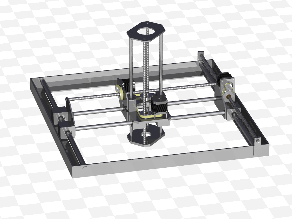

From: Rarius
Subject: Re: My CNC router design
Date: 8 Mar 2009 06:14:12
Message: <49b39a74@news.povray.org>
Here is a plain text post with a updated image of my CNC design.
Rarius
> details'--the
> as
The drive spindles are 12mm trapezoidal with a 3mm pitch
(http://www.worldofcnc.com/products.asp?recnumber=61) running in bronze nuts
(http://www.worldofcnc.com/products.asp?recnumber=47). The rails are 12mm,
16mm and 20mm ground shafts
(http://www.worldofcnc.com/products.asp?recnumber=14) running through linear
bearings (http://www.worldofcnc.com/products.asp?recnumber=16).
I bought a job lot from eBay. It included four spindles, three pairs of
> that
> problems and
> ones, of
> you've
You make a good point. Originally I was going to drive the two Z axis
spindles with two stepper motors. By tying the two Z axis drives together
with the toothed drive belt I don't beleive that I should have any problems
such as you describe.
I have changed the system from driving the spindles so that the spindles are
now locked in position and the nuts are rotated around them, thus pulling
themselves along the spindle. This should remove any problems from the
spindles wobbling as they turn and also removes the need for bearings at
both ends!
I think the problem of "racking" on the X axis is more of a worry. Although
not shown on the image I have decided to add a cable system like that used
on large draftsmans drawing boards to stop any rotational movement as the
carriage moves backwards and forwards along the X axis.
Rarius
